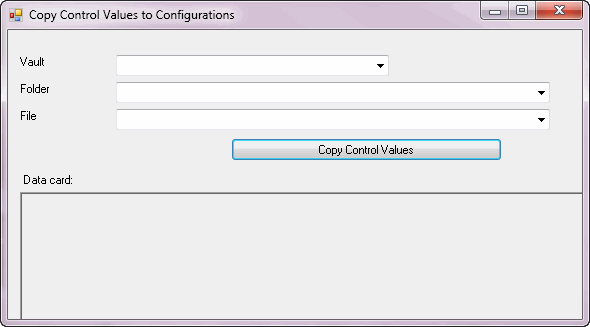

' 4. Check out a file that has a data card with two or more configurations.
' 5. Modify a control variable in the @ configuration.
' 6. Click Debug > Start Debugging or press F5.
' Postconditions:
' 1. Displays the Copy Control Values to Configurations dialog box.
'    a. Select a vault view.
'       Folder is set to the root folder.
'    b. Select a file that has a data card with two or more configurations.
'    c. Displays the data card.
'    d. Click Copy Control Values.
'       Copies the value set in Preconditions step 5 to all configurations.
' 2. Close the dialog box.
' 3. Inspect the control values in all of the configurations of the data card.

Private Sub DoBtn_Click(ByVal sender As ObjectByVal e As EventArgsHandles DoBtn.Click
Dim i As Integer = FoldersComboBox.SelectedIndex
Dim edmFolder As IEdmFolder5 = oFoldersArray(i)
i = FilesComboBox.SelectedIndex
Dim edmFile As IEdmFile14 = DirectCast(oFileArray(i), IEdmFile14)
Dim cfgList As New List(Of String)()
Dim configLst As EdmStrLst5 = edmFile.GetConfigurations()
Dim cfgPos As IEdmPos5 = configLst.GetHeadPosition()
Do While Not cfgPos.IsNull
Dim configName As String = configLst.GetNext(cfgPos)
cfgList.Add(configName)
Loop
For Each configName As String In cfgList
' Move variable values from "@" to configName
edmFile.GenerateDefaultConfigValues(edmFile.ID"@", configName, ""False)
Next configName
ShowDataCard()
End Sub

Me.ClientSize = New System.Drawing.Size(913, 670)
Me.Controls.Add(Me.label4)
Me.Controls.Add(Me.label3)
Me.Controls.Add(Me.label2)
Me.Controls.Add(Me.label1)
Me.Controls.Add(Me.FilesComboBox)
Me.Controls.Add(Me.FoldersComboBox)
Me.Controls.Add(Me.VaultsComboBox)
Me.Controls.Add(Me.CardPanel)
Me.Controls.Add(Me.DoBtn)
Me.Name = "MainForm"
Me.Text = "Copy Control Values to Configurations"
Me.ResumeLayout(False)
Me.PerformLayout()
End Sub
#End Region
Private WithEvents DoBtn As System.Windows.Forms.Button
Private CardPanel As System.Windows.Forms.Panel
Private WithEvents VaultsComboBox As System.Windows.Forms.ComboBox
Private WithEvents FoldersComboBox As System.Windows.Forms.ComboBox
Private WithEvents FilesComboBox As System.Windows.Forms.ComboBox
Private label1 As System.Windows.Forms.Label
Private label2 As System.Windows.Forms.Label
Private label3 As System.Windows.Forms.Label
Private label4 As System.Windows.Forms.Label
End Class
