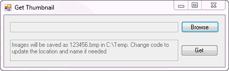

// 1. In the Get Thumbnail dialog, click Browse.
// 2. Navigate to a vault that contains a model with a thumbnail. Click Open.
// 3. In the Get Thumbnail dialog, click Get.
// 4. c:\temp\123456.bmp is the thumbnail of the model.

        //Create form
        public Form1()
            InitializeComponent();
        //Load form
        private void Form1_Load(System.Object sender, System.EventArgs e)
            textBox1.Text = "Images will be saved as 123456.bmp in C:\\Temp. \nChange code to update the location and name if needed.";
            textBox1.Enabled = false;

            this.btnBrowse = new System.Windows.Forms.Button();
            this.filePath = new System.Windows.Forms.TextBox();
            this.btnTest = new System.Windows.Forms.Button();
            this.textBox1 = new System.Windows.Forms.TextBox();
            this.SuspendLayout();
            // btnBrowse
            this.btnBrowse.Location = new System.Drawing.Point(352, 12);
            this.btnBrowse.Name = "btnBrowse";
            this.btnBrowse.Size = new System.Drawing.Size(75, 23);
            this.btnBrowse.TabIndex = 0;
            this.btnBrowse.Text = "Browse";
            this.btnBrowse.UseVisualStyleBackColor = true;
            this.btnBrowse.Click += new System.EventHandler(this.btnBrowse_Click);
            // filePath
            this.filePath.Enabled = false;
            this.filePath.Location = new System.Drawing.Point(12, 14);
            this.filePath.Name = "filePath";
            this.filePath.Size = new System.Drawing.Size(334, 20);
            this.filePath.TabIndex = 1;
            // btnTest
            this.btnTest.Location = new System.Drawing.Point(352, 59);
            this.btnTest.Name = "btnTest";
            this.btnTest.Size = new System.Drawing.Size(73, 22);
            this.btnTest.TabIndex = 2;
            this.btnTest.Text = "Get thumbnail";
            this.btnTest.UseVisualStyleBackColor = true;
            this.btnTest.Click += new System.EventHandler(this.btnGet_Click);
            // textBox1
            this.textBox1.Enabled = false;
            this.textBox1.Location = new System.Drawing.Point(12, 49);
            this.textBox1.Multiline = true;
            this.textBox1.Name = "textBox1";
            this.textBox1.Size = new System.Drawing.Size(334, 42);
            this.textBox1.TabIndex = 3;
            // Form1
            this.AutoScaleDimensions = new System.Drawing.SizeF(6F, 13F);
            this.AutoScaleMode = System.Windows.Forms.AutoScaleMode.Font;
            this.ClientSize = new System.Drawing.Size(439, 103);
            this.Controls.Add(this.textBox1);
            this.Controls.Add(this.btnTest);
            this.Controls.Add(this.filePath);
            this.Controls.Add(this.btnBrowse);
            this.Name = "Form1";
            this.Text = "Get Thumbnail";
            this.Load += new System.EventHandler(this.Form1_Load);
            this.ResumeLayout(false);
            this.PerformLayout();
