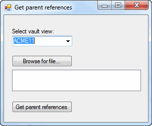

Get Parent References of File Example (VB.NET)
This example shows how to find the parent references of a
file.
NOTE: If using the .NET Framework 4.0 primary interop assembly
provided with SOLIDWORKS PDM Professional, see
Using .NET Framework 4.0 in
Stand-alone Applications.
' Preconditions:
' 1. Start Microsoft Visual Studio 2010.
' a. Click File > New > Project > Visual Basic > Windows Forms Application.
' b. Type GetParentReferences in Name.
' c. Click Browse and navigate to the folder where to create
' the project.
' d. Click OK.
' e. Click Show All Files in the Solution Explorer toolbar and expand
' Form1.vb in the Solution Explorer.
' f. Replace the code in Form1.vb with this code.
' g. To create the form,
replace the code in Form1.Designer.vb with this code.
' 2. Add EPDM.Interop.epdm.dll as a reference (right-click the project
' name in the Solution Explorer, click Add Reference, click
' Assemblies > Framework in the left-side panel, browse to the top folder of
' your SOLIDWORKS PDM Professional installation, locate and click
' EPDM.Interop.epdm.dll, click Open, click Add, and click Close).
' 3. Right-click EPDM.Interop.epdm in References, click Properties, and set
' Embed Interop Types to False to handle methods that pass arrays of
' structures.
' 4. Ensure that an assembly and its parts are checked into a vault.
' 5. Click Debug > Start Debugging or press F5.
' Postconditions:
' 1. The Get parent references dialog displays.
' 2. Select a vault view.
' 3. Click Browse for file.
' 4. Locate and click one of the parts mentioned in Preconditions step 4.
' 5. Click Open.
' 6. Click Get parent references.
' 7. Displays the references of the
selected part.
' 8. Click OK.
' 9. Close the Get parent references dialog.

'Form1.Designer.vb
<Global.Microsoft.VisualBasic.CompilerServices.DesignerGenerated()> _
Partial Class Form1
Inherits System.Windows.Forms.Form
''' <summary>
''' Required designer variable.
''' </summary>
Private components As System.ComponentModel.IContainer = Nothing
''' <summary>
''' Clean up any resources being used.
''' </summary>
''' <param name="disposing">true if managed resources should be disposed; otherwise, false.</param>
Protected Overrides Sub Dispose(ByVal disposing As Boolean)
If disposing AndAlso (components IsNot Nothing) Then
components.Dispose()
End If
MyBase.Dispose(disposing)
End Sub
#Region "Windows Form Designer generated code"
''' <summary>
''' Required method for Designer support - do not modify
''' the contents of this method with the code editor.
''' </summary>
Private Sub InitializeComponent()
Me.VaultsLabel = New System.Windows.Forms.Label()
Me.VaultsComboBox = New System.Windows.Forms.ComboBox()
Me.BrowseButton = New System.Windows.Forms.Button()
Me.Listbox = New System.Windows.Forms.ListBox()
Me.GetParentReferences = New System.Windows.Forms.Button()
Me.OpenFileDialog = New System.Windows.Forms.OpenFileDialog()
Me.SuspendLayout()
'VaultsLabel
Me.VaultsLabel.AutoSize = True
Me.VaultsLabel.Location = New System.Drawing.Point(13, 26)
Me.VaultsLabel.Name = "VaultsLabel"
Me.VaultsLabel.Size = New System.Drawing.Size(91, 13)
Me.VaultsLabel.TabIndex = 0
Me.VaultsLabel.Text = "Select vault view:"
'VaultsComboBox
Me.VaultsComboBox.FormattingEnabled = True
Me.VaultsComboBox.Location = New System.Drawing.Point(16, 42)
Me.VaultsComboBox.Name = "VaultsComboBox"
Me.VaultsComboBox.Size = New System.Drawing.Size(121, 21)
Me.VaultsComboBox.TabIndex = 1
'BrowseButton
Me.BrowseButton.Location = New System.Drawing.Point(16, 81)
Me.BrowseButton.Name = "BrowseButton"
Me.BrowseButton.Size = New System.Drawing.Size(121, 23)
Me.BrowseButton.TabIndex = 3
Me.BrowseButton.Text = "Browse for file..."
Me.BrowseButton.UseVisualStyleBackColor = True
'Listbox
Me.Listbox.FormattingEnabled = True
Me.Listbox.HorizontalScrollbar = True
Me.Listbox.Location = New System.Drawing.Point(16, 110)
Me.Listbox.Name = "Listbox"
Me.Listbox.Size = New System.Drawing.Size(259, 43)
Me.Listbox.TabIndex = 4
'GetParentReferences
Me.GetParentReferences.Location = New System.Drawing.Point(16, 173)
Me.GetParentReferences.Name = "GetParentReferences"
Me.GetParentReferences.Size = New System.Drawing.Size(121, 23)
Me.GetParentReferences.TabIndex = 5
Me.GetParentReferences.Text = "Get parent references"
Me.GetParentReferences.UseVisualStyleBackColor = True
'Form1
Me.AutoScaleDimensions = New System.Drawing.SizeF(6.0!, 13.0!)
Me.AutoScaleMode = System.Windows.Forms.AutoScaleMode.Font
Me.ClientSize = New System.Drawing.Size(289, 215)
Me.Controls.Add(Me.GetParentReferences)
Me.Controls.Add(Me.Listbox)
Me.Controls.Add(Me.BrowseButton)
Me.Controls.Add(Me.VaultsComboBox)
Me.Controls.Add(Me.VaultsLabel)
Me.Name = "Form1"
Me.Text = "Get parent references"
Me.ResumeLayout(False)
Me.PerformLayout()
End Sub
#End Region
Friend WithEvents VaultsLabel As System.Windows.Forms.Label
Friend WithEvents VaultsComboBox As System.Windows.Forms.ComboBox
Friend WithEvents BrowseButton As System.Windows.Forms.Button
Friend WithEvents Listbox As System.Windows.Forms.ListBox
Friend WithEvents GetParentReferences As System.Windows.Forms.Button
Friend WithEvents OpenFileDialog As System.Windows.Forms.OpenFileDialog
End Class
Back to top
