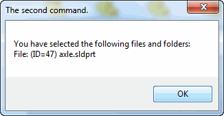

                    EdmVault5 v = default(EdmVault5);
                    v = (EdmVault5)poCmd.mpoVault;
                    v.MsgBox(poCmd.mlParentWnd, message, EdmMBoxType.EdmMbt_OKOnly, CommandName);

  23. Right-click a file in the vault view and click Second command. The add-in displays a dialog similar to the following:
