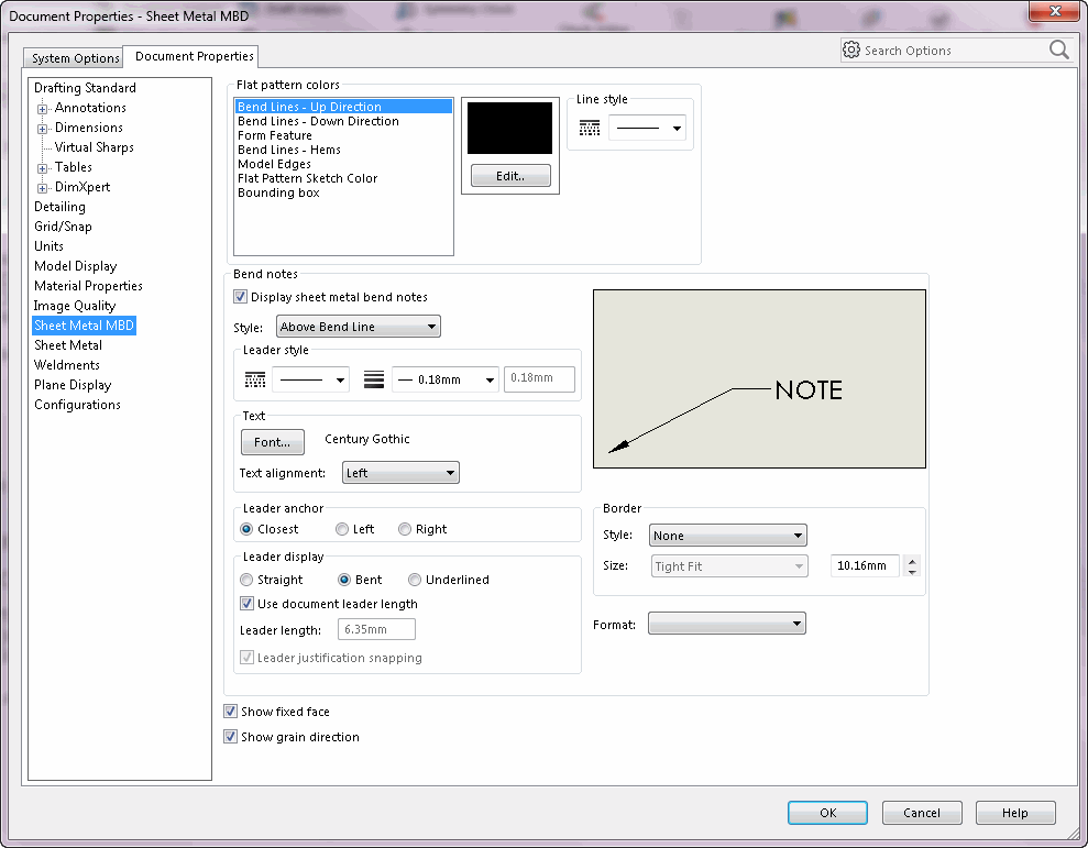

Document Properties > Sheet Metal MBD
Setting
Get/Set Methods
Return Value or <Value>
Comments
Flat pattern colors - Bend Lines - Up Direction
IModelDocExtension::GetUserPreferenceInteger(swUserPreferenceIntegerValue_e.swFlatPatternColorsBendLinesUpDirection, swUserPreferenceOption_e.swDetailingNoOptionSpecified)
IModelDocExtension::SetUserPreferenceInteger(swUserPreferenceIntegerValue_e.swFlatPatternColorsBendLinesUpDirection, swUserPreferenceOption_e.swDetailingNoOptionSpecified, <Value>)
Integer RGB value
Flat pattern colors - Bend Lines - Up Direction - Line style
IModelDocExtension::GetUserPreferenceInteger(swUserPreferenceIntegerValue_e.swSheetMetalMBDLineStyle_BendLinesUp, swUserPreferenceOption_e.swDetailingNoOptionSpecified)
IModelDocExtension::SetUserPreferenceInteger(swUserPreferenceIntegerValue_e.swSheetMetalMBDLineStyle_BendLinesUp, swUserPreferenceOption_e.swDetailingNoOptionSpecified, swLineStyles_e.<Value>)
Any line style as defined in swLineStyles_e except swLineDEFAULT
Flat pattern colors - Bend Lines - Down Direction
IModelDocExtension::GetUserPreferenceInteger(swUserPreferenceIntegerValue_e.swFlatPatternColorsBendLinesDownDirection, swUserPreferenceOption_e.swDetailingNoOptionSpecified)
IModelDocExtension::SetUserPreferenceInteger(swUserPreferenceIntegerValue_e.swFlatPatternColorsBendLinesDownDirection, swUserPreferenceOption_e.swDetailingNoOptionSpecified, <Value>)
Integer RGB value
Flat pattern colors - Bend Lines - Down Direction - Line style
IModelDocExtension::GetUserPreferenceInteger(swUserPreferenceIntegerValue_e.swSheetMetalMBDLineStyle_BendLinesDown, swUserPreferenceOption_e.swDetailingNoOptionSpecified)
IModelDocExtension::SetUserPreferenceInteger(swUserPreferenceIntegerValue_e.swSheetMetalMBDLineStyle_BendLinesDown, swUserPreferenceOption_e.swDetailingNoOptionSpecified, swLineStyles_e.<Value>)
Flat pattern colors - Form Feature
IModelDocExtension::GetUserPreferenceInteger(swUserPreferenceIntegerValue_e.swFlatPatternColorsFromFeature, swUserPreferenceOption_e.swDetailingNoOptionSpecified)
IModelDocExtension::SetUserPreferenceInteger(swUserPreferenceIntegerValue_e.swFlatPatternColorsFromFeature, swUserPreferenceOption_e.swDetailingNoOptionSpecified, <Value>)
Integer RGB value
Flat pattern colors - Bend Lines - Hems
IModelDocExtension::GetUserPreferenceInteger(swUserPreferenceIntegerValue_e.swSheetMetalColorBendLinesHems, swUserPreferenceOption_e.swDetailingNoOptionSpecified)
IModelDocExtension::SetUserPreferenceInteger(swUserPreferenceIntegerValue_e.swSheetMetalColorBendLinesHems, swUserPreferenceOption_e.swDetailingNoOptionSpecified, <Value>)
Integer RGB value
Flat pattern colors - Model Edges
IModelDocExtension::GetUserPreferenceInteger(swUserPreferenceIntegerValue_e.swFlatPatternColorsModelEdges, swUserPreferenceOption_e.swDetailingNoOptionSpecified)
IModelDocExtension::SetUserPreferenceInteger(swUserPreferenceIntegerValue_e.swFlatPatternColorsModelEdges, swUserPreferenceOption_e.swDetailingNoOptionSpecified, <Value>)
Integer RGB value
Flat pattern colors - Flat Pattern Sketch Color
IModelDocExtension::GetUserPreferenceInteger(swUserPreferenceIntegerValue_e.swFlatPatternColorsFlatPatternSketchColor, swUserPreferenceOption_e.swDetailingNoOptionSpecified)
IModelDocExtension::SetUserPreferenceInteger(swUserPreferenceIntegerValue_e.swFlatPatternColorsFlatPatternSketchColor, swUserPreferenceOption_e.swDetailingNoOptionSpecified, <Value>)
Integer RGB value
Flat pattern colors - Bounding box
IModelDocExtension::GetUserPreferenceInteger(swUserPreferenceIntegerValue_e.swFlatPatternColorsBoundingBox, swUserPreferenceOption_e.swDetailingNoOptionSpecified)
IModelDocExtension::SetUserPreferenceInteger(swUserPreferenceIntegerValue_e.swFlatPatternColorsBoundingBox, swUserPreferenceOption_e.swDetailingNoOptionSpecified, <Value>)
Integer RGB value
Bend notes - Display sheet metal bend notes
IModelDocExtension::GetUserPreferenceToggle(swUserPreferenceToggle_e.swSheetMetalMBDDisplaySheetMetalBendNotes, swUserPreferenceOption_e.swDetailingNoOptionSpecified)
IModelDocExtension::SetUserPreferenceToggle(swUserPreferenceToggle_e.swSheetMetalMBDDisplaySheetMetalBendNotes, swUserPreferenceOption_e.swDetailingNoOptionSpecified, <Value>)
Boolean value
Bend notes - Style
IModelDocExtension::GetUserPreferenceInteger(swUserPreferenceIntegerValue_e.swSheetMetalMBDBendNotesStyle, swUserPreferenceOption_e.swDetailingNoOptionSpecified)
IModelDocExtension::SetUserPreferenceInteger(swUserPreferenceIntegerValue_e.swSheetMetalMBDBendNotesStyle, swUserPreferenceOption_e.swDetailingNoOptionSpecified, swSheetMetalMBDBendNotesStyle_e.<Value>)
See swSheetMetalMBDBendNotesStyle_e for valid options
Bend notes - Leader style - Leader style
IModelDocExtension::GetUserPreferenceInteger(swUserPreferenceIntegerValue_e.swSheetMetalMBDLeaderStyle, swUserPreferenceOption_e.swDetailingNoOptionSpecified)
IModelDocExtension::SetUserPreferenceInteger(swUserPreferenceIntegerValue_e.swSheetMetalMBDLeaderStyle, swUserPreferenceOption_e.swDetailingNoOptionSpecified, swLineStyles_e.<Value>)
See swLineStyles_e for valid options
Bend notes - Leader style - Leader thickness
IModelDocExtension::GetUserPreferenceInteger(swUserPreferenceIntegerValue_e.swSheetMetalMBDLeaderLineThickness, swUserPreferenceOption_e.swDetailingNoOptionSpecified)
IModelDocExtension::SetUserPreferenceInteger(swUserPreferenceIntegerValue_e.swSheetMetalMBDLeaderLineThickness, swUserPreferenceOption_e.swDetailingNoOptionSpecified, swLineWeights_e.<Value>)
See swLineWeights_e for valid options
If set to swLW_CUSTOM, you must also set Leader style - Leader thickness - Custom Thickness
Bend notes - Leader style - Leader thickness - Custom Thickness
IModelDocExtension::GetUserPreferenceDouble(swUserPreferenceDoubleValue_e.swSheetMetalMBDLeaderLineThicknessCustom, swUserPreferenceOption_e.swDetailingNoOptionSpecified)
IModelDocExtension::SetUserPreferenceDouble(swUserPreferenceDoubleValue_e.swSheetMetalMBDLeaderLineThicknessCustom, swUserPreferenceOption_e.swDetailingNoOptionSpecified, <Value>)
0.00018 <= Double value in meters <= 0.004
Valid only if Leader thickness is set to swLineWeights_e.swLW_CUSTOM
Bend notes - Text - Font...
IModelDocExtension::GetUserPreferenceTextFormat(swUserPreferenceTextFormat_e.swSheetMetalMBDTextFormat, swUserPreferenceOption_e.swDetailingNoOptionSpecified)
IModelDocExtension::SetUserPreferenceTextFormat(swUserPreferenceTextFormat_e.swSheetMetalMBDTextFormat, swUserPreferenceOption_e.swDetailingNoOptionSpecified, <Value>)
See ITextFormat for font options
To set font property values, implement ITextFormat, set the appropriate ITextFormat member values, and pass the ITextFormat object in this API's set method
Bend notes - Text - Text alignment
IModelDocExtension::GetUserPreferenceInteger(swUserPreferenceIntegerValue_e.swSheetMetalMBDTextAlignment, swUserPreferenceOption_e.swDetailingNoOptionSpecified)
IModelDocExtension::SetUserPreferenceInteger(swUserPreferenceIntegerValue_e.swSheetMetalMBDTextAlignment, swUserPreferenceOption_e.swDetailingNoOptionSpecified, swTextJustification_e.<Value>)
See swTextJustification_e for valid options; None is not a valid option
Bend notes - Leader anchor
IModelDocExtension::GetUserPreferenceInteger(swUserPreferenceIntegerValue_e.swSheetMetalMBDLeaderAnchor, swUserPreferenceOption_e.swDetailingNoOptionSpecified)
IModelDocExtension::SetUserPreferenceInteger(swUserPreferenceIntegerValue_e.swSheetMetalMBDLeaderAnchor, swUserPreferenceOption_e.swDetailingNoOptionSpecified, swLeaderSide_e.<Value>)
See swLeaderSide_e for valid options
Bend notes - Leader display
IModelDocExtension::GetUserPreferenceInteger(swUserPreferenceIntegerValue_e.swSheetMetalMBDLeaderDisplay, swUserPreferenceOption_e.swDetailingNoOptionSpecified)
IModelDocExtension::SetUserPreferenceInteger(swUserPreferenceIntegerValue_e.swSheetMetalMBDLeaderDisplay, swUserPreferenceOption_e.swDetailingNoOptionSpecified, swLeaderStyle_e.<Value>)
See swLeaderStyle_e for valid options
Bend notes - Leader display - Use document leader length
IModelDocExtension::GetUserPreferenceToggle(swUserPreferenceToggle_e.swSheetMetalMBDUseDocumentLeaderLength, swUserPreferenceOption_e.swDetailingNoOptionSpecified)
IModelDocExtension::SetUserPreferenceToggle(swUserPreferenceToggle_e.swSheetMetalMBDUseDocumentLeaderLength, swUserPreferenceOption_e.swDetailingNoOptionSpecified, <Value>)
Boolean value
Valid only if Leader display is set to swLeaderStyle_e.Bent
Bend notes - Leader display - Leader length
IModelDocExtension::GetUserPreferenceDouble(swUserPreferenceDoubleValue_e.swSheetMetalMBDLeaderLength, swUserPreferenceOption_e.swDetailingNoOptionSpecified)
IModelDocExtension::SetUserPreferenceDouble(swUserPreferenceDoubleValue_e.swSheetMetalMBDLeaderLength, swUserPreferenceOption_e.swDetailingNoOptionSpecified, <Value>)
1.0E-7 <= Double value in meters <= 1000.0
Valid only if Use document leader length is set to false
Bend notes - Leader display - Leader justification snapping
IModelDocExtension::GetUserPreferenceToggle(swUserPreferenceToggle_e.swSheetMetalMBDLeaderJustificationSnapping, swUserPreferenceOption_e.swDetailingNoOptionSpecified)
IModelDocExtension::SetUserPreferenceToggle(swUserPreferenceToggle_e.swSheetMetalMBDLeaderJustificationSnapping, swUserPreferenceOption_e.swDetailingNoOptionSpecified, <Value>)
Boolean value
Bend notes - Border - Style
IModelDocExtension::GetUserPreferenceInteger(swUserPreferenceIntegerValue_e.swSheetMetalMBDBalloonStyle, swUserPreferenceOption_e.swDetailingNoOptionSpecified)
IModelDocExtension::SetUserPreferenceInteger(swUserPreferenceIntegerValue_e.swSheetMetalMBDBalloonStyle, swUserPreferenceOption_e.swDetailingNoOptionSpecified, swBalloonStyle_e.<Value>)
See swBalloonStyle_e for valid options; swBS_SplitCir and swBS_Underline are not valid options
Bend notes - Border - Size
IModelDocExtension::GetUserPreferenceInteger(swUserPreferenceIntegerValue_e.swSheetMetalMBDFit, swUserPreferenceOption_e.swDetailingNoOptionSpecified)
IModelDocExtension::SetUserPreferenceInteger(swUserPreferenceIntegerValue_e.swSheetMetalMBDFit, swUserPreferenceOption_e.swDetailingNoOptionSpecified, swBalloonFit_e.<Value>)
See swBalloonFit_e for valid options
If set to swBF_UserDef, you must also set Bend notes - Border - Size - Custom Size
IModelDocExtension::GetUserPreferenceDouble(swUserPreferenceDoubleValue_e.swSheetMetalMBDBorderSizeCustom, swUserPreferenceOption_e.swDetailingNoOptionSpecified)
IModelDocExtension::SetUserPreferenceDouble(swUserPreferenceDoubleValue_e.swSheetMetalMBDBorderSizeCustom, swUserPreferenceOption_e.swDetailingNoOptionSpecified, <Value>)
0.0002 <= Double value in meters <= 1000.0
Valid only if Border Size is set to swBF_UserDef
Bend notes - Format
IModelDocExtension::SetUserPreferenceToggle(swUserPreferenceToggle_e.swSheetMetalMBDFormat, swUserPreferenceOption_e.swDetailingNoOptionSpecified, <Value>)
True value only
This property is write-true only. The default setting keeps the current bend note format.
To exchange the current bend note format to another that is specified in a bend note file:
  1. Specify a new bend note file in System Options > File Locations > Show folders for > Sheet Metal Bend Line Note File > Folders or set it using
    ISldWorks::SetUserPreferenceStringValue(swUserPreferenceStringValue_e.swFileLocationsBendNoteFormatFile, <Value>)
    See System Options > File Locations documentation
  2. Set this property to true.
Show fixed face
IModelDocExtension::GetUserPreferenceToggle(swUserPreferenceToggle_e.swSheetMetalMBDShowFixedFace, swUserPreferenceOption_e.swDetailingNoOptionSpecified)
IModelDocExtension::SetUserPreferenceToggle(swUserPreferenceToggle_e.swSheetMetalMBDShowFixedFace, swUserPreferenceOption_e.swDetailingNoOptionSpecified, <Value>)
Boolean value
Show grain direction
IModelDocExtension::GetUserPreferenceToggle(swUserPreferenceToggle_e.swSheetMetalMBDShowGrainDirection, swUserPreferenceOption_e.swDetailingNoOptionSpecified)
IModelDocExtension::SetUserPreferenceToggle(swUserPreferenceToggle_e.swSheetMetalMBDShowGrainDirection, swUserPreferenceOption_e.swDetailingNoOptionSpecified, <Value>)
Boolean value
