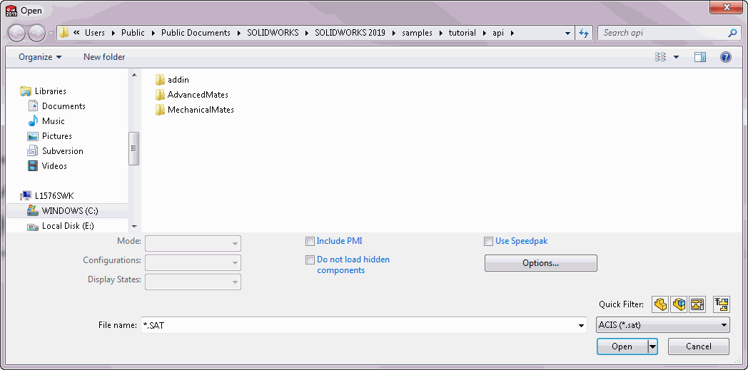

File > Open
Setting
Get/Set Methods
Return Value
or
<Value>
or
<OnFlag>
Comment
Include PMI
ISldWorks::GetUserPreferenceToggle(swUserPreferenceToggle_e.swIncludePMI)
ISldWorks::SetUserPreferenceToggle(swUserPreferenceToggle_e.swIncludePMI, <OnFlag>)
Boolean value
Specifies whether to include Product Manufacturing information when opening these non-native file types:
  • ACIS
  • CATIA V5
  • ProE/Creo
  • Unigraphics/NX
  • Inventor
  • Solid Edge
