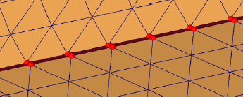

Merge Merges non-coincident nodes of neighboring triangle elements.
Select the nodes to merge with a selection widow.
Auto Merge Sets the tolerance limit for merging all non-coincident nodes of the mesh. If the distance between two nodes is larger that this tolerance, these nodes are not merged.
