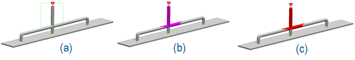

Example
Click and drag a two-dimensional box to select elements (a). All elements within the box, both visible and hidden, are highlighted in purple (b). Click Apply to add the highlighted elements to the set of Runner elements, which are highlighted in red (c).

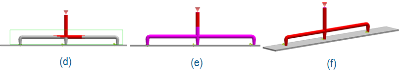

Click and drag a second two-dimensional box to select more elements (d). All elements within the box, both visible and hidden, are highlighted in purple (e). Click Apply to add the highlighted elements to the set of Runner elements (f). (Click Delete to remove the highlighted elements from the set of Runner Elements.) |
