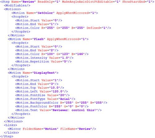

Here are examples of XML codes that you could write to create a custom animation called "Review", and to be able to mirror it.
Code Description
The XML elements shown in the code example above are described here.
<Step>
Creates an animation. Parameters are as follows:
Name: Text displayed to identify the animation in the Animation Library workshop.
ReadOnly: Specifies whether or not to allow the user to modify the property values in the Animation Library workshop.
  • "0": Allows the user to modify the property values.
  • "1": Prevents the user from modifying the property values.
(Optional) MakeAngleAxisDistPtEditable: Specifies whether or not to make the angle, axis, distance, and point properties of animated actors editable in the Animation Library workshop, when ReadOnly is set to "1".
  • "0": Prevents the user from modifying the angle, axis, distance, and point properties of animated actors.
  • "1": Allows the user to modify the angle, axis, distance, and point properties of animated actors.
ShowStartEnd: For each motion of the animation, specifies whether to hide or to show the Start time and End time property values in the Animation Library workshop.
  • "0": Hides Start time and End time.
  • "1": Shows Start time and End time.
<Modifiables>
Introduces the various motions that make up the animation. Standalone, compulsory element.
<Motions>
Introduces the individual motions that make up the animation.
<Motion>
Creates an individual motion within the animation. Each motion has the following parameter:
Name: Text displayed to identify the motion in the Animation Library workshop.
(Optional) ApplyWhenMirrored: For each motion of the animation, specifies whether or not to ignore the original animation definition and to use the motion definition described in the mirrored XML.
  • "0": Applies the original animation definition in the mirrored XML.
  • "1": Ignores the original animation definition and uses the motion definition described in the mirrored XML.
(Optional) Defined: For the Motion.Color property of the Flash and SetColor motions, specifies whether or not to change the color of the selected actor during this step of the animation.
  • "0": Sets the color to Undefined.
  • "1": Takes the RGB values into account.
Note: If you do not specify a Defined parameter, the RGB values are taken into account.
<PropSet>
Introduces the property set of the motion.
<Motion.XXX>
Defines each property of the motion, using one or several parameters.
<Links>
(Optional) Defines a link type to other animations.
Note: If you do not use this XML element, there is no mirrored version of this animation.
<Mirror>
(Optional) Creates a mirror link type. Parameters are as follows:
FolderName: Name of the folder where the XML file describing the animation to mirror is located.
FileName: Name of the XML file describing the animation to mirror.
Note: Both the FolderName and FileName parameters are case-sensitive.
