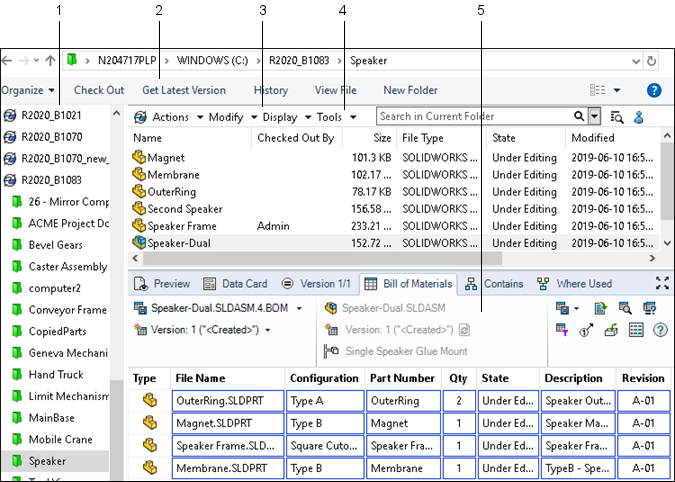

| 1 |
Navigation pane |
Lets you
browse vaults and folders. |
| 2 |
Windows
File Explorer toolbar |
Contains commands that apply to the selected file or folder. When you are logged in to vault, the Help button on the Windows
File
Explorer toolbar opens the SOLIDWORKS PDM File Explorer
help.
| 3 |
SOLIDWORKS PDM menu bar |
Contains menus of commands that can be performed for the selected file or folder. |
| 4 |
BOM lists |
Lists the named and activated BOMs in the current folder. |
| 5 |
BOM contents |
Displays the details of the BOM, which depend on the type of BOM you are viewing. |
