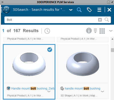

In the Search box, enter the
search terms
for the model and press Enter.
The 3DSearch app opens and displays
the results.
From the search results,
select
a
model, and
click
the
down
arrow to select the following choices:
Option |
Description |
Preview |
Lets you preview models in 3DPlay. |
Relations |
Displays
the relations and dependencies models using the Relations widget. |
Open |
Opens
models
in the graphics area. |
Open With |
Opens models in the following widgets:
- 3DMarkup
- Issue Management
- Product Explorer
Select Open or drag the
model to the graphics area.

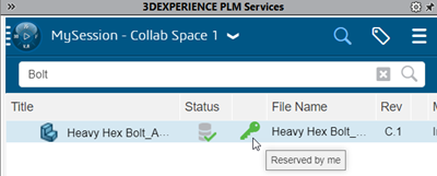

In the top bar, click the
down
arrow to return to MySession.
Right-click the model and select Reserve.
