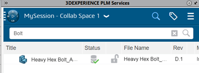

To save models in MySession:
Do one of the following:
- Right-click the model and click Save.
- Open the action bar at the bottom of MySession
and click .
The
action bar is minimized at the bottom of MySession.
In
the Save to
3DEXPERIENCE
dialog box,
select
options, such as:
- Save
- Optional.
New
Revision
- Optional.
Release reservation
after Save
When you release the model,
another user can reserve and modify it.
Click Save.
MySession unreserves the model and updates the revision. For details,
see Save Dialog Box in Dassault Systèmes
User Assistance. Access to Dassault Systèmes User Assistance requires 3DEXPERIENCE credentials.
