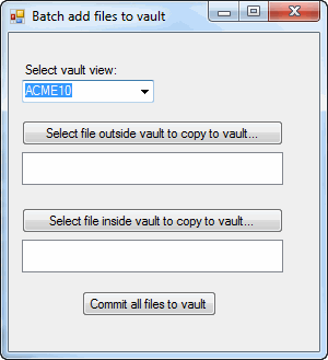

' Postconditions:
'  1. The Batch add files to vault dialog box displays.
'     a. Select a vault view.
'     b. Click Select file outside vault to copy to vault.
'     c. In the Select File dialog:
'        1. Click a file outside the vault.
'        2. Click Open.
'     d. Click Select file inside vault to copy to vault.
'     e. In the Select File dialog:
'        1. Click a file in the vault.
'        2. Click Open.
'     f. Click Commit all files to vault.
'  2. Click Add in the Batch Items dialog box.
'  3. Click OK to close the message box.
'     Two new folders, Folder1 and Folder2, are created in the vault's
'     root directory. The first selected file is copied to Folder1.
'     The second selected file is copied to Folder2.
'  4. Close the Batch add files to vault dialog box.

        Me.VaultsLabel.AutoSize = True
        Me.VaultsLabel.Location = New System.Drawing.Point(12, 27)
        Me.VaultsLabel.Name = "VaultsLabel"
        Me.VaultsLabel.Size = New System.Drawing.Size(91, 13)
        Me.VaultsLabel.TabIndex = 0
        Me.VaultsLabel.Text = "Select vault view:"
        'VaultsComboBox
        Me.VaultsComboBox.FormattingEnabled = True
        Me.VaultsComboBox.Location = New System.Drawing.Point(12, 43)
        Me.VaultsComboBox.Name = "VaultsComboBox"
        Me.VaultsComboBox.Size = New System.Drawing.Size(121, 21)
        Me.VaultsComboBox.TabIndex = 1
        'BatchAdd
        Me.BatchAdd.Location = New System.Drawing.Point(67, 236)
        Me.BatchAdd.Name = "BatchAdd"
        Me.BatchAdd.Size = New System.Drawing.Size(123, 23)
        Me.BatchAdd.TabIndex = 2
        Me.BatchAdd.Text = "Commit all files to vault"
        Me.BatchAdd.UseVisualStyleBackColor = True
        'CopyToVault
        Me.CopyToVault.Location = New System.Drawing.Point(12, 80)
        Me.CopyToVault.Name = "CopyToVault"
        Me.CopyToVault.Size = New System.Drawing.Size(239, 23)
        Me.CopyToVault.TabIndex = 3
        Me.CopyToVault.Text = "Select file outside vault to copy to vault..."
        Me.CopyToVault.UseVisualStyleBackColor = True

        Me.CopyFromVault.Text = "Select file inside vault to copy to vault..."
        Me.CopyFromVault.UseVisualStyleBackColor = True
        'FileList2
        Me.FileList2.FormattingEnabled = True
        Me.FileList2.Location = New System.Drawing.Point(12, 189)
        Me.FileList2.Name = "FileList2"
        Me.FileList2.Size = New System.Drawing.Size(239, 30)
        Me.FileList2.TabIndex = 6
        'SelectFileDialog
        Me.SelectFileDialog.Title = "Select File"
        'Form1
        Me.AutoScaleDimensions = New System.Drawing.SizeF(6.0!, 13.0!)
        Me.AutoScaleMode = System.Windows.Forms.AutoScaleMode.Font
        Me.ClientSize = New System.Drawing.Size(284, 291)
        Me.Controls.Add(Me.FileList2)
        Me.Controls.Add(Me.CopyFromVault)
        Me.Controls.Add(Me.FileList1)
        Me.Controls.Add(Me.CopyToVault)
        Me.Controls.Add(Me.BatchAdd)
        Me.Controls.Add(Me.VaultsComboBox)
        Me.Controls.Add(Me.VaultsLabel)
        Me.Name = "Form1"
        Me.Text = "Batch add files to vault"
        Me.ResumeLayout(False)
        Me.PerformLayout()
    End Sub
