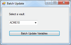

// Postconditions:
//  1. Displays the Batch Update dialog box.
//     a. Select a vault.
//     b. Click Batch Update Variables.
//        * Updates the Title and Comment variables in the data cards
//          only of checked-out text files.
//        * Updates the Description variable of the data cards of all folders
//          with the word Folder in their names.
//        * Displays a message box saying Card variables updated.
//     c. Click OK to close the message box.
//  2. Close the Batch Update dialog box.
//  3. Inspect the data cards of any checked-out text files and folders with
//     the word Folder in their names in the selected vault.

            this.BatchUpdateButton = new System.Windows.Forms.Button();
            this.VaultsComboBox = new System.Windows.Forms.ComboBox();
            this.Label1 = new System.Windows.Forms.Label();
            this.SuspendLayout();
            //BatchUpdateButton
            this.BatchUpdateButton.Location = new System.Drawing.Point(30, 100);
            this.BatchUpdateButton.Name = "BatchUpdateButton";
            this.BatchUpdateButton.Size = new System.Drawing.Size(215, 23);
            this.BatchUpdateButton.TabIndex = 0;
            this.BatchUpdateButton.Text = "Batch Update Variables";
            this.BatchUpdateButton.UseVisualStyleBackColor = true;
            this.BatchUpdateButton.Click += new System.EventHandler(this.BatchUpdateButton_Click);
