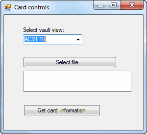

Get Card Control Information Example (VB.NET)
This example shows how to get information about the list and edit box controls in a selected file's data card.
NOTE: If using the primary interop assembly provided with SOLIDWORKS PDM Professional, see Using .NET Framework 4.0 in Stand-alone Applications.
' Preconditions:
'  1. Start Microsoft Visual Studio 2010.
'  2. Click File > New > Project > Visual Basic > Windows Forms Application.
'  3. Type CardControlInfo in Name.
'  4. Click Browse to navigate to the folder where to create the project.
'  5. Click OK.
'  6. Click Show All Files in the Solution Explorer toolbar and expand
'     Form1.vb in the Solution Explorer.
'  7. Replace the code in Form1.vb with this code.
'  8. To create the form, replace the code in
Form1.Designer.vb with this code.
'  9. Add EPDM.Interop.epdm.dll as a reference (right-click the project
'     name in the Solution Explorer, click Add Reference, click
'     Framework in the left-side panel, browse to the top folder of your
'     SOLIDWORKS PDM Professional installation, locate and click
'     EPDM.Interop.epdm.dll, click Open, click Add, and click Close).
' 10. Right-click EPDM.Interop.epdm in References, select Properties, and set
'     Embed Interop Types to False to handle methods that pass arrays of
'     structures.
' 11. Ensure that there is a file in the vault whose extension has a
'     file data card in the vault, and the file data card has a droplist
'     control.
' 12. Click Debug > Start Debugging or press F5.
' Postconditions:
'  1. Displays a dialog.
'  2. Select a vault.
'  3. Click Select file.
'  4. In the Select File dialog:
'     a. Click a file whose extension has a file data card in the vault.
'     b. Click Open.
'  5. Click Get card information.
'  6. A message box displays information about the selected file's data card.
'  7. Click OK in the message box.
'  8. A message box displays the list items of any drop list controls.
'  9. Click OK in the message box.
' 10. A message box displays information about each edit box control in the
'     data card.
' 11. Click OK in the message box.
' 12. Close the dialog.

    Private Sub InitializeComponent()
        Me.VaultsLabel = New System.Windows.Forms.Label()
        Me.VaultsComboBox = New System.Windows.Forms.ComboBox()
        Me.SelectFiles = New System.Windows.Forms.Button()
        Me.File1List = New System.Windows.Forms.ListBox()
        Me.GetCardControls = New System.Windows.Forms.Button()
        Me.OpenFileDialog1 = New System.Windows.Forms.OpenFileDialog()
        Me.SuspendLayout()
        'VaultsLabel
        Me.VaultsLabel.AutoSize = True
        Me.VaultsLabel.Location = New System.Drawing.Point(36, 24)
        Me.VaultsLabel.Name = "VaultsLabel"
        Me.VaultsLabel.Size = New System.Drawing.Size(91, 13)
        Me.VaultsLabel.TabIndex = 0
        Me.VaultsLabel.Text = "Select vault view:"
        'VaultsComboBox
        Me.VaultsComboBox.FormattingEnabled = True
        Me.VaultsComboBox.Location = New System.Drawing.Point(39, 40)
        Me.VaultsComboBox.Name = "VaultsComboBox"
        Me.VaultsComboBox.Size = New System.Drawing.Size(121, 21)
        Me.VaultsComboBox.TabIndex = 1
        'SelectFiles
        Me.SelectFiles.Location = New System.Drawing.Point(39, 85)
        Me.SelectFiles.Name = "SelectFiles"
        Me.SelectFiles.Size = New System.Drawing.Size(191, 23)
        Me.SelectFiles.TabIndex = 2
        Me.SelectFiles.Text = "Select file..."
        Me.SelectFiles.UseVisualStyleBackColor = True
        'File1List
        Me.File1List.FormattingEnabled = True
        Me.File1List.HorizontalScrollbar = True
        Me.File1List.Location = New System.Drawing.Point(40, 114)
        Me.File1List.Name = "File1List"
        Me.File1List.SelectionMode = System.Windows.Forms.SelectionMode.MultiExtended
        Me.File1List.Size = New System.Drawing.Size(220, 43)
        Me.File1List.TabIndex = 4
        'GetCardControls
        Me.GetCardControls.Location = New System.Drawing.Point(40, 183)
        Me.GetCardControls.Name = "GetCardControls"
        Me.GetCardControls.Size = New System.Drawing.Size(157, 23)
        Me.GetCardControls.TabIndex = 6
        Me.GetCardControls.Text = "Get card  information"
        Me.GetCardControls.UseVisualStyleBackColor = True
        'OpenFileDialog1
        Me.OpenFileDialog1.FileName = "OpenFileDialog1"
        Me.OpenFileDialog1.Title = "Select File"
        'Form1
        Me.AutoScaleDimensions = New System.Drawing.SizeF(6.0!, 13.0!)
        Me.AutoScaleMode = System.Windows.Forms.AutoScaleMode.Font
        Me.ClientSize = New System.Drawing.Size(284, 235)
        Me.Controls.Add(Me.GetCardControls)
        Me.Controls.Add(Me.File1List)
        Me.Controls.Add(Me.SelectFiles)
        Me.Controls.Add(Me.VaultsComboBox)
        Me.Controls.Add(Me.VaultsLabel)
        Me.Name = "Form1"
        Me.Text = "Card controls"
        Me.ResumeLayout(False)
        Me.PerformLayout()
    End Sub
