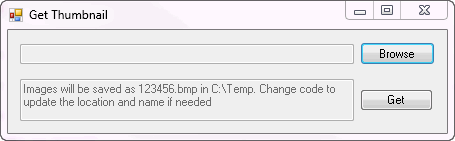

Get a File's Thumbnail by File Version (C#)
This example shows how to get a file's thumbnail by version.

// 1. In the Get Thumbnail dialog, click Browse.
// 2. Navigate to a vault that contains a model with a thumbnail. Click Open.
// 3. In the Get Thumbnail dialog, click Get.
// 4. c:\temp\123456.bmp is the thumbnail of the model.
