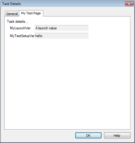

Private Sub OnTaskDetails(ByRef poCmd As EdmCmd, ByRef ppoData As System.Array)
  Dim inst As IEdmTaskInstance
  inst = poCmd.mpoExtra
  'Create a custom page in the task properties dialog box; TaskDetailsPage is a
  'user control; TaskDetailsPage::LoadData fills in some edit boxes with
  'values from IEdmTaskInstance::GetValEx
  Dim myPage As TaskDetailsPage
  myPage = New TaskDetailsPage
  myPage.CreateControl()
  poCmd.mpoExtra = myPage
  poCmd.mlParentWnd = myPage.Handle.ToInt32
  poCmd.mbsComment = "My Test Page"
  myPage.LoadData(inst)
End Sub

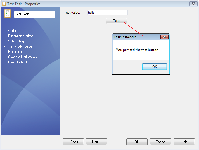

Private Sub OnTaskSetup(ByRef poCmd As EdmCmd, ByRef ppoData As System.Array)
  'Get the property interface used to access the framework
  Dim props As IEdmTaskProperties
  props = poCmd.mpoExtra
  'Turn on some properties, e.g., the task can be launched during a
  'state change,
can extend the details page, is called when the
  'task is
launched, and supports scheduling
  props.TaskFlags = EdmTaskFlag.EdmTask_SupportsChangeState + EdmTaskFlag.EdmTask_SupportsDetails + EdmTaskFlag.EdmTask_SupportsInitExec + EdmTaskFlag.EdmTask_SupportsScheduling
  'Set menu commands that launch this task from File Explorer
  Dim cmds(0) As EdmTaskMenuCmd
  cmds(0).mbsMenuString = "Run the test task"
  cmds(0).mbsStatusBarHelp = "This command runs the task add-in"
  cmds(0).mlCmdID = 1
  cmds(0).mlEdmMenuFlags = EdmMenuFlags.EdmMenu_Nothing
  props.SetMenuCmds(cmds)
  'Add a custom setup page; SetupPage is a user control with an
  'edit box; SetupPage::LoadData populates the edit box from a
  'variable in IEdmTaskProperties; saving of properties is handled
  'by OnTaskSetupButton
  currentSetupPage = New SetupPage
  currentSetupPage.CreateControl()
  currentSetupPage.LoadData(poCmd)
  Dim pages(0) As EdmTaskSetupPage
  pages(0).mbsPageName = "Test Add-in page"
  pages(0).mlPageHwnd = currentSetupPage.Handle.ToInt32
  pages(0).mpoPageImpl = currentSetupPage
  props.SetSetupPages(pages)
End Sub

The following is a resource template of the custom set-up page that is displayed in the Task property dialog box by TaskAddIn::OnTaskSetup. It is a user control in Visual Studio with an edit box named TextBox1 and a button named TestButton.
The code behind the custom set-up page is as follows.
Imports EPDM.Interop.epdm
Public Class SetupPage
'Button handler for a button on the page
Private Sub TestButton_Click(ByVal sender As System.Object, ByVal e As System.EventArgs) Handles TestButton.Click
  MsgBox("You pressed the test button")
End Sub
Public Sub LoadData(ByRef poCmd As EdmCmd)
  'Populate the edit box from a variable
TextBox1.Text = props.GetValEx("MyTestSetupVar")
End Sub
Public Sub StoreData(ByRef poCmd As EdmCmd)
  'Make sure the user has typed a value in the edit box
  If TextBox1.Text = "" Then
    MsgBox("Enter a test value for the add-in!")
    poCmd.mbCancel = True
    Exit Sub
  End If
  'Save the value entered by the user
  props.SetValEx("MyTestSetupVar", TextBox1.Text)
End Sub
End Class

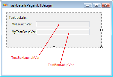

The following is the resource template of the extra details page added by TaskAddIn::OnTaskDetails. It is a user control in Visual Studio that displays two task variables:
The code behind the extra details page:
Public Class TaskDetailsPage
Public Sub LoadData(ByRef inst As IEdmTaskInstance)
  'Populate the editboxes from the variables in the task
  TextBoxSetupVar.Text = CStr(inst.GetValEx("MyTestSetupVar"))
  TextBoxLaunchVar.Text = CStr(inst.GetValEx("MyLaunchVar"))
End Sub
End Class
The following is the set-up page when the add-in is used in a task.
The following is the task details page when opened from the task list.
