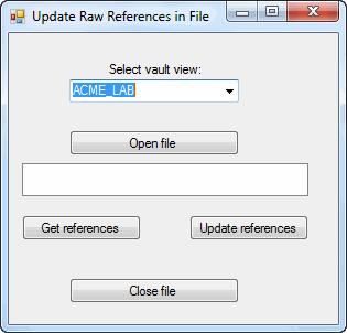

'  1. Displays the Update Raw References in File dialog box.
'  2. Select the vault view where the SOLIDWORKS assembly or
'     drawing document that you checked out in
'     Preconditions step 4 resides.
'  3. Click Open file.
'  4. Displays the Open a file dialog box.
'     a. Click the assembly or drawing document you checked
'        out in Preconditions step 4.
'     b. Click Open.
'     The opened file's path and file name appear
'     in the Update Raw References in File dialog box.
'  5. Click Get references.
'     a. Displays a message box for each referenced file.
'        The referenced file's ID, path and file name, file name,
'        type, and number of times referenced appear in the
'        message box.
'     b. Click OK to close each message box.

'Form.Designer.vb
<Global.Microsoft.VisualBasic.CompilerServices.DesignerGenerated()> _
Partial Class Form1
    Inherits System.Windows.Forms.Form
    'Form overrides dispose to clean up the component list.
    <System.Diagnostics.DebuggerNonUserCode()> _
    Protected Overrides Sub Dispose(ByVal disposing As Boolean)
        Try
            If disposing AndAlso components IsNot Nothing Then
                components.Dispose()
            End If
        Finally
            MyBase.Dispose(disposing)
        End Try
    End Sub
    'Required by the Windows Form Designer
    Private components As System.ComponentModel.IContainer
    'NOTE: The following procedure is required by the Windows Form Designer
    'It can be modified using the Windows Form Designer.
    'Do not modify it using the code editor.
    <System.Diagnostics.DebuggerStepThrough()> _
    Private Sub InitializeComponent()
        Me.Label1 = New System.Windows.Forms.Label()
        Me.VaultsComboBox = New System.Windows.Forms.ComboBox()
        Me.OpenButton = New System.Windows.Forms.Button()
        Me.GetButton = New System.Windows.Forms.Button()
        Me.UpdateButton = New System.Windows.Forms.Button()
        Me.CloseButton = New System.Windows.Forms.Button()
        Me.FileListBox = New System.Windows.Forms.ListBox()
        Me.OpenFileDialog1 = New System.Windows.Forms.OpenFileDialog()
        Me.SuspendLayout()
        'Label1
        Me.Label1.AutoSize = True
        Me.Label1.Location = New System.Drawing.Point(88, 26)
        Me.Label1.Name = "Label1"
        Me.Label1.Size = New System.Drawing.Size(91, 13)
        Me.Label1.TabIndex = 0
        Me.Label1.Text = "Select vault view:"
        'VaultsComboBox
        Me.VaultsComboBox.FormattingEnabled = True
        Me.VaultsComboBox.Location = New System.Drawing.Point(55, 42)
        Me.VaultsComboBox.Name = "VaultsComboBox"
        Me.VaultsComboBox.Size = New System.Drawing.Size(154, 21)
        Me.VaultsComboBox.TabIndex = 1
        'OpenButton
        Me.OpenButton.Location = New System.Drawing.Point(55, 88)
        Me.OpenButton.Name = "OpenButton"
        Me.OpenButton.Size = New System.Drawing.Size(154, 23)
        Me.OpenButton.TabIndex = 2
        Me.OpenButton.Text = "Open file"
        Me.OpenButton.UseVisualStyleBackColor = True
        'GetButton
        Me.GetButton.Location = New System.Drawing.Point(12, 165)
        Me.GetButton.Name = "GetButton"
        Me.GetButton.Size = New System.Drawing.Size(108, 23)
        Me.GetButton.TabIndex = 3
        Me.GetButton.Text = "Get references"
        Me.GetButton.UseVisualStyleBackColor = True
        'UpdateButton
        Me.UpdateButton.Location = New System.Drawing.Point(164, 165)
        Me.UpdateButton.Name = "UpdateButton"
        Me.UpdateButton.Size = New System.Drawing.Size(108, 23)
        Me.UpdateButton.TabIndex = 4
        Me.UpdateButton.Text = "Update references"
        Me.UpdateButton.UseVisualStyleBackColor = True
        'CloseButton
        Me.CloseButton.Location = New System.Drawing.Point(55, 222)
        Me.CloseButton.Name = "CloseButton"
        Me.CloseButton.Size = New System.Drawing.Size(154, 23)
        Me.CloseButton.TabIndex = 5
        Me.CloseButton.Text = "Close file"
        Me.CloseButton.UseVisualStyleBackColor = True
        'FileListBox
        Me.FileListBox.FormattingEnabled = True
        Me.FileListBox.Location = New System.Drawing.Point(12, 118)
        Me.FileListBox.Name = "FileListBox"
        Me.FileListBox.Size = New System.Drawing.Size(260, 30)
        Me.FileListBox.TabIndex = 6
        'OpenFileDialog1
        Me.OpenFileDialog1.FileName = "OpenFileDialog1"
        Me.OpenFileDialog1.Multiselect = True
        Me.OpenFileDialog1.Title = "Open a file"
        'Form1
        Me.AutoScaleDimensions = New System.Drawing.SizeF(6.0!, 13.0!)
        Me.AutoScaleMode = System.Windows.Forms.AutoScaleMode.Font
        Me.ClientSize = New System.Drawing.Size(284, 264)
        Me.Controls.Add(Me.FileListBox)
        Me.Controls.Add(Me.CloseButton)
        Me.Controls.Add(Me.UpdateButton)
        Me.Controls.Add(Me.GetButton)
        Me.Controls.Add(Me.OpenButton)
        Me.Controls.Add(Me.VaultsComboBox)
        Me.Controls.Add(Me.Label1)
        Me.Name = "Form1"
        Me.Text = "Update References in File"
        Me.ResumeLayout(False)
        Me.PerformLayout()
    End Sub
    Friend WithEvents Label1 As System.Windows.Forms.Label
    Friend WithEvents VaultsComboBox As System.Windows.Forms.ComboBox
    Friend WithEvents OpenButton As System.Windows.Forms.Button
    Friend WithEvents GetButton As System.Windows.Forms.Button
    Friend WithEvents UpdateButton As System.Windows.Forms.Button
    Friend WithEvents CloseButton As System.Windows.Forms.Button
    Friend WithEvents FileListBox As System.Windows.Forms.ListBox
    Friend WithEvents OpenFileDialog1 As System.Windows.Forms.OpenFileDialog
End Class
