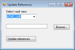

// Postconditions:
//  1. Displays your Update References dialog box.
//  2. Select a vault view.
//  3. Click Browse.
//  4. Displays the Select a file dialog box.
//     a. Click a file in the selected vault.
//     b. Click Open.
//     The selected file's path and file name appear
//     in the Select a file dialog box.
//  5. Click Update references.
//  6. Initializes and displays SOLIDWORKS PDM Professional's Update References
//     dialog box, which shows the name of the selected file whose file references
//     to update and the names of the file references, if any.
//  7. Click Close.
//  8. Close your Update References dialog box.
