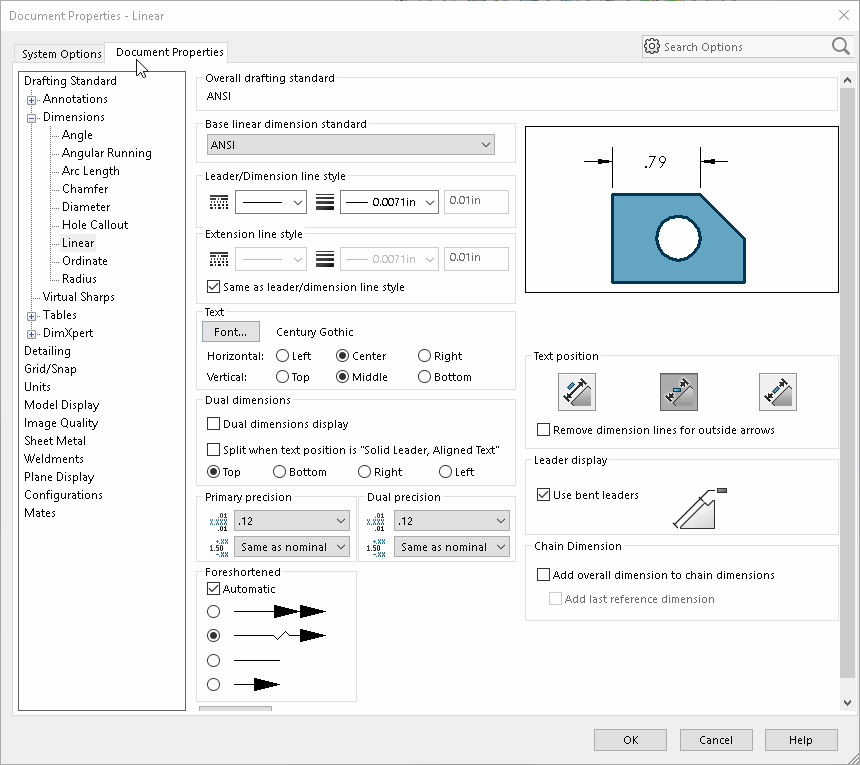

Document Properties > Dimensions > Linear
Setting
Get/Set Methods
Return Value or <Value>
Comments
Base linear dimension standard
IModelDocExtension::GetUserPreferenceInteger(swUserPreferenceIntegerValue_e.swDetailingDimensionStandard, swUserPreferenceOption_e.swDetailingLinearDimension)
IModelDocExtension::SetUserPreferenceInteger(swUserPreferenceIntegerValue_e.swDetailingDimensionStandard, swUserPreferenceOption_e.swDetailingLinearDimension, swDetailingStandard_e.<Value>)
See swDetailingStandard_e for valid options
Specifies the base linear dimensioning standard to use
Leader/Dimension Line Style - Leader Style
IModelDocExtension::GetUserPreferenceInteger(swUserPreferenceIntegerValue_e.swLineFontDimensionsStyle, swUserPreferenceOption_e.swDetailingLinearDimension)
IModelDocExtension::SetUserPreferenceInteger(swUserPreferenceIntegerValue_e.swLineFontDimensionsStyle, swUserPreferenceOption_e.swDetailingLinearDimension, swLineStyles_e.<Value>)
See swLineStyles_e for valid options
Specifies style of leader lines for linear dimensions
Leader/Dimension Line Style - Leader Thickness
IModelDocExtension::GetUserPreferenceInteger(swUserPreferenceIntegerValue_e.swLineFontDimensionsThickness, swUserPreferenceOption_e.swDetailingLinearDimension)
IModelDocExtension::SetUserPreferenceInteger(swUserPreferenceIntegerValue_e.swLineFontDimensionsThickness, swUserPreferenceOption_e.swDetailingLinearDimension, swLineWeights_e.<Value>)
See swLineWeights_e for valid options
Specifies thickness of leader lines for linear dimensions
Leader/Dimension Line Style - Custom Thickness
IModelDocExtension::GetUserPreferenceDouble(swUserPreferenceDoubleValue_e.swLineFontDimensionsThicknessCustom, swUserPreferenceOption_e.swDetailingLinearDimension)
IModelDocExtension::SetUserPreferenceDouble(swUserPreferenceDoubleValue_e.swLineFontDimensionsThicknessCustom, swUserPreferenceOption_e.swDetailingLinearDimension, <Value>)
Double value
Specifies a custom thickness for leader lines in linear dimensions; sets Custom Thickness to the specified thickness and Leader Thickness to Custom Size
Extension Line Style - Extension Line Style
IModelDocExtension::GetUserPreferenceInteger(swUserPreferenceIntegerValue_e.swDimensionsExtensionLineStyle, swUserPreferenceOption_e.swDetailingLinearDimension)
IModelDocExtension::SetUserPreferenceInteger(swUserPreferenceIntegerValue_e.swDimensionsExtensionLineStyle, swUserPreferenceOption_e.swDetailingLinearDimension, swLineStyles_e.<Value>)
Specifies style of extension lines for linear dimensions
Extension Line Style - Extension Line Thickness
IModelDocExtension::GetUserPreferenceInteger(swUserPreferenceIntegerValue_e.swDimensionsExtensionLineStyleThickness, swUserPreferenceOption_e.swDetailingLinearDimension)
IModelDocExtension::SetUserPreferenceInteger(swUserPreferenceIntegerValue_e.swDimensionsExtensionLineStyleThickness, swUserPreferenceOption_e.swDetailingLinearDimension, swLineWeights_e.<Value>)
Specifies thickness of extension lines for linear dimensions
Extension Line Style - Custom Thickness
IModelDocExtension::GetUserPreferenceDouble(swUserPreferenceDoubleValue_e.swDimensionsExtensionLineStyleThicknessCustom, swUserPreferenceOption_e.swDetailingLinearDimension)
IModelDocExtension::SetUserPreferenceDouble(swUserPreferenceDoubleValue_e.swDimensionsExtensionLineStyleThicknessCustom, swUserPreferenceOption_e.swDetailingLinearDimension, <Value>)
Double value
Specifies a custom thickness for extension lines in linear dimensions; sets Custom Thickness to the specified thickness and Extension Line Thickness to Custom Size
Extension Line Style - Same as leader/dimension line style
IModelDocExtension::GetUserPreferenceToggle(swUserPreferenceToggle_e.swDimensionsExtensionLineStyleSameAsLeader, swUserPreferenceOption_e.swDetailingLinearDimension)
IModelDocExtension::SetUserPreferenceToggle(swUserPreferenceToggle_e.swDimensionsExtensionLineStyleSameAsLeader, swUserPreferenceOption_e.swDetailingLinearDimension, <Value>)
Boolean value
Specifies whether the extension line style is the same as the leader/dimension line style
Text - Font...
IModelDocExtension::GetUserPreferenceTextFormat(swUserPreferenceTextFormat_e.swDetailingDimensionTextFormat, swUserPreferenceOption_e.swDetailingLinearDimension)
IModelDocExtension::SetUserPreferenceTextFormat(swUserPreferenceTextFormat_e.swDetailingDimensionTextFormat, swUserPreferenceOption_e.swDetailingLinearDimension, <Value>)
See ITextFormat for font options
To set font property values, implement ITextFormat, set the appropriate ITextFormat member values, and pass the ITextFormat object in the API set method
Text - Horizontal
IModelDocExtension::GetUserPreferenceInteger(swUserPreferenceIntegerValue_e.swDetailingDimensionTextAlignmentHorizontal, swUserPreferenceOption_e.swDetailingLinearDimension)
IModelDocExtension::SetUserPreferenceInteger(swUserPreferenceIntegerValue_e.swDetailingDimensionTextAlignmentHorizontal, swUserPreferenceOption_e.swDetailingLinearDimension, swTextJustification_e.<Value>)
See swTextJustification_e for valid options
Text - Vertical
IModelDocExtension::GetUserPreferenceInteger(swUserPreferenceIntegerValue_e.swDetailingDimensionTextAlignmentVertical, swUserPreferenceOption_e.swDetailingLinearDimension)
IModelDocExtension::SetUserPreferenceInteger(swUserPreferenceIntegerValue_e.swDetailingDimensionTextAlignmentVertical, swUserPreferenceOption_e.swDetailingLinearDimension, swTextAlignmentVertical_e.<Value>)
See swTextAlignmentVertical_e for valid options
Dual dimensions - Dual dimensions display
IModelDocExtension::GetUserPreferenceToggle(swUserPreferenceToggle_e.swDetailingDualDimensions, swUserPreferenceOption_e.swDetailingLinearDimension)
IModelDocExtension::SetUserPreferenceToggle(swUserPreferenceToggle_e.swDetailingDualDimensions, swUserPreferenceOption_e.swDetailingLinearDimension, <Value>)
Boolean value
Specifies whether to display dimensions in two kinds of units
Dual dimensions - Show units for dual display
IModelDocExtension::GetUserPreferenceToggle(swUserPreferenceToggle_e.swDetailingShowDualDimensionUnits, swUserPreferenceOption_e.swDetailingLinearDimension)
IModelDocExtension::SetUserPreferenceToggle(swUserPreferenceToggle_e.swDetailingShowDualDimensionUnits, swUserPreferenceOption_e.swDetailingLinearDimension, <Value>)
Boolean value
Specifies whether to display units for dual dimensions; available only on drawings
Dual dimensions - Split when text position is "Solid Leader, Aligned Text"
IModelDocExtension::GetUserPreferenceToggle(swUserPreferenceToggle_e.swDetailingSplitDualDimensions, swUserPreferenceOption_e.swDetailingLinearDimension)
IModelDocExtension::SetUserPreferenceToggle(swUserPreferenceToggle_e.swDetailingSplitDualDimensions, swUserPreferenceOption_e.swDetailingLinearDimension, <Value>)
Boolean value
Specifies whether to display dual dimensions above and below dimension lines; valid only if Text position is swDisplayDimensionLeaderText_e.swSolidLeaderAlignedText
Dual dimensions - Dimension position
IModelDocExtension::GetUserPreferenceInteger(swUserPreferenceIntegerValue_e.swDetailingDualDimPosition, swUserPreferenceOption_e.swDetailingLinearDimension)
IModelDocExtension::SetUserPreferenceInteger(swUserPreferenceIntegerValue_e.swDetailingDualDimPosition, swUserPreferenceOption_e.swDetailingLinearDimension, swDetailingDualDimPosition_e.<Value>)
See swDetailingDualDimPosition_e for valid options
Positions the display of dimensions in two kinds of units
Primary precision - Unit Precision
IModelDocExtension::GetUserPreferenceInteger(swUserPreferenceIntegerValue_e.swDetailingLinearDimPrecision, swUserPreferenceOption_e.swDetailingLinearDimension)
IModelDocExtension::SetUserPreferenceInteger(swUserPreferenceIntegerValue_e.swDetailingLinearDimPrecision, swUserPreferenceOption_e.swDetailingLinearDimension, <Value>)
Number of decimal places to display; 0 through 8
Specifies primary precision for linear dimension
Primary precision - Tolerance Precision
IModelDocExtension::GetUserPreferenceInteger(swUserPreferenceIntegerValue_e.swDetailingLinearTolPrecision, swUserPreferenceOption_e.swDetailingLinearDimension)
IModelDocExtension::SetUserPreferenceInteger(swUserPreferenceIntegerValue_e.swDetailingLinearTolPrecision, swUserPreferenceOption_e.swDetailingLinearDimension, swDimensionPrecisionSettings_e .<Value>)
See swDimensionPrecisionSettings_e for valid options
Specifies primary precision for tolerance
Dual precision - Unit Precision
IModelDocExtension::GetUserPreferenceInteger(swUserPreferenceIntegerValue_e.swDetailingAltLinearDimPrecision, swUserPreferenceOption_e.swDetailingLinearDimension)
IModelDocExtension::SetUserPreferenceInteger(swUserPreferenceIntegerValue_e.swDetailingAltLinearDimPrecision, swUserPreferenceOption_e.swDetailingLinearDimension, <Value>)
Specifies dual precision for alternate linear dimension
Dual precision - Tolerance Precision
IModelDocExtension::GetUserPreferenceInteger(swUserPreferenceIntegerValue_e.swDetailingAltLinearTolPrecision, swUserPreferenceOption_e.swDetailingLinearDimension)
IModelDocExtension::SetUserPreferenceInteger(swUserPreferenceIntegerValue_e.swDetailingAltLinearTolPrecision, swUserPreferenceOption_e.swDetailingLinearDimension, swDimensionPrecisionSettings_e .<Value>)
Specifies dual precision for alternate linear tolerance
Foreshortened - Automatic
IModelDocExtension::GetUserPreferenceToggle(swUserPreferenceToggle_e.swDetailingLinearForeshortenedAutomatic, swUserPreferenceOption_e.swDetailingLinearDimension)
IModelDocExtension::SetUserPreferenceToggle(swUserPreferenceToggle_e.swDetailingLinearForeshortenedAutomatic, swUserPreferenceOption_e.swDetailingLinearDimension, <Value>)
Boolean value
Specifies whether to automatically foreshorten the linear dimension
Foreshortened - Double Arrow, Zigzag, Line, or Single Arrow
IModelDocExtension::GetUserPreferenceInteger(swUserPreferenceIntegerValue_e.swDetailingLinearForeshortened, swUserPreferenceOption_e.swDetailingLinearDimension)
IModelDocExtension::SetUserPreferenceInteger(swUserPreferenceIntegerValue_e.swDetailingLinearForeshortened, swUserPreferenceOption_e.swDetailingLinearDimension, swDetailingLinearForeshortened_e .<Value>)
See swDetailingLinearForeshortened_e for valid options
Specifies the style of the arrow of the foreshortened linear dimension
Tolerance...
See Comments
See Comments
See Dimension Tolerance
Layer
IModelDocExtension::GetUserPreferenceString(swUserPreferenceStringValue_e.swDetailingLayer, swUserPreferenceOption_e.swDetailingLinearDimension)
IModelDocExtension::SetUserPreferenceString(swUserPreferenceStringValue_e.swDetailingLayer, swUserPreferenceOption_e.swDetailingLinearDimension, <Value>)
Valid Options:
  • "Border"
  • "Dimensions"
  • "Notes"
  • "BOM"
  • "FORMAT"
This setting is available only on drawings; depending on drawing, some options may not apply
Text position
IModelDocExtension::GetUserPreferenceInteger(swUserPreferenceIntegerValue_e.swDetailingDimensionTextAndLeaderStyle, swUserPreferenceOption_e.swDetailingLinearDimension)
IModelDocExtension::SetUserPreferenceInteger(swUserPreferenceIntegerValue_e.swDetailingDimensionTextAndLeaderStyle, swUserPreferenceOption_e.swDetailingLinearDimension, swDisplayDimensionLeaderText_e.<Value>)
See swDisplayDimensionLeaderText_e for valid options
Specifies how to display leader
Leader display - Use bent leaders
IModelDocExtension::GetUserPreferenceToggle(swUserPreferenceToggle_e.swDetailingDimANSIBentLeader, swUserPreferenceOption_e.swDetailingLinearDimension)
IModelDocExtension::SetUserPreferenceToggle(swUserPreferenceToggle_e.swDetailingDimANSIBentLeader, swUserPreferenceOption_e.swDetailingLinearDimension, <Value>)
Boolean value
This setting is valid only for ANSI drafting standard
Chain Dimension - Add overall dimension to chain dimensions
IModelDocExtension::GetUserPreferenceToggle(swUserPreferenceToggle_e.swDetailingChainDimensionAddOverallDimensions, swUserPreferenceOption_e.swDetailingLinearDimension)
IModelDocExtension::SetUserPreferenceToggle(swUserPreferenceToggle_e.swDetailingChainDimensionAddOverallDimensions, swUserPreferenceOption_e.swDetailingLinearDimension, <Value>)
Boolean value
Chain Dimension - Add overall dimension to chain dimensions - Add last reference dimension
IModelDocExtension::GetUserPreferenceToggle(swUserPreferenceToggle_e.swDetailingChainDimensionAddLastReferenceDimension, swUserPreferenceOption_e.swDetailingLinearDimension)
IModelDocExtension::SetUserPreferenceToggle(swUserPreferenceToggle_e.swDetailingChainDimensionAddLastReferenceDimension, swUserPreferenceOption_e.swDetailingLinearDimension, <Value>)
Boolean value
This setting is valid only if swDetailingChainDimensionAddOverallDimensions is set to true
