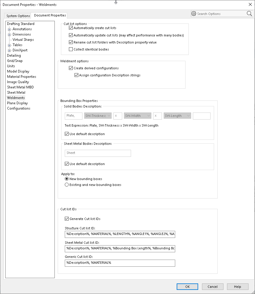

Document Properties >Weldments
Setting
Get/Set Methods
Return Value or <Value> or <OnFlag>
Comments
Cut list options - Automatically create cut lists
IModelDocExtension::GetUserPreferenceToggle(swUserPreferenceToggle_e.swWeldmentEnableAutomaticCutList)
IModelDocExtension::SetUserPreferenceToggle(swUserPreferenceToggle_e.swWeldmentEnableAutomaticCutList, <OnFlag>)
Boolean value
Specifies whether to automatically create cut lists
Cut list options - Automatically update cut lists (may affect performance with many bodies)
IModelDocExtension::GetUserPreferenceToggle(swUserPreferenceToggle_e.swWeldmentEnableAutomaticUpdate)
IModelDocExtension::SetUserPreferenceToggle(swUserPreferenceToggle_e.swWeldmentEnableAutomaticUpdate, <OnFlag>)
Boolean value
Specifies whether to automatically update cut lists
Cut list options - Rename cut list folders with Description property value
IModelDocExtension::GetUserPreferenceToggle(swUserPreferenceToggle_e.swWeldmentRenameCutlistDescriptionPropertyValue)
IModelDocExtension::SetUserPreferenceToggle(swUserPreferenceToggle_e.swWeldmentRenameCutlistDescriptionPropertyValue, <OnFlag>)
Boolean value
Specifies whether to automatically rename cut list folders using the Description property value
Cut list options - Collect identical bodies
IModelDocExtension::GetUserPreferenceToggle(swUserPreferenceToggle_e.swWeldmentCollectIdenticalBodies)
IModelDocExtension::SetUserPreferenceToggle(swUserPreferenceToggle_e.swWeldmentCollectIdenticalBodies, <OnFlag>)
Boolean value
Specifies whether to collect identical bodies
Weldment options - Create derived configurations
IModelDocExtension::GetUserPreferenceToggle(swUserPreferenceToggle_e.swDisableDerivedConfigurations)
IModelDocExtension::SetUserPreferenceToggle(swUserPreferenceToggle_e.swDisableDerivedConfigurations, <OnFlag>)
Boolean value
Specifies whether to create derived configurations; affects newly added configurations only
Weldment options - Assign configuration Description strings
IModelDocExtension::GetUserPreferenceToggle(swUserPreferenceToggle_e.swDisableWeldmentConfigStrings)
IModelDocExtension::SetUserPreferenceToggle(swUserPreferenceToggle_e.swDisableWeldmentConfigStrings, <OnFlag>)
Boolean value
Specifies whether to assign configuration Description strings; swDisableDerivedConfigurations must be true for this setting to be applicable
Bounding Box Properties - Solid Bodies Description - Prefix
IModelDocExtension::GetUserPreferenceString(swUserPreferenceStringValue_e.swSolidBodiesBBoxDescriptionPrefix, swUserPreferenceOption_e.swDetailingNoOptionSpecified)
IModelDocExtension::SetUserPreferenceString(swUserPreferenceStringValue_e.swSolidBodiesBBoxDescriptionPrefix, swUserPreferenceOption_e.swDetailingNoOptionSpecified, <Value>)
String value
Valid only if Solid Bodies Description - Use default description is set to true
Bounding Box Properties - Solid Bodies Description - First property
IModelDocExtension::GetUserPreferenceInteger(swUserPreferenceIntegerValue_e.swSolidBodiesDescriptionFirstPropertyIndex, swUserPreferenceOption_e.swDetailingNoOptionSpecified)
IModelDocExtension::SetUserPreferenceInteger(swUserPreferenceIntegerValue_e.swSolidBodiesDescriptionFirstPropertyIndex, swUserPreferenceOption_e.swDetailingNoOptionSpecified, swSolidBodiesDescriptionPropertyIndex.<Value>)
Integer value as defined in swSolidBodiesDescriptionPropertyIndex
Bounding Box Properties - Solid Bodies Description - First separator
IModelDocExtension::GetUserPreferenceString(swUserPreferenceStringValue_e.swSolidBodiesBBoxDescriptionFirstSeparator, swUserPreferenceOption_e.swDetailingNoOptionSpecified)
IModelDocExtension::SetUserPreferenceString(swUserPreferenceStringValue_e.swSolidBodiesBBoxDescriptionFirstSeparator, swUserPreferenceOption_e.swDetailingNoOptionSpecified, <Value>)
String value
Bounding Box Properties - Solid Bodies Description - Second property
IModelDocExtension::GetUserPreferenceInteger(swUserPreferenceIntegerValue_e.swSolidBodiesDescriptionSecondPropertyIndex, swUserPreferenceOption_e.swDetailingNoOptionSpecified)
IModelDocExtension::SetUserPreferenceInteger(swUserPreferenceIntegerValue_e.swSolidBodiesDescriptionSecondPropertyIndex, swUserPreferenceOption_e.swDetailingNoOptionSpecified, swSolidBodiesDescriptionPropertyIndex.<Value>)
Bounding Box Properties - Solid Bodies Description - Second separator
IModelDocExtension::GetUserPreferenceString(swUserPreferenceStringValue_e.swSolidBodiesBBoxDescriptionSecondSeparator, swUserPreferenceOption_e.swDetailingNoOptionSpecified)
IModelDocExtension::SetUserPreferenceString(swUserPreferenceStringValue_e.swSolidBodiesBBoxDescriptionSecondSeparator, swUserPreferenceOption_e.swDetailingNoOptionSpecified, <Value>)
String value
Bounding Box Properties - Solid Bodies Description - Third property
IModelDocExtension::GetUserPreferenceInteger(swUserPreferenceIntegerValue_e.swSolidBodiesDescriptionThirdPropertyIndex, swUserPreferenceOption_e.swDetailingNoOptionSpecified)
IModelDocExtension::SetUserPreferenceInteger(swUserPreferenceIntegerValue_e.swSolidBodiesDescriptionThirdPropertyIndex, swUserPreferenceOption_e.swDetailingNoOptionSpecified, swSolidBodiesDescriptionPropertyIndex.<Value>)
Bounding Box Properties - Solid Bodies Description - Suffix
IModelDocExtension::GetUserPreferenceString(swUserPreferenceStringValue_e.swSolidBodiesBBoxDescriptionSuffix, swUserPreferenceOption_e.swDetailingNoOptionSpecified)
IModelDocExtension::SetUserPreferenceString(swUserPreferenceStringValue_e.swSolidBodiesBBoxDescriptionSuffix, swUserPreferenceOption_e.swDetailingNoOptionSpecified, <Value>)
String value
Bounding Box Properties - Solid Bodies Description - Use default description
IModelDocExtension::GetUserPreferenceToggle(swUserPreferenceToggle_e.swSolidBBoxDescriptionUseDefault)
IModelDocExtension::SetUserPreferenceToggle(swUserPreferenceToggle_e.swSolidBBoxDescriptionUseDefault, <OnFlag>)
Boolean value
Bounding Box Properties - Sheet Metal Bodies Description - Description
IModelDocExtension::GetUserPreferenceString(swUserPreferenceStringValue_e.swSheetMetalDescription, swUserPreferenceOption_e.swDetailingNoOptionSpecified)
IModelDocExtension::SetUserPreferenceString(swUserPreferenceStringValue_e.swSheetMetalDescription, swUserPreferenceOption_e.swDetailingNoOptionSpecified, <Value>)
String value
Valid only if Sheet Metal Bodies Description - Use default description is set to true
Bounding Box Properties - Sheet Metal Bodies Description - Use default description
IModelDocExtension::GetUserPreferenceToggle(swUserPreferenceToggle_e.swSheetMetalBodiesDescriptionUseDefault)
IModelDocExtension::SetUserPreferenceToggle(swUserPreferenceToggle_e.swSheetMetalBodiesDescriptionUseDefault, <OnFlag>)
Boolean value
Bounding Box Properties - Apply to
IModelDocExtension::GetUserPreferenceInteger(swUserPreferenceIntegerValue_e.swBBoxDescriptionApplyMethod, swUserPreferenceOption_e.swDetailingNoOptionSpecified)
IModelDocExtension::SetUserPreferenceInteger(swUserPreferenceIntegerValue_e.swBBoxDescriptionApplyMethod, swUserPreferenceOption_e.swDetailingNoOptionSpecified, swBBoxDescriptionApplyMethod_e.<Value>)
Integer value as defined in swBBoxDescriptionApplyMethod_e
Cut list IDs - Generate Cut list IDs
IModelDocExtension::GetUserPreferenceToggle(swUserPreferenceToggle_e.swWeldmentGenerateCutlistIDs)
IModelDocExtension::SetUserPreferenceToggle(swUserPreferenceToggle_e.swWeldmentGenerateCutlistIDs, <OnFlag>)
Boolean value
If set to true and a cut list is available, generates cut list IDs
Cut list IDs - Structure Cut list ID
IModelDocExtension::GetUserPreferenceString(swUserPreferenceStringValue_e.swWeldmentStructureCutlistID, swUserPreferenceOption_e.swDetailingNoOptionSpecified)
IModelDocExtension::SetUserPreferenceString(swUserPreferenceStringValue_e.swWeldmentStructureCutlistID, swUserPreferenceOption_e.swDetailingNoOptionSpecified, <Value>)
String values are properties that are listed in the Cut-List Properties dialog:
"%Description%"
"%MATERIAL%"
"%LENGTH%"
"%ANGLE1%"
"%ANGLE2%"
"%Angle Direction%"
"%Angle Rotation%"
Valid only if Cut list IDs - Generate Cut list IDs is set to true
Cut list IDs - Sheet Metal Cut list ID
IModelDocExtension::GetUserPreferenceString(swUserPreferenceStringValue_e.swWeldmentSheetmetalCutlistID, swUserPreferenceOption_e.swDetailingNoOptionSpecified)
IModelDocExtension::SetUserPreferenceString(swUserPreferenceStringValue_e.swWeldmentSheetmetalCutlistID, swUserPreferenceOption_e.swDetailingNoOptionSpecified, <Value>)
String values are properties that are listed in the Cut-List Properties dialog :
"%Description%"
"%MATERIAL%"
"%Bounding Box Length%"
"%Bounding Box Width%"
"%Sheet Metal Thickness%"
"%Bounding Box Area%"
"%Bends%"
"%Bend Radius%"
Cut list IDs - Generic Cut list ID
IModelDocExtension::GetUserPreferenceString(swUserPreferenceStringValue_e.swWeldmentGenericCutlistID, swUserPreferenceOption_e.swDetailingNoOptionSpecified)
IModelDocExtension::SetUserPreferenceString(swUserPreferenceStringValue_e.swWeldmentGenericCutlistID, swUserPreferenceOption_e.swDetailingNoOptionSpecified, <Value>)
"%Description%"
"%MATERIAL%"
