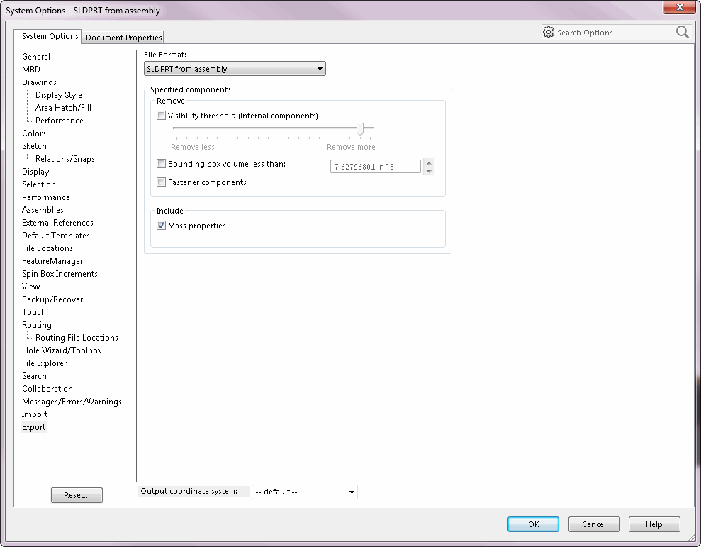

System Options > Export > SLDPRT from assembly
To display the dialog:
Click Tools > Options > System Options > Export > SLDPRT from assembly in File Format.
- or -
  1. Click File > Save As.
  2. In Save as type, select Part (*.prt, *.sldprt).
  3. Click Options.
Setting
Get/Set Methods
Return Value
or
<Value>
or
<OnFlag>
Comment
Specified components - Remove - Visibility threshold (internal components)
ISldWorks::GetUserPreferenceToggle(swUserPreferenceToggle_e.swASMSLDPRT_ExcludeComponentsByVisibility)
ISldWorks::SetUserPreferenceToggle(swUserPreferenceToggle_e.swASMSLDPRT_ExcludeComponentsByVisibility, <OnFlag>)
Boolean value
Specifies whether to remove from the export list those internal components whose visibility is less than the threshold specified by swASMSLDPRT_ExcludeComponentsByVisibilityThreshold
Specified components - Remove - Visibility threshold (internal components) - (slider amount)
ISldWorks::GetUserPreferenceDoubleValue(swUserPreferenceDoubleValue_e.swASMSLDPRT_ExcludeComponentsByVisibilityThreshold)
ISldWorks::SetUserPreferenceDoubleValue(swUserPreferenceDoubleValue_e.swASMSLDPRT_ExcludeComponentsByVisibilityThreshold, <Value>)
Double value in meters-cubed
Valid only if swASMSLDPRT_ExcludeComponentsByVisibility is set to true
Specified components - Remove - Bounding box volume less than:
ISldWorks::GetUserPreferenceToggle(swUserPreferenceToggle_e.swExcludeComponentsByBBoxVolume)
ISldWorks::SetUserPreferenceToggle(swUserPreferenceToggle_e.swExcludeComponentsByBBoxVolume, <OnFlag>)
Boolean value
Specifies whether to remove from the export list those components whose bounding box volumes are less than the threshold specified by swASMSLDPRT_ExcludeComponentsByBBoxVolumeThreshold
Specified components - Remove - Bounding box volume less than: (amount)
ISldWorks::GetUserPreferenceDoubleValue(swUserPreferenceDoubleValue_e.swASMSLDPRT_ExcludeComponentsByBBoxVolumeThreshold)
ISldWorks::SetUserPreferenceDoubleValue(swUserPreferenceDoubleValue_e.swASMSLDPRT_ExcludeComponentsByBBoxVolumeThreshold, <Value>)
Valid only if swExcludeComponentsByBBoxVolume is set to true
Specified components - Remove - Fastener components
ISldWorks::GetUserPreferenceToggle(swUserPreferenceToggle_e.swASMSLDPRT_ExcludeIfToolboxComponents)
ISldWorks::SetUserPreferenceToggle(swUserPreferenceToggle_e.swASMSLDPRT_ExcludeIfToolboxComponents, <OnFlag>)
Boolean value
Specifies whether to remove from the export list fastener components
Specified components - Include - Mass properties
ISldWorks::GetUserPreferenceToggle(swUserPreferenceToggle_e.swASMSLDPRT_IncludeMassProperties)
ISldWorks::SetUserPreferenceToggle(swUserPreferenceToggle_e.swASMSLDPRT_IncludeMassProperties, <OnFlag>)
Boolean value
Specifies whether to override the mass properties of the part with the mass properties from the assembly
