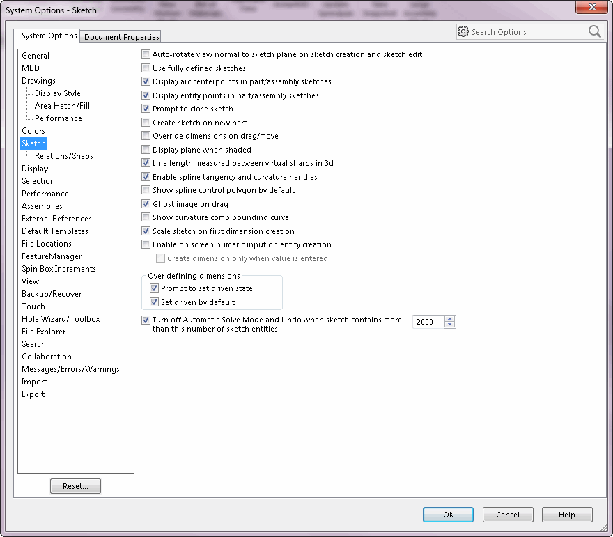

Setting
Get/Set Methods
Return Value
or
<OnFlag>
Comment
Auto-rotate view normal to sketch plane on sketch creation and sketch edit
ISldWorks::GetUserPreferenceToggle(swUserPreferenceToggle_e.swAutoNormalToSketchMode)
ISldWorks::SetUserPreferenceToggle(swUserPreferenceToggle_e.swAutoNormalToSketchMode, <OnFlag>)
Boolean value
Specifies whether to automatically rotate the view normal to the sketch plane when creating subsequent sketches; the very first sketch is always rotated normal to the sketch plane, even if this setting is set to false
Use fully defined sketches
ISldWorks::GetUserPreferenceToggle(swUserPreferenceToggle_e.swFullyConstrainedSketchMode)
ISldWorks::SetUserPreferenceToggle(swUserPreferenceToggle_e.swFullyConstrainedSketchMode, <OnFlag>)
Boolean value
Specifies whether sketches must be fully defined to create features
Display arc centerpoints in part/assembly sketches
ISldWorks::GetUserPreferenceToggle(swUserPreferenceToggle_e.swDisplayArcCenterPoints)
ISldWorks::SetUserPreferenceToggle(swUserPreferenceToggle_e.swDisplayArcCenterPoints, <OnFlag>)
Boolean value
Specifies whether to display arc center points in part and assembly sketches
Display entity points in part/assembly sketches
ISldWorks::GetUserPreferenceToggle(swUserPreferenceToggle_e.swDisplayEntityPoints)
ISldWorks::SetUserPreferenceToggle(swUserPreferenceToggle_e.swDisplayEntityPoints, <OnFlag>)
Boolean value
Specifies whether to display endpoints of sketch entities as filled circles in part and assembly sketches
Prompt to close sketch
ISldWorks::GetUserPreferenceToggle(swUserPreferenceToggle_e.swSketchPromptToCloseSketch)
ISldWorks::SetUserPreferenceToggle(swUserPreferenceToggle_e.swSketchPromptToCloseSketch, <OnFlag>)
Boolean value
Specifies whether to display a dialog when creating open-profile sketch and extruding sketch to create boss feature
Create sketch on new part
ISldWorks::GetUserPreferenceToggle(swUserPreferenceToggle_e.swSketchCreateSketchOnNewPart)
ISldWorks::SetUserPreferenceToggle(swUserPreferenceToggle_e.swSketchCreateSketchOnNewPart, <OnFlag>)
Boolean value
Specifies whether to open new part with active sketch on the Front Plane
Override dimensions on  drag/move
ISldWorks::GetUserPreferenceToggle(swUserPreferenceToggle_e.swSketchOverrideDimensionsOnDrag)
ISldWorks::SetUserPreferenceToggle(swUserPreferenceToggle_e.swSketchOverrideDimensionsOnDrag, <OnFlag>)
Boolean value
Specifies whether to override dimensions when dragging or moving sketch entities
Display plane when shaded
ISldWorks::GetUserPreferenceToggle(swUserPreferenceToggle_e.swSketchDisplayPlaneWhenShaded)
ISldWorks::SetUserPreferenceToggle(swUserPreferenceToggle_e.swSketchDisplayPlaneWhenShaded, <OnFlag>)
Boolean value
Specifies whether to display plane when editing sketch in Shaded With Edges or Shaded mode
Line length measured between virtual sharps in 3d
ISldWorks::GetUserPreferenceToggle(swUserPreferenceToggle_e.swSketchLineLengthVirtualSharp3d)
ISldWorks::SetUserPreferenceToggle(swUserPreferenceToggle_e.swSketchLineLengthVirtualSharp3d, <OnFlag>)
Boolean value
Specifies whether to measure line length between virtual sharps in 3D
Enable spline tangency and curvature handles
ISldWorks::GetUserPreferenceToggle(swUserPreferenceToggle_e.swDisplayAllSplineHandles)
ISldWorks::SetUserPreferenceToggle(swUserPreferenceToggle_e.swDisplayAllSplineHandles, <OnFlag>)
Boolean value
Specifies whether to display spline handles
Show spline control polygon by default
ISldWorks::GetUserPreferenceToggle(swUserPreferenceToggle_e.swSketchShowSplineControlPolygon)
ISldWorks::SetUserPreferenceToggle(swUserPreferenceToggle_e.swSketchShowSplineControlPolygon, <OnFlag>)
Boolean value
Specifies whether to show spline control polygon by default
Ghost image on drag
ISldWorks::GetUserPreferenceToggle(swUserPreferenceToggle_e.swSketchShadowDrag)
ISldWorks::SetUserPreferenceToggle(swUserPreferenceToggle_e.swSketchShadowDrag, <OnFlag>)
Boolean value
Specifies whether to enable ghost image on drag
Show curvature comb bounding curve
ISldWorks::GetUserPreferenceToggle(swUserPreferenceToggle_e.swSketchShowSplineOuterComb)
ISldWorks::SetUserPreferenceToggle(swUserPreferenceToggle_e.swSketchShowSplineOuterComb, <OnFlag>)
Boolean value
Specifies whether to show the outer spline comb
Scale sketch on first dimension creation
ISldWorks::GetUserPreferenceToggle(swUserPreferenceToggle_e.swScaleSketchOnFirstDimension)
ISldWorks::SetUserPreferenceToggle(swUserPreferenceToggle_e.swScaleSketchOnFirstDimension, <OnFlag>)
Boolean value Specifies whether to enable the automatic scaling that occurs when you specify the first dimension in a sketch
Enable on screen numeric input on entity creation
ISldWorks::GetUserPreferenceToggle(swUserPreferenceToggle_e.swSketchAcceptNumericInput)
ISldWorks::SetUserPreferenceToggle(swUserPreferenceToggle_e.swSketchAcceptNumericInput, <OnFlag>)
Boolean value
Specifies whether to enable on-screen numeric input when creating a sketch entity; adds the Add dimensions check box to the PropertyManager page of the sketch entity
Create dimension only when value is entered
ISldWorks::GetUserPreferenceToggle(swUserPreferenceToggle_e.swSketchCreateDimensionOnlyWhenEntered)
ISldWorks::SetUserPreferenceToggle(swUserPreferenceToggle_e.swSketchCreateDimensionOnlyWhenEntered, <OnFlag>)
Boolean value
Specifies whether to create dimensions only when values are entered; valid only if Enable on screen numeric input on entity creation is true

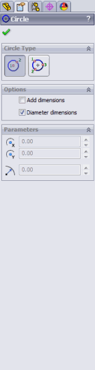

Corresponds to the Sketch Numeric Input button on the shortcut menu while sketching an entity
ISldWorks::GetUserPreferenceToggle(swUserPreferenceToggle_e.swAddDimensionsToSketchEntity)
ISldWorks::SetUserPreferenceToggle(swUserPreferenceToggle_e.swAddDimensionsToSketchEntity, <OnFlag>)
Boolean value
Specifies whether to enable on-screen numeric input while sketching an entity; adds Add dimensions check box to the PropertyManager page of the sketch entity
Corresponds to the Add Dimension button on the shortcut menu while sketching an entity and toggles the Add dimensions check box on that entity's PropertyManager page
ISldWorks::GetUserPreferenceToggle(swUserPreferenceToggle_e.swAddDimensionsToLineEntity)
ISldWorks::SetUserPreferenceToggle(swUserPreferenceToggle_e.swAddDimensionsToLineEntity, <OnFlag>)
ISldWorks::GetUserPreferenceToggle(swUserPreferenceToggle_e.swAddDimensionsToRectangleEntity)
SldWorks::SetUserPreferenceToggle(swUserPreferenceToggle_e.swAddDimensionsToRectangleEntity, <OnFlag>)
ISldWorks::GetUserPreferenceToggle(swUserPreferenceToggle_e.swAddDimensionsToArcEntity)
SldWorks::SetUserPreferenceToggle(swUserPreferenceToggle_e.swAddDimensionsToArcEntity, <OnFlag>)
ISldWorks::GetUserPreferenceToggle(swUserPreferenceToggle_e.swAddDimensionsToCircleEntity)
SldWorks::SetUserPreferenceToggle(swUserPreferenceToggle_e.swAddDimensionsToCircleEntity, <OnFlag>)
ISldWorks::GetUserPreferenceToggle(swUserPreferenceToggle_e.swAddDimensionsToSlotEntity)
SldWorks::SetUserPreferenceToggle(swUserPreferenceToggle_e.swAddDimensionsToSlotEntity, <OnFlag>)
Boolean value
swAddDimensionsToSketchEntity must be set to true for these enumerators to have an effect
Corresponds to the Sketch Dimension Driven button on the shortcut menu while sketching an entity
ISldWorks::GetUserPreferenceToggle(swUserPreferenceToggle_e.swAddDrivenDimensions)
SldWorks::SetUserPreferenceToggle(swUserPreferenceToggle_e.AddDrivenDimensions, <OnFlag>)
Boolean value
swAddDimensionsToSketchEntity must be set to true for this enumerator to have an effect
Over defining dimensions - Prompt to set driven state
ISldWorks::GetUserPreferenceToggle(swUserPreferenceToggle_e.swSketchOverdefiningDimsPromptToSetState)
ISldWorks::SetUserPreferenceToggle(swUserPreferenceToggle_e.swSketchOverdefiningDimsPromptToSetState, <OnFlag>)
Boolean value
Specifies whether to display dialog when adding over-defining dimension to sketch
Over defining dimensions - Set driven by default
ISldWorks::GetUserPreferenceToggle(swUserPreferenceToggle_e.swSketchOverdefiningDimsSetDrivenByDefault)
ISldWorks::SetUserPreferenceToggle(swUserPreferenceToggle_e.swSketchOverdefiningDimsSetDrivenByDefault, <OnFlag>)
Boolean value
Specifies whether to set dimension to be driven by default when adding an over-defining dimension to sketch
Turn off Automatic Solve Mode and Undo when sketch contains more than...
ISldWorks::GetUserPreferenceToggle(swUserPreferenceToggle_e.swSketchTurnOffAutomaticSolveModeAndUndo)
ISldWorks::SetUserPreferenceToggle(swUserPreferenceToggle_e.swSketchTurnOffAutomaticSolveModeAndUndo, <OnFlag>)
Boolean value
Specifies whether to turn off Automatic Solve Mode and Undo when sketch contains more than the specified number of sketch entities
this number of sketch entities
ISldWorks::GetUserPreferenceIntegerValue(swUserPreferenceIntegerValue_e.swSketch_Auto_Solve_Threshold) ISldWorks::SetUserPreferenceIntegerValue(swUserPreferenceIntegerValue_e.swSketch_Auto_Solve_Threshold, <Value>)
Integer value
The specified number of sketch entities mentioned in the previous comment
