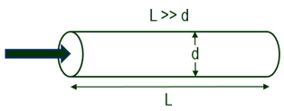

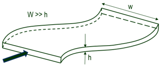

The shell analysis procedure uses two numerical approximations to model
laminar flow:
- Hele-Shaw flow for cavity domains
- Hagen-Poiseuille flow for runner domains

Hele-Shaw Flow for Shell Analysis |
Hagen-Poiseuille Flow for Shell Analysis |
Laminar flow between two parallel flat plates
separated
by
a small gap |
Laminar flow in a long cylindrical tube |
