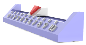

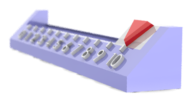

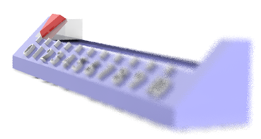

Example of differences in depth of field:
