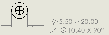

Define by Geometry or Hole Wizard
To switch between Hole Wizard and geometry definitions:
  1. Right-click the hole callout and select Display Options > Define by Geometry.
  2. To return to the Hole Wizard definition, right-click the hole callout and select Display Options > Define by Hole Wizard.
    These menu items are available only when holes have been created using the Hole Wizard.
