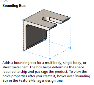

large tooltips provide expanded information for tools in a toolbar. Some enhanced tooltips
include images or animations.
For example, the Bounding Box large
tooltip provides information about viewing the bounding box properties and includes
an image of a bounding box.
![](yhc1557756249599.image)
