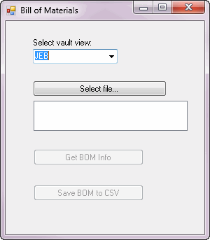

// Postconditions:
// 1. Opens the Bill of Materials dialog box.
//    a. Select a vault_name view.
//    b. Click Select file.
//    c. In the Select File dialog:
//       1. Click the assembly specified in Preconditions step 6.
//       2. Click Open.
//    d. Click Get BOM Info.
//       Displays message boxes containing:
//       * Information about all named BOMs of the assembly.
//       * Version information for the named BOMs.
//       * Information about all BOM layouts in the vault.
//       * Row and column information about a BOM view in the BOM layout
//         for the selected assembly in its @ configuration.
//    e. Click OK in each message box.
    f. Click Save BOM to CSV.
//       Saves the BOM to c:\temp\SavedBOM.csv.
// 2. Close the Bill of Materials dialog box.
3. Verify that c:\temp\SavedBOM.csv is created.

            this.VaultsComboBox.TabIndex = 1;
            // SelectFiles
            this.SelectFiles.Location = new System.Drawing.Point(39, 85);
            this.SelectFiles.Name = "SelectFiles";
            this.SelectFiles.Size = new System.Drawing.Size(191, 23);
            this.SelectFiles.TabIndex = 2;
            this.SelectFiles.Text = "Select file...";
            this.SelectFiles.UseVisualStyleBackColor = true;
            this.SelectFiles.Click += new System.EventHandler(this.SelectFiles_Click);
            // File1List
            this.File1List.FormattingEnabled = true;
            this.File1List.HorizontalScrollbar = true;
            this.File1List.Location = new System.Drawing.Point(40, 114);
            this.File1List.Name = "File1List";
            this.File1List.SelectionMode = System.Windows.Forms.SelectionMode.MultiExtended;
            this.File1List.Size = new System.Drawing.Size(220, 43);
            this.File1List.TabIndex = 4;
            // GetBOM
            this.GetBOM.Location = new System.Drawing.Point(40, 183);
            this.GetBOM.Name = "GetBOM";
            this.GetBOM.Size = new System.Drawing.Size(157, 23);
            this.GetBOM.TabIndex = 6;
            this.GetBOM.Text = "Get BOM";
            this.GetBOM.UseVisualStyleBackColor = true;
            this.GetBOM.Enabled = false;
            this.GetBOM.Click += new System.EventHandler(this.GetBOM_Click);
            // OpenFileDialog1
            this.OpenFileDialog1.FileName = "OpenFileDialog1";
            this.OpenFileDialog1.Title = "Select File";
            // SaveBOM
            this.SaveBOM.Location = new System.Drawing.Point(40, 252);
            this.SaveBOM.Name = "SaveBOM";
            this.SaveBOM.Size = new System.Drawing.Size(157, 23);
            this.SaveBOM.TabIndex = 7;
            this.SaveBOM.Text = "Save BOM to CSV";
            this.SaveBOM.UseVisualStyleBackColor = true;
            this.SaveBOM.Enabled = false;
            this.SaveBOM.Click += new System.EventHandler(this.SaveBOM_Click);
            // Form1
            this.AutoScaleDimensions = new System.Drawing.SizeF(6F, 13F);
            this.AutoScaleMode = System.Windows.Forms.AutoScaleMode.Font;
            this.ClientSize = new System.Drawing.Size(284, 363);
            this.Controls.Add(this.SaveBOM);
            this.Controls.Add(this.GetBOM);
            this.Controls.Add(this.File1List);
            this.Controls.Add(this.SelectFiles);
            this.Controls.Add(this.VaultsComboBox);
            this.Controls.Add(this.VaultsLabel);
            this.Name = "Form1";
            this.Text = "Bill of Materials";
            this.Load += new System.EventHandler(this.Form1_Load);
            this.ResumeLayout(false);
            this.PerformLayout();
        internal System.Windows.Forms.Label VaultsLabel;
        internal System.Windows.Forms.ComboBox VaultsComboBox;
        internal System.Windows.Forms.Button SelectFiles;
        internal System.Windows.Forms.ListBox File1List;
        internal System.Windows.Forms.Button GetBOM;
        internal System.Windows.Forms.OpenFileDialog OpenFileDialog1;
        #endregion
        private System.Windows.Forms.Button SaveBOM;
