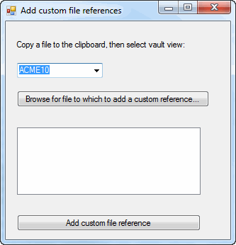

Add Custom File Reference Example (C#)
This example shows how to add a custom file reference to a file in the vault.
NOTE: If using the primary interop assembly provided with SOLIDWORKS PDM Professional, see Using .NET Framework 4.0 in Stand-alone Applications.
// Preconditions:
// 1. Start Microsoft Visual Studio 2010.
//    a. Click File > New > Project > Visual C# > Windows Forms Application.
//    b. Type CustRefCSharp in Name.
//    c. Click Browse and navigate to the folder where to create
//       the project.
//    d. Click OK
//    e. Click Show All Files in the Solution Explorer toolbar and expand
//       Form1.cs in the Solution Explorer.
//    f. Create a form similar to the form shown above and change:
//       1. Top label to VaultsLabel.
//       2. Combo box to VaultsComboBox.
//       3. Browse button to BrowseButton.
//       4. List box to CustRefListBox.
//       5. Add custom file reference button to AddCustomFileReference.
//    g. Replace the code in Form1.cs with this code.
//    h. Replace the code in Form1.Designer.cs with this code.
// 2. Add EPDM.Interop.epdm.dll as a reference (right-click the project
//    name in the Solution Explorer, click Add Reference, click
//    Assemblies > Framework in the left-side panel, browse to the top folder of
//    your SOLIDWORKS PDM Professional installation, locate and click
//    EPDM.Interop.epdm.dll, click Open, click Add, and click Close).
// 3. Right-click EPDM.Interop.epdm in References, click Properties, and set
//    Embed Interop Types to False to handle methods that pass arrays of
//    structures.
// 4. Click Debug > Start Debugging or press F5.
// Postconditions:
// 1. The Add custom references dialog displays.
// 2. Select a vault.
// 3. Click Browse for file to which to add custom reference
//    locate and click a file in the vault, and click Open.
//    The file is checked out.
// 4. In a view of the selected vault, right-click a file and click Copy.
// 5. In the Add custom references dialog, click Add custom file reference.
//    The file that was copied to the clipboard is added as a custom
//    reference to the checked-out file.
// 6. In the Create File References dialog, click OK.
//    The file is checked in.
// 7. In the Edit User-Defined File References dialog, click OK.
// 8. Close the Add custom references dialog.

        private void InitializeComponent()
            this.VaultsLabel = new System.Windows.Forms.Label();
            this.VaultsComboBox = new System.Windows.Forms.ComboBox();
            this.BrowseButton = new System.Windows.Forms.Button();
            this.CustRefListBox = new System.Windows.Forms.ListBox();
            this.AddCustomFileReference = new System.Windows.Forms.Button();
            this.CustRefOpenFileDialog = new System.Windows.Forms.OpenFileDialog();
            this.SuspendLayout();
            // VaultsLabel
            this.VaultsLabel.AutoSize = true;
            this.VaultsLabel.Location = new System.Drawing.Point(13, 26);
            this.VaultsLabel.Name = "VaultsLabel";
            this.VaultsLabel.Size = new System.Drawing.Size(244, 13);
            this.VaultsLabel.TabIndex = 0;
            this.VaultsLabel.Text = "Copy a file to the clipboard, then select vault view:";
            // VaultsComboBox
            this.VaultsComboBox.FormattingEnabled = true;
            this.VaultsComboBox.Location = new System.Drawing.Point(16, 59);
            this.VaultsComboBox.Name = "VaultsComboBox";
            this.VaultsComboBox.Size = new System.Drawing.Size(121, 21);
            this.VaultsComboBox.TabIndex = 1;
            // BrowseButton
            this.BrowseButton.Location = new System.Drawing.Point(16, 98);
            this.BrowseButton.Name = "BrowseButton";
            this.BrowseButton.Size = new System.Drawing.Size(271, 23);
            this.BrowseButton.TabIndex = 3;
            this.BrowseButton.Text = "Browse for file to which to add a custom reference...";
            this.BrowseButton.UseVisualStyleBackColor = true;
            this.BrowseButton.Click += new System.EventHandler(this.BrowseButton_Click);
            // CustRefListBox
            this.CustRefListBox.FormattingEnabled = true;
            this.CustRefListBox.Location = new System.Drawing.Point(16, 150);
            this.CustRefListBox.Name = "CustRefListBox";
            this.CustRefListBox.Size = new System.Drawing.Size(259, 95);
            this.CustRefListBox.TabIndex = 4;
            // AddCustomFileReference
            this.AddCustomFileReference.Location = new System.Drawing.Point(16, 273);
            this.AddCustomFileReference.Name = "AddCustomFileReference";
            this.AddCustomFileReference.Size = new System.Drawing.Size(259, 23);
            this.AddCustomFileReference.TabIndex = 5;
            this.AddCustomFileReference.Text = "Add custom file reference";
            this.AddCustomFileReference.UseVisualStyleBackColor = true;
            this.AddCustomFileReference.Click += new System.EventHandler(this.AddCustomFileReference_Click);
            // Form1
            this.AutoScaleDimensions = new System.Drawing.SizeF(6F, 13F);
            this.AutoScaleMode = System.Windows.Forms.AutoScaleMode.Font;
            this.ClientSize = new System.Drawing.Size(317, 308);
            this.Controls.Add(this.AddCustomFileReference);
            this.Controls.Add(this.CustRefListBox);
            this.Controls.Add(this.BrowseButton);
            this.Controls.Add(this.VaultsComboBox);
            this.Controls.Add(this.VaultsLabel);
            this.Name = "Form1";
            this.Text = "Add custom file references";
            this.Load += new System.EventHandler(this.FileReferencesCSharp_Load);
            this.ResumeLayout(false);
            this.PerformLayout();
        #endregion
