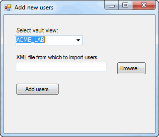

//  2. Start Microsoft Visual Studio 2010.
//     a. Click File > New > Project > C# > Windows Forms Application.
//     b. Type AddUsersCSharp in Name.
//     c. Click Browse and navigate to the folder where to
//        create the project.
//     d. Click OK
//     e. Click Show All Files in the Solution Explorer toolbar and
//        expand Form1.cs in the Solution Explorer.
//     f. Create a form similar to the form shown above and change:
//        1. Top label to VaultsLabel.
//        2. Combo box to VaultsCombobox.
//        3. Second label to XmlLabel.
//        4. Text box to XmlTextBox.
//        5. Browse button to BrowseButton.
//        6. Add users button to AddUsersButton.
//     g. Replace the code in Form1.cs with this code.
//     h. Replace the code in Form1.Designer.cs with this code.

//  1. Displays a dialog.
//  2. Select a vault.
//  3. Click Browse, locate and select User.xml, and click Open.
//  4. Click Add users.
//     A message box is displayed showing the names of the new users added
//     to the vault.
//  5. Click OK to close the message box.
//  6. Close the dialog.

            this.AddUsersButton.Click += new System.EventHandler(this.AddUsersButton_Click);
            // Form1
            this.AutoScaleDimensions = new System.Drawing.SizeF(6F, 13F);
            this.AutoScaleMode = System.Windows.Forms.AutoScaleMode.Font;
            this.ClientSize = new System.Drawing.Size(284, 262);
            this.Controls.Add(this.AddUsersButton);
            this.Controls.Add(this.BrowseButton);
            this.Controls.Add(this.XmlTextBox);
            this.Controls.Add(this.XmlLabel);
            this.Controls.Add(this.VaultsComboBox);
            this.Controls.Add(this.VaultsLabel);
            this.Name = "Form1";
            this.Text = "Add new users";
            this.Load += new System.EventHandler(this.AddUsers_Load);
            this.ResumeLayout(false);
            this.PerformLayout();
        #endregion
        private System.Windows.Forms.Label VaultsLabel;
        private System.Windows.Forms.ComboBox VaultsComboBox;
        private System.Windows.Forms.Label XmlLabel;
        private System.Windows.Forms.TextBox XmlTextBox;
        private System.Windows.Forms.Button BrowseButton;
        private System.Windows.Forms.Button AddUsersButton;
        private System.Windows.Forms.OpenFileDialog XmlOpenFileDialog;
