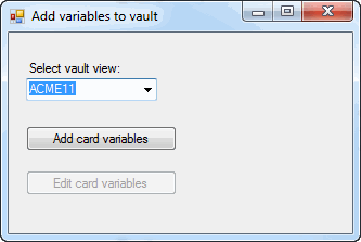

// Postconditions:
// 1. Displays the Add variables to vault dialog box.
// 2. Select a vault view.
// 3. Click Add card variables
//    a. Adds two card variables, MyNewVar and MySecondVar, to the vault.
//    b. Displays a message box with the IDs of the new variables.
//    c. Click OK.
// 4. Click Edit card variables.
//    a. Displays the Edit Variables dialog box.
//    b. Click OK.
//    c. Displays a message box.
//    d. Click OK.
// 5. Close the Add variables to vault dialog box.
