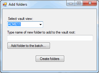

// Postconditions:
// 1. Displays the Add folders dialog box.
//    a. Select a vault view.
//    b. Type the name of a new folder to create in the root folder
//       of the vault.
//    c. Click Add folder to the batch.
//       1. Displays a message that the folder is added to the batch.
//       2. Click OK.
// 2. Repeat steps 1b-c repeatedly to add more folders to the batch.
// 3. Click Create folders.
//    a. Displays a message that the folder is created.
//    b. Click OK in each message box.
// 4. Close the Add folders dialog box.

            //VaultsLabel
            this.VaultsLabel.AutoSize = true;
            this.VaultsLabel.Location = new System.Drawing.Point(13, 26);
            this.VaultsLabel.Name = "VaultsLabel";
            this.VaultsLabel.Size = new System.Drawing.Size(94, 13);
            this.VaultsLabel.TabIndex = 0;
            this.VaultsLabel.Text = " Select vault view:";
            //VaultsComboBox
            this.VaultsComboBox.FormattingEnabled = true;
            this.VaultsComboBox.Location = new System.Drawing.Point(16, 42);
            this.VaultsComboBox.Name = "VaultsComboBox";
            this.VaultsComboBox.Size = new System.Drawing.Size(121, 21);
            this.VaultsComboBox.TabIndex = 1;
            //AddFolders
            this.AddFolders.Location = new System.Drawing.Point(16, 112);
            this.AddFolders.Name = "AddFolders";
            this.AddFolders.Size = new System.Drawing.Size(145, 23);
            this.AddFolders.TabIndex = 3;
            this.AddFolders.Text = "Add folder to the batch...";
            this.AddFolders.UseVisualStyleBackColor = true;
            this.AddFolders.Click +=new System.EventHandler(AddFolders_Click);
            //CreateFolders
            this.CreateFolders.Location = new System.Drawing.Point(111, 156);
            this.CreateFolders.Name = "CreateFolders";
            this.CreateFolders.Size = new System.Drawing.Size(98, 23);
            this.CreateFolders.TabIndex = 5;
            this.CreateFolders.Text = "Create folders";
            this.CreateFolders.UseVisualStyleBackColor = true;
            this.CreateFolders.Click +=new System.EventHandler(CreateFolders_Click);
            //TextBox1
            this.TextBox1.Location = new System.Drawing.Point(16, 88);
            this.TextBox1.Name = "TextBox1";
            this.TextBox1.Size = new System.Drawing.Size(289, 20);
            this.TextBox1.TabIndex = 6;
            //Label1
            this.Label1.AutoSize = true;
            this.Label1.Location = new System.Drawing.Point(13, 72);
            this.Label1.Name = "Label1";
            this.Label1.Size = new System.Drawing.Size(237, 13);
            this.Label1.TabIndex = 7;
            this.Label1.Text = "Type name of new folder to add to the vault root:";
            //Form1
            this.AutoScaleDimensions = new System.Drawing.SizeF(6f, 13f);
            this.AutoScaleMode = System.Windows.Forms.AutoScaleMode.Font;
            this.ClientSize = new System.Drawing.Size(317, 208);
            this.Controls.Add(this.Label1);
            this.Controls.Add(this.TextBox1);
            this.Controls.Add(this.CreateFolders);
            this.Controls.Add(this.AddFolders);
            this.Controls.Add(this.VaultsComboBox);
            this.Controls.Add(this.VaultsLabel);
            this.Name = "Form1";
            this.Text = "Add folders";
            this.Load += new System.EventHandler(this.Form1_Load);
            this.ResumeLayout(false);
            this.PerformLayout();
