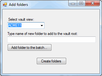

' Postconditions:
' 1. Displays the Add folders dialog box.
'    a. Select a vault view.
'    b. Type the name of a new folder to create in the root folder
'       of the vault.
'    c. Click Add folder to the batch.
'       1. Displays a message that the folder is added to the batch.
'       2. Click OK.
' 2. Repeat steps 1b-c repeatedly to add more folders to the batch.
' 3. Click Create folders.
'    a. Displays a message that the folder is created.
'    b. Click OK in each message box.
' 4. Close the Add folders dialog box.

        Me.Label1.Text = "Type name of new folder to add to the vault root:"
