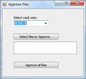

// 1. The Approve Files dialog box displays.
//    a. Select a vault view.
//    b. Click Select files to approve.
//    c. In the Select File dialog:
//       1. Select vault files in the Waiting for Approval state.
//       2. Click Open.
//    d. Click Approve all files.
// 2. Click OK in the Do Transition dialog box.
//    The selected files change to the Approved state using the Passed Approval
//    transition.
// 3. Close the Approve Files dialog box.

            this.VaultsLabel = new System.Windows.Forms.Label();
            this.VaultsComboBox = new System.Windows.Forms.ComboBox();
            this.Transition = new System.Windows.Forms.Button();
            this.File1List = new System.Windows.Forms.ListBox();
            this.BatchChange = new System.Windows.Forms.Button();
            this.OpenFileDialog1 = new System.Windows.Forms.OpenFileDialog();
            this.SuspendLayout();
            //VaultsLabel
            this.VaultsLabel.AutoSize = true;
            this.VaultsLabel.Location = new System.Drawing.Point(36, 24);
            this.VaultsLabel.Name = "VaultsLabel";
            this.VaultsLabel.Size = new System.Drawing.Size(91, 13);
            this.VaultsLabel.TabIndex = 0;
            this.VaultsLabel.Text = "Select vault view:";
            //VaultsComboBox
            this.VaultsComboBox.FormattingEnabled = true;
            this.VaultsComboBox.Location = new System.Drawing.Point(39, 40);
            this.VaultsComboBox.Name = "VaultsComboBox";
            this.VaultsComboBox.Size = new System.Drawing.Size(121, 21);
            this.VaultsComboBox.TabIndex = 1;
            //Transition
            this.Transition.Location = new System.Drawing.Point(39, 85);
            this.Transition.Name = "Transition";
            this.Transition.Size = new System.Drawing.Size(158, 23);
            this.Transition.TabIndex = 2;
            this.Transition.Text = "Select files to approve...";
            this.Transition.UseVisualStyleBackColor = true;
            this.Transition.Click += new System.EventHandler(this.Transition_Click);
            //File1List
            this.File1List.FormattingEnabled = true;
            this.File1List.HorizontalScrollbar = true;
            this.File1List.Location = new System.Drawing.Point(40, 114);
            this.File1List.Name = "File1List";
            this.File1List.SelectionMode = System.Windows.Forms.SelectionMode.MultiExtended;
            this.File1List.Size = new System.Drawing.Size(220, 43);
            this.File1List.TabIndex = 4;
            //BatchChange
            this.BatchChange.Location = new System.Drawing.Point(40, 183);
            this.BatchChange.Name = "BatchChange";
            this.BatchChange.Size = new System.Drawing.Size(157, 23);
            this.BatchChange.TabIndex = 6;
            this.BatchChange.Text = "Approve all files";
            this.BatchChange.UseVisualStyleBackColor = true;
            this.BatchChange.Click += new System.EventHandler(this.BatchChange_Click);
            //OpenFileDialog1
            this.OpenFileDialog1.FileName = "OpenFileDialog1";
            this.OpenFileDialog1.Multiselect = true;
            this.OpenFileDialog1.Title = "Select File";
            //Form1
            this.AutoScaleDimensions = new System.Drawing.SizeF(6f, 13f);
            this.AutoScaleMode = System.Windows.Forms.AutoScaleMode.Font;
            this.ClientSize = new System.Drawing.Size(284, 235);
            this.Controls.Add(this.BatchChange);
            this.Controls.Add(this.File1List);
            this.Controls.Add(this.Transition);
            this.Controls.Add(this.VaultsComboBox);
            this.Controls.Add(this.VaultsLabel);
            this.Name = "Form1";
            this.Text = "Approve Files";
            this.Load += new System.EventHandler(this.Form1_Load);
            this.ResumeLayout(false);
            this.PerformLayout();
