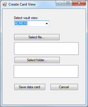

1. Displays the Create Card View dialog box.
// 2. Select the vault view in which you created a folder and
//    checked out a file.
// 3. Click either:
//    a. Select file.
//    b. In the Select File dialog:
//       1. Click the file checked out in Preconditions step 5.
//       2. Click Open.
//       3. Inspect the message box, then click OK.
//    c. In the file data card, modify a field.
//    d. Click Save data card.
//    e. Check in the file and inspect its data card.
//       - or -
//    a. Select folder.
//    b. In the Select Folder dialog, select the vault folder created
//       in Preconditions step 4 and click OK.
//    c. Inspect the message box, then click OK.
//    d. In the folder data card, click the Edit Values tab.
//    e. Modify a field.
//    f. Click Save data card.
//    g. Inspect the folder card in the vault.
// 4. Close the Create Card View dialog box.

            this.VaultsLabel = new System.Windows.Forms.Label();
            this.VaultsComboBox = new System.Windows.Forms.ComboBox();
            this.SelectFile = new System.Windows.Forms.Button();
            this.File1List = new System.Windows.Forms.ListBox();
            this.SaveCard = new System.Windows.Forms.Button();
            this.OpenFileDialog1 = new System.Windows.Forms.OpenFileDialog();
            this.SelectFolder = new System.Windows.Forms.Button();
            this.Folder1List = new System.Windows.Forms.ListBox();
            this.Cancel = new System.Windows.Forms.Button();
            this.SuspendLayout();
            //VaultsLabel
            this.VaultsLabel.AutoSize = true;
            this.VaultsLabel.Location = new System.Drawing.Point(36, 24);
            this.VaultsLabel.Name = "VaultsLabel";
            this.VaultsLabel.Size = new System.Drawing.Size(91, 13);
            this.VaultsLabel.TabIndex = 0;
            this.VaultsLabel.Text = "Select vault view:";
            //VaultsComboBox
            this.VaultsComboBox.FormattingEnabled = true;
            this.VaultsComboBox.Location = new System.Drawing.Point(39, 40);
            this.VaultsComboBox.Name = "VaultsComboBox";
            this.VaultsComboBox.Size = new System.Drawing.Size(121, 21);
            this.VaultsComboBox.TabIndex = 1;
            //SelectFile
            this.SelectFile.Location = new System.Drawing.Point(39, 85);
            this.SelectFile.Name = "SelectFile";
            this.SelectFile.Size = new System.Drawing.Size(157, 23);
            this.SelectFile.TabIndex = 2;
            this.SelectFile.Text = "Select file...";
            this.SelectFile.UseVisualStyleBackColor = true;
            this.SelectFile.Click += new System.EventHandler(SelectFile_Click);
            //File1List
            this.File1List.FormattingEnabled = true;
            this.File1List.HorizontalScrollbar = true;
            this.File1List.Location = new System.Drawing.Point(40, 114);
            this.File1List.Name = "File1List";
            this.File1List.SelectionMode = System.Windows.Forms.SelectionMode.MultiExtended;
            this.File1List.Size = new System.Drawing.Size(220, 43);
            this.File1List.TabIndex = 4;
            //SaveCard
            this.SaveCard.Location = new System.Drawing.Point(40, 255);
            this.SaveCard.Name = "SaveCard";
            this.SaveCard.Size = new System.Drawing.Size(107, 23);
            this.SaveCard.TabIndex = 6;
            this.SaveCard.Text = "Save data card";
            this.SaveCard.UseVisualStyleBackColor = true;
            this.SaveCard.Click +=new System.EventHandler(SaveCard_Click);
            //OpenFileDialog1
            this.OpenFileDialog1.FileName = "OpenFileDialog1";
            this.OpenFileDialog1.Title = "Select File";
            //SelectFolder
            this.SelectFolder.Location = new System.Drawing.Point(40, 163);
            this.SelectFolder.Name = "SelectFolder";
            this.SelectFolder.Size = new System.Drawing.Size(157, 23);
            this.SelectFolder.TabIndex = 7;
            this.SelectFolder.Text = "Select folder...";
            this.SelectFolder.UseVisualStyleBackColor = true;
            this.SelectFolder.Click += new System.EventHandler(this.SelectFolder_Click);
            //Folder1List
            this.Folder1List.FormattingEnabled = true;
            this.Folder1List.Location = new System.Drawing.Point(39, 192);
            this.Folder1List.Name = "Folder1List";
            this.Folder1List.Size = new System.Drawing.Size(220, 43);
            this.Folder1List.TabIndex = 8;
            //Cancel
            this.Cancel.Location = new System.Drawing.Point(163, 255);
            this.Cancel.Name = "Cancel";
            this.Cancel.Size = new System.Drawing.Size(96, 23);
            this.Cancel.TabIndex = 9;
            this.Cancel.Text = "Cancel";
            this.Cancel.UseVisualStyleBackColor = true;
            this.Cancel.Click += new System.EventHandler(this.Form1_Load);
            //Form1
            this.AutoScaleDimensions = new System.Drawing.SizeF(6f, 13f);
            this.AutoScaleMode = System.Windows.Forms.AutoScaleMode.Font;
            this.ClientSize = new System.Drawing.Size(284, 327);
            this.Controls.Add(this.Cancel);
            this.Controls.Add(this.Folder1List);
            this.Controls.Add(this.SelectFolder);
            this.Controls.Add(this.SaveCard);
            this.Controls.Add(this.File1List);
            this.Controls.Add(this.SelectFile);
            this.Controls.Add(this.VaultsComboBox);
            this.Controls.Add(this.VaultsLabel);
            this.Name = "Form1";
            this.Text = "Create Card View";
            this.Load += new System.EventHandler(this.Form1_Load);
            this.ResumeLayout(false);
            this.PerformLayout();
        internal System.Windows.Forms.Label VaultsLabel;
        internal System.Windows.Forms.ComboBox VaultsComboBox;
        internal System.Windows.Forms.Button SelectFile;
        internal System.Windows.Forms.ListBox File1List;
        internal System.Windows.Forms.Button SaveCard;
        internal System.Windows.Forms.OpenFileDialog OpenFileDialog1;
        internal System.Windows.Forms.Button SelectFolder;
        internal System.Windows.Forms.ListBox Folder1List;
        internal System.Windows.Forms.Button Cancel;
