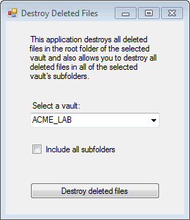

This example shows how to create an application that displays a form in which a user can select the vault in whose root folder and subfolders all deleted files will be permanently destroyed. The user must have permission to delete files.

' Preconditions:
'  1. Start Microsoft Visual Studio.
'  2. Click File > New > Project > Visual Basic > Windows Forms Application.
'  3. Type the name of your project in Name.
'  4. Click the Browse button and browse to the folder where to create the project.
'  5. Click OK.
'  6. Create a form similar to the form shown above and change:
'     a. Second label to VaultsLabel.
'     b. Combo box to VaultsComboBox.
'     c. Check box to CheckBox_Recursive.
'     d. Button to DestroyDeletedItemsButton.
'  7. Replace the code in Form1.vb with this code.
'  8. Replace the code in Form1.Designer.vb with this code.
'  9. Add EPDM.Interop.epdm.dll as a reference (right-click the project
'     name in the Solution Explorer, click Add Reference, click
'     Framework in the left-side panel, browse to the top folder of your
'     SOLIDWORKS PDM Professional installation, locate and click
'     EPDM.Interop.epdm.dll
, click Open, click Add, and click Close).
' 10. Right-click EPDM.Interop.epdm in References, click Properties, and set
'     Embed Interop Types
to False to handle methods that pass arrays of
'     structures.
' 11. Switch back to Form1.vb code window.
' 12. Click Debug > Start Debugging or press F5.
' Postconditions:
'  1. Displays the Destroy Deleted Files dialog.
'  2. Select a vault.
'  3. Optionally select the Include all subfolders check box.
'  4. Click the Destroy deleted files button.
'     A message box pops up informing you that:
'     * No deleted files were found to destroy.
'       - or -
'     * The deleted files were destroyed.
'  5. Click OK in the message box.
'  6. Close the Destroy Deleted Files dialog.

        Me.CheckBox_Recursive.Text = "Include all subfolders"

        Me.DestroyDeletedItemsButton.Text = "Destroy deleted files"

        Me.Label1.Text = "This application destroys all deleted files in the root folder of the selected va" & _
            "ult and also allows you to destroy all deleted files in all of the selected vaul" & _
            "t's subfolders."

        Me.VaultsLabel.Text = "Select a vault:"
