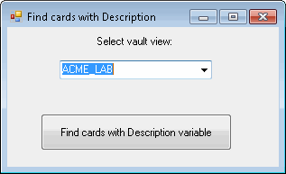

This example shows how to find the data cards in your vault that have a Description variable.

//  2. Click File > New > Project > C# > Windows Forms Application.
//  3. Type CardsVariableCSharp in Name.
//  4. Click the Browse button and browse to the folder where to create the project.
//  5. Click OK
//  6. Create a form similar to the form shown above and change:
//     a. Label to VaultsLabel.
//     b. Combo box to VaultsComboBox
//     c. Button to FindCardsButton.
//  7. Replace the code in Form1.cs with this code.
//  8. Replace the code in Form1.Designer.cs with this code.

// Postconditions:
//  1. Displays a dialog.
//  2. Select a vault.
//  3. Click the Find cards with Description variable button.
//     The cards in your vault with a Description variable are
//     printed to the Immediate window.
//  4. Examine the Immediate window.
//  5. Close the dialog.
