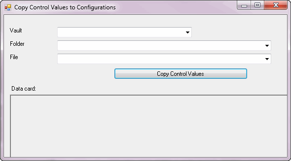

// Postconditions:
// 1. Displays the Copy Control Values to Configurations dialog box.
//    a. Select a vault view.
//       Folder is set to the root folder.
//    b. Select a file that has a data card with two or more configurations.
//    c. Displays the data card.
//    d. Click Copy Control Values.
//       Copies the value set in Preconditions step 5 to all configurations.
// 2. Close the dialog box.
// 3. Inspect the control values in all of the configurations of the data card.

        private void DoBtn_Click(object sender, EventArgs e)
            int i = FoldersComboBox.SelectedIndex;
            IEdmFolder5 edmFolder = oFoldersArray[i];
            i = FilesComboBox.SelectedIndex;
            IEdmFile14 edmFile = (IEdmFile14)oFileArray[i];
            List<string> cfgList = new List<string>();
            EdmStrLst5 configLst =  edmFile.GetConfigurations();
            IEdmPos5 cfgPos = configLst.GetHeadPosition();
            while(!cfgPos.IsNull)
                string configName = configLst.GetNext(cfgPos);
                cfgList.Add(configName);
            foreach (string configName in cfgList)
                // Move variable values from "@" to configName
                edmFile.GenerateDefaultConfigValues(edmFile.ID, "@", configName, ""false);
            ShowDataCard();

            this.AutoScaleDimensions = new System.Drawing.SizeF(6F, 13F);
            this.AutoScaleMode = System.Windows.Forms.AutoScaleMode.Font;
            this.ClientSize = new System.Drawing.Size(913, 670);
            this.Controls.Add(this.label4);
            this.Controls.Add(this.label3);
            this.Controls.Add(this.label2);
            this.Controls.Add(this.label1);
            this.Controls.Add(this.FilesComboBox);
            this.Controls.Add(this.FoldersComboBox);
            this.Controls.Add(this.VaultsComboBox);
            this.Controls.Add(this.CardPanel);
            this.Controls.Add(this.DoBtn);
            this.Name = "MainForm";
            this.Text = "Copy Control Values to Configurations";
            this.Load += new System.EventHandler(this.MainForm_Load);
            this.ResumeLayout(false);
            this.PerformLayout();
        #endregion
        private System.Windows.Forms.Button DoBtn;
        private System.Windows.Forms.Panel CardPanel;
        private System.Windows.Forms.ComboBox VaultsComboBox;
        private System.Windows.Forms.ComboBox FoldersComboBox;
        private System.Windows.Forms.ComboBox FilesComboBox;
        private System.Windows.Forms.Label label1;
        private System.Windows.Forms.Label label2;
        private System.Windows.Forms.Label label3;
        private System.Windows.Forms.Label label4;
