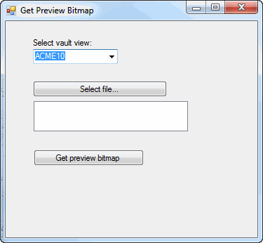

//  1. Displays the Get Preview Bitmap dialog box.
//     a. Select a vault view.
//     b. Click Select file.
//     c. In the Select File dialog:
//        1. Click a DWG file inside the vault.
//        2. Click Open.
//     d. Click Get preview bitmap.
//        Form1 displays the preview bitmap of the selected file.

            this.Text = "Get Preview Bitmap";
