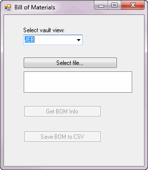

' Postconditions:
' 1. Opens the Bill of Materials dialog box.
'    a. Select a vault_name view.
'    b. Click Select file.
'    c. In the Select File dialog:
'       1. Click the assembly specified in Preconditions step 5.
'       2. Click Open.
'    d. Click Get BOM Info.
'       Displays message boxes containing:
'       * Information about all named BOMs of the assembly.
'       * Version information for the named BOMs.
'       * Information about all BOM layouts in the vault.
'       * Row and column information about a BOM view in the BOM layout
'         for the selected assembly in its @ configuration.
'    e. Click OK in each message box.
'    f. Click Save BOM to CSV.
'       Saves the BOM to c:\temp\SavedBOM.csv.
' 2. Close the Bill of Materials dialog box.
' 3. Verify that c:\temp\SavedBOM.csv is created.

        Me.VaultsComboBox.Location = New System.Drawing.Point(39, 40)
        Me.VaultsComboBox.Name = "VaultsComboBox"
        Me.VaultsComboBox.Size = New System.Drawing.Size(121, 21)
        Me.VaultsComboBox.TabIndex = 1
        'SelectFiles
        Me.SelectFiles.Location = New System.Drawing.Point(39, 85)
        Me.SelectFiles.Name = "SelectFiles"
        Me.SelectFiles.Size = New System.Drawing.Size(191, 23)
        Me.SelectFiles.TabIndex = 2
        Me.SelectFiles.Text = "Select file..."
        Me.SelectFiles.UseVisualStyleBackColor = True
        'File1List
        Me.File1List.FormattingEnabled = True
        Me.File1List.HorizontalScrollbar = True
        Me.File1List.Location = New System.Drawing.Point(40, 114)
        Me.File1List.Name = "File1List"
        Me.File1List.SelectionMode = System.Windows.Forms.SelectionMode.MultiExtended
        Me.File1List.Size = New System.Drawing.Size(220, 43)
        Me.File1List.TabIndex = 4
        'GetBOM
        Me.GetBOM.Enabled = False
        Me.GetBOM.Location = New System.Drawing.Point(40, 183)
        Me.GetBOM.Name = "GetBOM"
        Me.GetBOM.Size = New System.Drawing.Size(157, 23)
        Me.GetBOM.TabIndex = 6
        Me.GetBOM.Text = "Get BOM Info"
        Me.GetBOM.UseVisualStyleBackColor = True
        'OpenFileDialog1
        Me.OpenFileDialog1.FileName = "OpenFileDialog1"
        Me.OpenFileDialog1.Title = "Select File"
        'SaveBOM
        Me.SaveBOM.Enabled = False
        Me.SaveBOM.Location = New System.Drawing.Point(40, 234)
        Me.SaveBOM.Name = "SaveBOM"
        Me.SaveBOM.Size = New System.Drawing.Size(157, 23)
        Me.SaveBOM.TabIndex = 7
        Me.SaveBOM.Text = "Save BOM to CSV"
        Me.SaveBOM.UseVisualStyleBackColor = True
        'Form1
        Me.AutoScaleDimensions = New System.Drawing.SizeF(6.0!, 13.0!)
        Me.AutoScaleMode = System.Windows.Forms.AutoScaleMode.Font
        Me.ClientSize = New System.Drawing.Size(284, 305)
        Me.Controls.Add(Me.SaveBOM)
        Me.Controls.Add(Me.GetBOM)
        Me.Controls.Add(Me.File1List)
        Me.Controls.Add(Me.SelectFiles)
        Me.Controls.Add(Me.VaultsComboBox)
        Me.Controls.Add(Me.VaultsLabel)
        Me.Name = "Form1"
        Me.Text = "Bill of Materials"
        Me.ResumeLayout(False)
        Me.PerformLayout()
