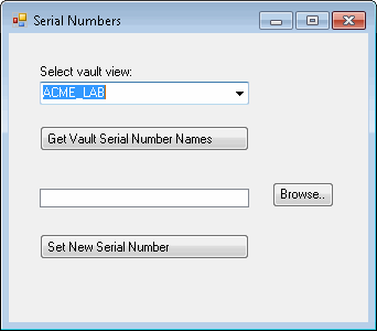

// Postconditions:
//  1. Displays the Serial Numbers dialog box.
//  2. Select a vault view.
//  3. Click Get Vault Serial Number Names.
//  4. Displays a message box containing the names of the serial number
//     generators for the selected vault.
//  5. Click OK to close the message box.
//  6. Click Browse.
//     a. Click a checked-out file in the selected vault whose
//        data card has a Part Number variable.
//     b. Click Open.
//     The selected file's path and file name appear in the Serial
//     Numbers dialog box.
//  7. Click Set New Serial Number
//  8. Displays a message box verifying that the Part Number was
//     set and shows the value of that Part Number.
//     NOTES:
//     * The value set for the Part Number is the next number in the first
//       serial number generator shown in the message box displayed in
//       step 3.
//     * Make note of the Part Number.
//  9. Click OK to close the message box.
// 10. Check in the file whose Part Number was set in step 7, then check out the
//     file.
// 11. Examine the Part Number on the data card of the checked-out file.
// 12. Close the Serial Numbers dialog box.

			this.NewButton.UseVisualStyleBackColor = true;
            		this.NewButton.Click += new System.EventHandler(this.NewButton_Click);
			//Form1
			this.AutoScaleDimensions = new System.Drawing.SizeF(6f, 13f);
			this.AutoScaleMode = System.Windows.Forms.AutoScaleMode.Font;
			this.ClientSize = new System.Drawing.Size(326, 262);
			this.Controls.Add(this.NewButton);
			this.Controls.Add(this.BrowseButton);
			this.Controls.Add(this.FileListBox);
			this.Controls.Add(this.Button1);
			this.Controls.Add(this.VaultsComboBox);
			this.Controls.Add(this.VaultsLabel);
			this.Name = "Form1";
			this.Text = "Serial Numbers";
            		this.Load += new System.EventHandler(this.Form1_Load);
			this.ResumeLayout(false);
			this.PerformLayout();
	#endregion
	internal System.Windows.Forms.Label VaultsLabel;
	internal System.Windows.Forms.ComboBox VaultsComboBox;
	internal System.Windows.Forms.Button Button1;
	internal System.Windows.Forms.ListBox FileListBox;
	internal System.Windows.Forms.Button BrowseButton;
	internal System.Windows.Forms.Button NewButton;
	internal System.Windows.Forms.OpenFileDialog OpenFileDialog1;
