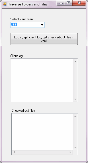

Traverse Folders and Files in Vault Example (C#)
This example shows how to recursively traverse all of the
folders and files in a vault.

// Postconditions:
// 1. Displays a Traverse
Folders and Files dialog.
// 2. Select a vault.
// 3. Click Log
in, get client log, get checked-out files in vault.
// 4. Displays a message box with the vault type.
// 5. Click OK.
// 6. Populates Client log and Checked-out files.
// 7. Close the dialog.
