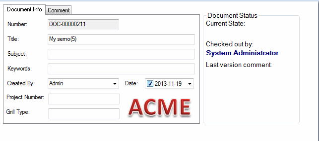

    Now you can connect the add-in serial number to controls in your file data cards.
  11. Click Cards > File Cards, double-click Text Card, and click the Title control.
  12. In the Default value group box on the Edit-box properties panel, click Serial number and select the serial number that you created in step 7.
  13.
  14. Save the card and exit the Card Editor.
  15. Create a new text file by right-clicking in a File Explorer vault view and clicking New > Text Document.
    The file data card displays a serial number in Title of the newly added file.
