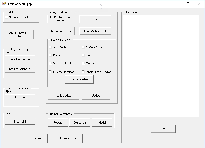

SOLIDWORKS API Help
3D Interconnect to Import Third-Party Native CAD Files Example (C#)
This example demonstrates how to use the 3D Interconnect API to import and access third-party non-native CAD data.
// Preconditions:
//  1. Ensure Tools > Options > System Options > Enable VSTA VERSION 3.0 is
//     selected.
//  2. Open a new C# macro in SOLIDWORKS. Save it with project name
//     Interconnect to a convenient location on your machine.
//  3. Add references, SolidWorks.interop.sldworks and
//     SolidWorks.Interop.swconst.
//  4. Open SolidWorksMacro.cs.
//  5. Replace everything in SolidWorksMacro.cs with this code.
//  6. Right-click the Interconnect project in Solution Explorer and select
//     Add > Windows Form.
//  7. Save the form with name, InterConnectingApp.cs.
//  8. Open InterConnectingApp.Designer.cs and replace everything in it
//     with this code.
//  9. Open the InterConnectingApp.cs form. Right-click on the design
//     and select View Code.
// 10. Replace everything in InterConnectingApp.cs with this code.
// 11. Compile and save the project.
// Postconditions:
//  1. Opens the InterConnectingApp dialog.
//  2. Select 3D Interconnect checkbox to enable 3D Interconnect.
//  3. Click one of:
//     a. Load File
//     b. Open SOLIDWORKS File
//  4. If you clicked 3b, then click one of:
//     a. Insert as Feature (if you opened a part)
//     b. Insert as Component (if you opened an assembly)
//  5. Select the third-party non-native CAD file to insert. Click OK.
//  6. Select the top-level imported item in the FeatureManager design tree.
//  7. Exercise the buttons in the Editing Third-Party File Data group box.
//     Observe the Information text box. Click Clear to refresh it.
//  8. Click Break Link to break the link between the imported
//     feature/component and its original file.
//  9. Click Feature, Component, or Model to list all external references.
// 10. Click Close File to close the current files.
// 11. Click Close Application to close the InterConnectingApp dialog.

            this.chkSurfaceBodies.Name = "chkSurfaceBodies";
            this.chkSurfaceBodies.Size = new System.Drawing.Size(98, 17);
            this.chkSurfaceBodies.TabIndex = 1;
            this.chkSurfaceBodies.Text = "Surface Bodies";
            this.chkSurfaceBodies.UseVisualStyleBackColor = true;
            // chkPlanes
            this.chkPlanes.AutoSize = true;
            this.chkPlanes.Location = new System.Drawing.Point(6, 63);
            this.chkPlanes.Name = "chkPlanes";
            this.chkPlanes.Size = new System.Drawing.Size(58, 17);
            this.chkPlanes.TabIndex = 2;
            this.chkPlanes.Text = "Planes";
            this.chkPlanes.UseVisualStyleBackColor = true;
            // chkAxes
            this.chkAxes.AutoSize = true;
            this.chkAxes.Location = new System.Drawing.Point(141, 63);
            this.chkAxes.Name = "chkAxes";
            this.chkAxes.Size = new System.Drawing.Size(49, 17);
            this.chkAxes.TabIndex = 3;
            this.chkAxes.Text = "Axes";
            this.chkAxes.UseVisualStyleBackColor = true;
            // chkSketchedAndCurves
            this.chkSketchedAndCurves.AutoSize = true;
            this.chkSketchedAndCurves.Location = new System.Drawing.Point(6, 95);
            this.chkSketchedAndCurves.Name = "chkSketchedAndCurves";
            this.chkSketchedAndCurves.Size = new System.Drawing.Size(129, 17);
            this.chkSketchedAndCurves.TabIndex = 4;
            this.chkSketchedAndCurves.Text = "Sketches And Curves";
            this.chkSketchedAndCurves.UseVisualStyleBackColor = true;
            // btnSetParams
            this.btnSetParams.Location = new System.Drawing.Point(73, 154);
            this.btnSetParams.Name = "btnSetParams";
            this.btnSetParams.Size = new System.Drawing.Size(117, 34);
            this.btnSetParams.TabIndex = 12;
            this.btnSetParams.Text = "Set Parameters";
            this.btnSetParams.UseVisualStyleBackColor = true;
            this.btnSetParams.Click += new System.EventHandler(this.btnSetParams_Click);
            // chkMaterial
            this.chkMaterial.AutoSize = true;
            this.chkMaterial.Location = new System.Drawing.Point(141, 95);
            this.chkMaterial.Name = "chkMaterial";
            this.chkMaterial.Size = new System.Drawing.Size(63, 17);
            this.chkMaterial.TabIndex = 6;
            this.chkMaterial.Text = "Material";
            this.chkMaterial.UseVisualStyleBackColor = true;
            // chkCustomProps
            this.chkCustomProps.AutoSize = true;
            this.chkCustomProps.Location = new System.Drawing.Point(6, 131);
            this.chkCustomProps.Name = "chkCustomProps";
            this.chkCustomProps.Size = new System.Drawing.Size(111, 17);
            this.chkCustomProps.TabIndex = 5;
            this.chkCustomProps.Text = "Custom Properties";
            this.chkCustomProps.UseVisualStyleBackColor = true;
            // chkIgnoreHiddenBodies
            this.chkIgnoreHiddenBodies.AutoSize = true;
            this.chkIgnoreHiddenBodies.Location = new System.Drawing.Point(141, 131);
            this.chkIgnoreHiddenBodies.Name = "chkIgnoreHiddenBodies";
            this.chkIgnoreHiddenBodies.Size = new System.Drawing.Size(128, 17);
            this.chkIgnoreHiddenBodies.TabIndex = 7;
            this.chkIgnoreHiddenBodies.Text = "Ignore Hidden Bodies";
            this.chkIgnoreHiddenBodies.UseVisualStyleBackColor = true;
            // btn_IsInterFeat
            this.btn_IsInterFeat.Location = new System.Drawing.Point(6, 19);
            this.btn_IsInterFeat.Name = "btn_IsInterFeat";
            this.btn_IsInterFeat.Size = new System.Drawing.Size(111, 34);
            this.btn_IsInterFeat.TabIndex = 15;
            this.btn_IsInterFeat.Text = "Is 3D Interconnect Feature?";
            this.btn_IsInterFeat.UseVisualStyleBackColor = true;
            this.btn_IsInterFeat.Click += new System.EventHandler(this.btn_IsInterFeat_Click);
            // btnUpdate
            this.btnUpdate.Location = new System.Drawing.Point(147, 335);
            this.btnUpdate.Name = "btnUpdate";
            this.btnUpdate.Size = new System.Drawing.Size(117, 34);
            this.btnUpdate.TabIndex = 14;
            this.btnUpdate.Text = "Update";
            this.btnUpdate.UseVisualStyleBackColor = true;
            this.btnUpdate.Click += new System.EventHandler(this.btnUpdate_Click);
            // btnAuthorInfo
            this.btnAuthorInfo.Location = new System.Drawing.Point(138, 70);
            this.btnAuthorInfo.Name = "btnAuthorInfo";
            this.btnAuthorInfo.Size = new System.Drawing.Size(132, 31);
            this.btnAuthorInfo.TabIndex = 10;
            this.btnAuthorInfo.Text = "Show Authoring Info";
            this.btnAuthorInfo.UseVisualStyleBackColor = true;
            this.btnAuthorInfo.Click += new System.EventHandler(this.btnAuthorInfo_Click);
            // btnIsUpdateNeeded
            this.btnIsUpdateNeeded.Location = new System.Drawing.Point(7, 335);
            this.btnIsUpdateNeeded.Name = "btnIsUpdateNeeded";
            this.btnIsUpdateNeeded.Size = new System.Drawing.Size(130, 34);
            this.btnIsUpdateNeeded.TabIndex = 13;
            this.btnIsUpdateNeeded.Text = "Needs Update?";
            this.btnIsUpdateNeeded.UseVisualStyleBackColor = true;
            this.btnIsUpdateNeeded.Click += new System.EventHandler(this.btnIsUpdateNeeded_Click);
            // btnGetParams
            this.btnGetParams.Location = new System.Drawing.Point(8, 68);
            this.btnGetParams.Name = "btnGetParams";
            this.btnGetParams.Size = new System.Drawing.Size(111, 34);
            this.btnGetParams.TabIndex = 11;
            this.btnGetParams.Text = "Show Parameters";
            this.btnGetParams.UseVisualStyleBackColor = true;
            this.btnGetParams.Click += new System.EventHandler(this.btnGetParams_Click);
            // btnGetRefFileName
            this.btnGetRefFileName.Location = new System.Drawing.Point(138, 20);
            this.btnGetRefFileName.Name = "btnGetRefFileName";
            this.btnGetRefFileName.Size = new System.Drawing.Size(132, 33);
            this.btnGetRefFileName.TabIndex = 8;
            this.btnGetRefFileName.Text = "Show Reference File";
            this.btnGetRefFileName.UseVisualStyleBackColor = true;
            this.btnGetRefFileName.Click += new System.EventHandler(this.btnGetRefFileName_Click);
            // groupBox5
            this.groupBox5.Controls.Add(this.btnClear);
            this.groupBox5.Controls.Add(this.richTextBox1);
            this.groupBox5.Location = new System.Drawing.Point(499, 12);
            this.groupBox5.Name = "groupBox5";
            this.groupBox5.Size = new System.Drawing.Size(325, 548);
            this.groupBox5.TabIndex = 4;
            this.groupBox5.TabStop = false;
            this.groupBox5.Text = "Information";
            // btnClear
            this.btnClear.Location = new System.Drawing.Point(120, 473);
            this.btnClear.Name = "btnClear";
            this.btnClear.Size = new System.Drawing.Size(103, 33);
            this.btnClear.TabIndex = 1;
            this.btnClear.Text = "Clear";
            this.btnClear.UseVisualStyleBackColor = true;
            this.btnClear.Click += new System.EventHandler(this.btnClear_Click);
            // richTextBox1
            this.richTextBox1.BorderStyle = System.Windows.Forms.BorderStyle.None;
            this.richTextBox1.Location = new System.Drawing.Point(6, 20);
            this.richTextBox1.Name = "richTextBox1";
            this.richTextBox1.Size = new System.Drawing.Size(313, 422);
            this.richTextBox1.TabIndex = 0;
            this.richTextBox1.Text = "";
            // groupBox6
            this.groupBox6.Controls.Add(this.btnBreakLink);
            this.groupBox6.Location = new System.Drawing.Point(12, 430);
            this.groupBox6.Name = "groupBox6";
            this.groupBox6.Size = new System.Drawing.Size(148, 68);
            this.groupBox6.TabIndex = 5;
            this.groupBox6.TabStop = false;
            this.groupBox6.Text = "Link";
            // btnBreakLink
            this.btnBreakLink.Location = new System.Drawing.Point(7, 30);
            this.btnBreakLink.Name = "btnBreakLink";
            this.btnBreakLink.Size = new System.Drawing.Size(126, 23);
            this.btnBreakLink.TabIndex = 0;
            this.btnBreakLink.Text = "Break Link";
            this.btnBreakLink.UseVisualStyleBackColor = true;
            this.btnBreakLink.Click += new System.EventHandler(this.btnBreakLink_Click);
            // groupBox7
            this.groupBox7.Controls.Add(this.btnModelExtRefs);
            this.groupBox7.Controls.Add(this.btnComponentExtRef);
            this.groupBox7.Controls.Add(this.btnFeatureExtRefs);
            this.groupBox7.Location = new System.Drawing.Point(188, 432);
            this.groupBox7.Name = "groupBox7";
            this.groupBox7.Size = new System.Drawing.Size(283, 66);
            this.groupBox7.TabIndex = 6;
            this.groupBox7.TabStop = false;
            this.groupBox7.Text = "External References";
            // btnModelExtRefs
            this.btnModelExtRefs.Location = new System.Drawing.Point(188, 26);
            this.btnModelExtRefs.Name = "btnModelExtRefs";
            this.btnModelExtRefs.Size = new System.Drawing.Size(85, 34);
            this.btnModelExtRefs.TabIndex = 2;
            this.btnModelExtRefs.Text = "Model";
            this.btnModelExtRefs.UseVisualStyleBackColor = true;
            this.btnModelExtRefs.Click += new System.EventHandler(this.btnModelExtRefs_Click);
            // btnComponentExtRef
            this.btnComponentExtRef.Location = new System.Drawing.Point(97, 26);
            this.btnComponentExtRef.Name = "btnComponentExtRef";
            this.btnComponentExtRef.Size = new System.Drawing.Size(85, 34);
            this.btnComponentExtRef.TabIndex = 1;
            this.btnComponentExtRef.Text = "Component";
            this.btnComponentExtRef.UseVisualStyleBackColor = true;
            this.btnComponentExtRef.Click += new System.EventHandler(this.btnComponentExtRef_Click);
            // btnFeatureExtRefs
            this.btnFeatureExtRefs.Location = new System.Drawing.Point(7, 26);
            this.btnFeatureExtRefs.Name = "btnFeatureExtRefs";
            this.btnFeatureExtRefs.Size = new System.Drawing.Size(85, 34);
            this.btnFeatureExtRefs.TabIndex = 0;
            this.btnFeatureExtRefs.Text = "Feature";
            this.btnFeatureExtRefs.UseVisualStyleBackColor = true;
            this.btnFeatureExtRefs.Click += new System.EventHandler(this.btnFeatureExtRefs_Click);
            // btnFormOpenFile
            this.btnFormOpenFile.Location = new System.Drawing.Point(12, 92);
            this.btnFormOpenFile.Name = "btnFormOpenFile";
            this.btnFormOpenFile.Size = new System.Drawing.Size(126, 39);
            this.btnFormOpenFile.TabIndex = 7;
            this.btnFormOpenFile.Text = "Open SOLIDWORKS File";
            this.btnFormOpenFile.UseVisualStyleBackColor = true;
            this.btnFormOpenFile.Click += new System.EventHandler(this.btnFormOpenFile_Click);
            // btnCloseFile
            this.btnCloseFile.Location = new System.Drawing.Point(92, 521);
            this.btnCloseFile.Name = "btnCloseFile";
            this.btnCloseFile.Size = new System.Drawing.Size(103, 39);
            this.btnCloseFile.TabIndex = 8;
            this.btnCloseFile.Text = "Close File";
            this.btnCloseFile.UseVisualStyleBackColor = true;
            this.btnCloseFile.Click += new System.EventHandler(this.btnCloseFile_Click);
            // btnCloseApp
            this.btnCloseApp.Location = new System.Drawing.Point(236, 521);
            this.btnCloseApp.Name = "btnCloseApp";
            this.btnCloseApp.Size = new System.Drawing.Size(103, 39);
            this.btnCloseApp.TabIndex = 9;
            this.btnCloseApp.Text = "Close Application";
            this.btnCloseApp.UseVisualStyleBackColor = true;
            this.btnCloseApp.Click += new System.EventHandler(this.btnCloseApp_Click);
            // InterConnectingApp
            this.AutoScaleDimensions = new System.Drawing.SizeF(6F, 13F);
            this.AutoScaleMode = System.Windows.Forms.AutoScaleMode.Font;
            this.ClientSize = new System.Drawing.Size(842, 579);
            this.Controls.Add(this.btnCloseApp);
            this.Controls.Add(this.btnCloseFile);
            this.Controls.Add(this.btnFormOpenFile);
            this.Controls.Add(this.groupBox7);
            this.Controls.Add(this.groupBox6);
            this.Controls.Add(this.groupBox5);
            this.Controls.Add(this.groupBox4);
            this.Controls.Add(this.groupBox3);
            this.Controls.Add(this.groupBox2);
            this.Controls.Add(this.groupBox1);
            this.FormBorderStyle = System.Windows.Forms.FormBorderStyle.FixedSingle;
            this.Name = "InterConnectingApp";
            this.Text = "InterConnectingApp";
            this.groupBox1.ResumeLayout(false);
            this.groupBox1.PerformLayout();
            this.groupBox2.ResumeLayout(false);
            this.groupBox3.ResumeLayout(false);
            this.groupBox4.ResumeLayout(false);
            this.groupBox8.ResumeLayout(false);
            this.groupBox8.PerformLayout();
            this.groupBox5.ResumeLayout(false);
            this.groupBox6.ResumeLayout(false);
            this.groupBox7.ResumeLayout(false);
            this.ResumeLayout(false);
        #endregion
        private System.Windows.Forms.GroupBox groupBox1;
        private System.Windows.Forms.CheckBox chkTurnInterconnectOnOff;
        private System.Windows.Forms.GroupBox groupBox2;
        private System.Windows.Forms.Button btnInsertComponent;
        private System.Windows.Forms.Button btnInsertFeat;
        private System.Windows.Forms.GroupBox groupBox3;
        private System.Windows.Forms.Button btnLoadFile;
        private System.Windows.Forms.GroupBox groupBox4;
        private System.Windows.Forms.Button btnAuthorInfo;
        private System.Windows.Forms.Button btnGetRefFileName;
        private System.Windows.Forms.CheckBox chkIgnoreHiddenBodies;
        private System.Windows.Forms.CheckBox chkMaterial;
        private System.Windows.Forms.CheckBox chkCustomProps;
        private System.Windows.Forms.CheckBox chkSketchedAndCurves;
        private System.Windows.Forms.CheckBox chkAxes;
        private System.Windows.Forms.CheckBox chkPlanes;
        private System.Windows.Forms.CheckBox chkSurfaceBodies;
        private System.Windows.Forms.CheckBox chkSolidBodies;
        private System.Windows.Forms.Button btnUpdate;
        private System.Windows.Forms.Button btnIsUpdateNeeded;
        private System.Windows.Forms.Button btnSetParams;
        private System.Windows.Forms.Button btnGetParams;
        private System.Windows.Forms.GroupBox groupBox5;
        private System.Windows.Forms.RichTextBox richTextBox1;
        private System.Windows.Forms.Button btnClear;
        private System.Windows.Forms.GroupBox groupBox6;
        private System.Windows.Forms.Button btnBreakLink;
        private System.Windows.Forms.GroupBox groupBox7;
        private System.Windows.Forms.Button btnModelExtRefs;
        private System.Windows.Forms.Button btnComponentExtRef;
        private System.Windows.Forms.Button btnFeatureExtRefs;
        private System.Windows.Forms.Button btnFormOpenFile;
        private System.Windows.Forms.Button btnCloseFile;
        private System.Windows.Forms.Button btnCloseApp;
        private System.Windows.Forms.Button btn_IsInterFeat;
        private System.Windows.Forms.GroupBox groupBox8;
//InterConnectingApp.cs:
using System;
using System.Collections.Generic;
using System.ComponentModel;
using System.Data;
using System.Drawing;
using System.Linq;
using System.Text;
using System.Threading.Tasks;
using System.Windows.Forms;
using System.IO;
using SolidWorks.Interop.sldworks;
using SolidWorks.Interop.swconst;
namespace Interconnect
    public partial class InterConnectingApp : Form
        public SldWorks m_SwApp = default(SldWorks);
        public ModelDoc2 swModelDoc = default(ModelDoc2);
        public PartDoc swPart = default(PartDoc);
        public AssemblyDoc swAssembly = default(AssemblyDoc);
        public Feature swFeat = default(Feature);
        public Component2 swComp = default(Component2);
        public Import3DInterconnectData swIntrConData = default(Import3DInterconnectData);
        public SelectionMgr swSelMgr = default(SelectionMgr);
        public string strCurModelDoc = string.Empty;
        public int m_LongStatus;
        public int m_Warning;
        public bool m_BoolStatus;
        public StringBuilder strEventData;
        delegate void StringArgReturningVoidDelegate(string text);
        public InterConnectingApp()
            InitializeComponent();
        public void RunInterconnectApplication(SldWorks swApp)
            m_SwApp = swApp;
            swModelDoc = (ModelDoc2)m_SwApp.ActiveDoc;
            if (swModelDoc != null)
                strCurModelDoc = swModelDoc.GetPathName();
                string strExt = Path.GetExtension(strCurModelDoc);
                if (strExt.ToLower() == ".sldprt")
                    swPart = (PartDoc)swModelDoc;
                else if (strExt.ToLower() == ".sldasm")
                    swAssembly = (AssemblyDoc)swModelDoc;
            AttachEventHandlers();
            strEventData = new StringBuilder();
            Application.Run(this);
        public void AttachEventHandlers()
            AttachSWEvents();
        public void AttachSWEvents()
            m_SwApp.Begin3DInterconnectTranslationNotify += M_SwApp_Begin3DInterconnectTranslationNotify;
            m_SwApp.End3DInterconnectTranslationNotify += M_SwApp_End3DInterconnectTranslationNotify;
        public int M_SwApp_End3DInterconnectTranslationNotify(string FileName)
            strEventData = strEventData.Append("3D Interconnect translation finished");
            strEventData = strEventData.Append("\r\n");
            return 0;
        public int M_SwApp_Begin3DInterconnectTranslationNotify(string FileName)
            strEventData = strEventData.Append("3D Interconnect translation started");
            return 0;
        public int BeginTranslationNotify()
            int i = 0;
            return i;
        //Information field
        public void SetRichTextBoxVal(string strText)
            try
                if (this.richTextBox1.InvokeRequired == true)
                    StringArgReturningVoidDelegate d = new StringArgReturningVoidDelegate(SetRichTextBoxVal);
                    this.Invoke(d, new object[] { strText });
                else
                    this.richTextBox1.Text = strText;
            catch (Exception e)
                MessageBox.Show(e.Message);
//Turn 3D Interconnect on and off
        private void chkTurnInterconnectOnOff_CheckStateChanged(object sender, EventArgs e)
            if (chkTurnInterconnectOnOff.CheckState == CheckState.Checked)
                m_SwApp.SetUserPreferenceToggle((int)swUserPreferenceToggle_e.swMultiCAD_Enable3DInterconnect, true);
            else if (chkTurnInterconnectOnOff.CheckState == CheckState.Unchecked)
                m_SwApp.SetUserPreferenceToggle((int)swUserPreferenceToggle_e.swMultiCAD_Enable3DInterconnect, false);
        //Open a SOLIDWORKS document
        private void btnFormOpenFile_Click(object sender, EventArgs e)
            OpenFileDialog m_fileOpenDlg = new OpenFileDialog();
            m_fileOpenDlg.Filter = "SolidWorks File | *.sldprt; *.sldasm";
            m_fileOpenDlg.Title = "Open SolidWorks File";
            string FilePath = string.Empty;
            string FileExtension = string.Empty;
            if (m_fileOpenDlg.ShowDialog() == DialogResult.OK)
                FilePath = m_fileOpenDlg.FileName;
                FileExtension = Path.GetExtension(FilePath);
                if (FileExtension.ToLower() == ".sldasm")
                    swModelDoc = (ModelDoc2)m_SwApp.OpenDoc6(FilePath, (int)swDocumentTypes_e.swDocASSEMBLY, (int)swOpenDocOptions_e.swOpenDocOptions_Silent, "", ref m_LongStatus, ref m_Warning);
                else if (FileExtension.ToLower() == ".sldprt")
                    swModelDoc = (ModelDoc2)m_SwApp.OpenDoc6(FilePath, (int)swDocumentTypes_e.swDocPART, (int)swOpenDocOptions_e.swOpenDocOptions_Silent, "", ref m_LongStatus, ref m_Warning);
         //Insert third-party feature into the current part
        private void btnInsertFeat_Click(object sender, EventArgs e)
            if (swModelDoc != null) {
                if (swModelDoc.GetType() == (int)swDocumentTypes_e.swDocPART)
                    if (swPart != null)
                        //m_fileOpenDlg.Filter = "Parasolid (*.x_t; *.x_b; *.xmt_txt; *.xmt_bin) | IGES (*.igs; *.iges) | ACIS (*.sat) | STEP (*.step; *.stp) | VDAFS (*.vda) | VRML (*.wrl) | STL (*.stl) | CGR (*.cgr) | 3MF (*.3mf) | Rhino (*.3dm)";
                        m_fileOpenDlg.Title = "Insert Third-Party Feature";
                            swFeat = (Feature)swPart.InsertImportedFeature(FilePath, out m_LongStatus);
                            if (swFeat == null)
                                SetRichTextBoxVal(m_LongStatus.ToString());
        //Insert third-party component into the current assembly
        private void btnInsertComponent_Click(object sender, EventArgs e)
                if (swModelDoc.GetType() == (int)swDocumentTypes_e.swDocASSEMBLY)
                    if (swAssembly != null)
                        m_fileOpenDlg.Filter = "All Files | *.*";
                        m_fileOpenDlg.Title = "Insert Third-Party Component";
                            Object InsertedComp = null;
                            int retVal = (int)swAssembly.InsertImportedComponent(FilePath, 0, 0, 0, out InsertedComp);
                            swComp = (InsertedComp != null) ? (Component2)InsertedComp : null;
                            if (swComp == null)
                                SetRichTextBoxVal(retVal.ToString());
                            else
                                SetRichTextBoxVal(strEventData.ToString());
                                strEventData.Length = 0;
//Open a third-party file into a new document
        private void btnLoadFile_Click(object sender, EventArgs e)
            m_fileOpenDlg.Title = "Open Third-Party File";
                swModelDoc = m_SwApp.LoadFile4(FilePath, "r", null, ref m_LongStatus);
                string strLoadFileError = "";
                if (m_LongStatus != 0)
                    strLoadFileError = "File load error as defined in swFileLoadError_e: " + m_LongStatus.ToString();
                StringBuilder strLoadFileInfo = new StringBuilder();
                strLoadFileInfo = strLoadFileInfo.Append(strLoadFileError);
                strLoadFileInfo = strLoadFileInfo.Append("\r\n");
                strLoadFileInfo = strLoadFileInfo.Append(strEventData.ToString());
                SetRichTextBoxVal(strLoadFileInfo.ToString());
                    string strModelName = swModelDoc.GetPathName();
                    string strExt = Path.GetExtension(strModelName);
        private void btnCloseApp_Click(object sender, EventArgs e)
            Application.Exit();
        private void btnCloseFile_Click(object sender, EventArgs e)
            m_SwApp.CloseDoc(strCurModelDoc);
        //Get whether the selected feature is a 3D Interconnect feature
        private void btn_IsInterFeat_Click(object sender, EventArgs e)
                swSelMgr = (SelectionMgr)swModelDoc.SelectionManager;
                m_BoolStatus = false;
                    swFeat = (Feature)swSelMgr.GetSelectedObject6(1, -1);
                    if (swFeat != null)
                        m_BoolStatus = swFeat.Is3DInterconnectFeature;
                    else
                        MessageBox.Show("No feature selected");
                else if (swModelDoc.GetType() == (int)swDocumentTypes_e.swDocASSEMBLY)
                    object objSelected = swSelMgr.GetSelectedObject6(1, -1);
                    string strSelectedObjName;
                    string sType;
                    int iType;
                    swSelMgr.GetSelectByIdSpecification(objSelected, out strSelectedObjName, out sType, out iType);
                    if (strSelectedObjName.Length > 0)
                        string[] vNames = strSelectedObjName.Split('@');
                        swFeat = (Feature)swAssembly.FeatureByName(vNames[0]);
                        if (swFeat == null && (iType != 22 || iType != 76))
                        if (swFeat != null)
                        else
                if (m_BoolStatus == false)
                    SetRichTextBoxVal("This is NOT a 3D Interconnect feature");
                else
                    SetRichTextBoxVal("This is a 3D Interconnect feature");
        private void btnClear_Click(object sender, EventArgs e)
            SetRichTextBoxVal("");
        //Show the selected item's reference file name
        private void btnGetRefFileName_Click(object sender, EventArgs e)
                if ((swFeat != null) & (swFeat.Is3DInterconnectFeature))
                    object DataObj = null;
                    swFeat.GetImportedFeatureParameters(out DataObj);
                    swIntrConData = (Import3DInterconnectData)DataObj;
                    if (swIntrConData != null)
                        SetRichTextBoxVal(swIntrConData.GetReferencedFileName());
        //Show the selected item's authoring application
        private void btnAuthorInfo_Click(object sender, EventArgs e)
                        SetRichTextBoxVal(swIntrConData.GetAuthoringInfo());
        //Show the import settings
        private void btnGetParams_Click(object sender, EventArgs e)
            StringBuilder strBld = new StringBuilder();
                    string strSelectedObjName, sType;
                    int iType;
                        if (swIntrConData.SolidBodies == true)
                            strBld = strBld.Append("Solid Bodies"); strBld = strBld.Append("\r\n");
                        if (swIntrConData.SurfaceBodies == true)
                            strBld = strBld.Append("Surface Bodies"); strBld = strBld.Append("\r\n");
                        if (swIntrConData.Planes == true)
                            strBld = strBld.Append("Planes"); strBld = strBld.Append("\r\n");
                        if (swIntrConData.Axes == true)
                            strBld = strBld.Append("Axes"); strBld = strBld.Append("\r\n");
                        if (swIntrConData.SketchesAndCurves == true)
                            strBld = strBld.Append("Sketches And Curves"); strBld = strBld.Append("\r\n");
                        if (swIntrConData.CustomProperties == true)
                            strBld = strBld.Append("Custom Properties"); strBld = strBld.Append("\r\n");
                        if (swIntrConData.Material == true)
                            strBld = strBld.Append("Material"); strBld = strBld.Append("\r\n");
                        if (swIntrConData.IgnoreHiddenEntities == true)
                            strBld = strBld.Append("Ignore Hidden Entities"); strBld = strBld.Append("\r\n");
                        SetRichTextBoxVal(strBld.ToString());
//Set new import settings
        private void btnSetParams_Click(object sender, EventArgs e)
                    int iType;
                        if (chkSolidBodies.CheckState == CheckState.Checked)
                            swIntrConData.SolidBodies = true;
                        else
                            swIntrConData.SolidBodies = false;
                        if (chkSurfaceBodies.CheckState == CheckState.Checked)
                            swIntrConData.SurfaceBodies = true;
                        else
                            swIntrConData.SurfaceBodies = false;
                        if (chkPlanes.CheckState == CheckState.Checked)
                            swIntrConData.Planes = true;
                        else
                            swIntrConData.Planes = false;
                        if (chkAxes.CheckState == CheckState.Checked)
                            swIntrConData.Axes = true;
                        else
                            swIntrConData.Axes = false;
                        if (chkSketchedAndCurves.CheckState == CheckState.Checked)
                            swIntrConData.SketchesAndCurves = true;
                        else
                            swIntrConData.SketchesAndCurves = false;
                        if (chkCustomProps.CheckState == CheckState.Checked)
                            swIntrConData.CustomProperties = true;
                        else
                            swIntrConData.CustomProperties = false;
                        if (chkMaterial.CheckState == CheckState.Checked)
                            swIntrConData.Material = true;
                        else
                            swIntrConData.Material = false;
                        if (chkIgnoreHiddenBodies.CheckState == CheckState.Checked)
                            swIntrConData.IgnoreHiddenEntities = true;
