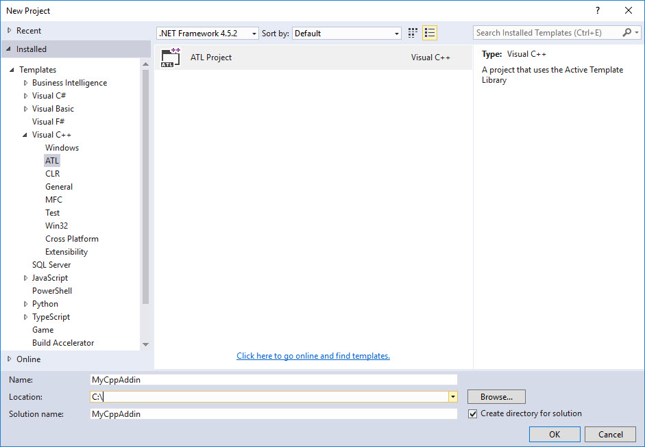

Create C++ project with Visual Studio
  • Open Visual Studio
  • File -> New -> Project
  • Select Visual C++ -> ATL
Click OK.

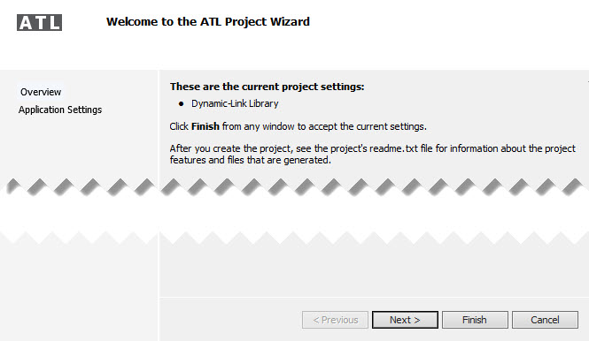

Click Next.

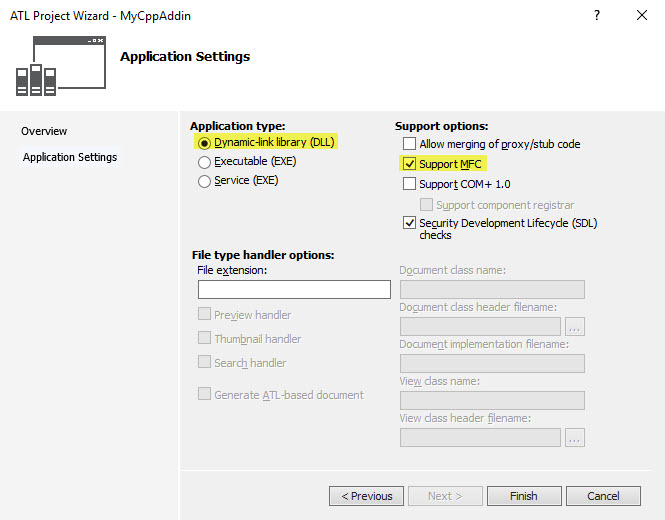

Select Dynamic-link library Type (DLL).
Check Support MFC.
Click Finish.
