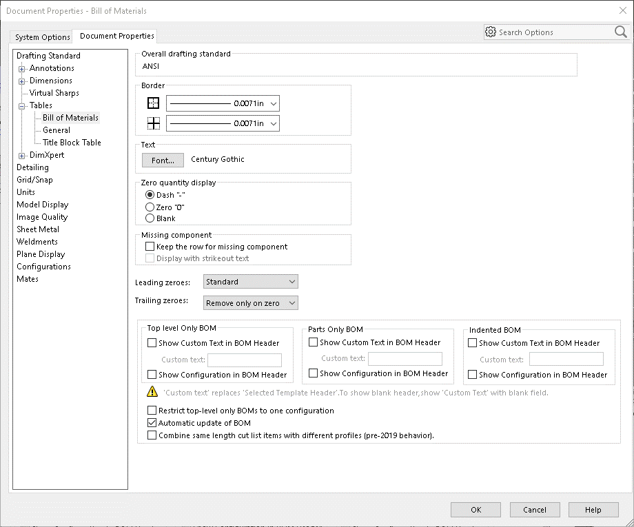

This topic contains two tables. The information in the table:
  • appearing immediately after the screen capture of the dialog corresponds to the settings on that dialog.
  • titled Obsolete Enumerators contains enumerators that previously appeared on the dialog but are now obsolete.

Border - Box Border
IModelDocExtension::GetUserPreferenceInteger(swUserPreferenceIntegerValue_e.swDetailingBillOfMaterialBorderLineWeight, swUserPreferenceOption_e.swDetailingNoOptionSpecified)
IModelDocExtension::SetUserPreferenceInteger(swUserPreferenceIntegerValue_e.swDetailingBillOfMaterialBorderLineWeight, swUserPreferenceOption_e.swDetailingNoOptionSpecified, swLineWeights_e.<Value>)
See swLineWeights_e for valid options
Border - Grid Border
IModelDocExtension::GetUserPreferenceInteger(swUserPreferenceIntegerValue_e.swDetailingBillOfMaterialGridLineWeight, swUserPreferenceOption_e.swDetailingNoOptionSpecified)
IModelDocExtension::SetUserPreferenceInteger(swUserPreferenceIntegerValue_e.swDetailingBillOfMaterialGridLineWeight, swUserPreferenceOption_e.swDetailingNoOptionSpecified, swLineWeights_e.<Value>)
Text - Font...
IModelDocExtension::GetUserPreferenceTextFormat(swUserPreferenceTextFormat_e.swDetailingBillOfMaterialTextFormat, swUserPreferenceOption_e.swDetailingNoOptionSpecified)
IModelDocExtension::SetUserPreferenceTextFormat(swUserPreferenceTextFormat_e.swDetailingBillOfMaterialTextFormat, swUserPreferenceOption_e.swDetailingNoOptionSpecified, <Value>)
See ITextFormat for font options
To set font property values, implement ITextFormat, set the appropriate ITextFormat member values, and pass the ITextFormat object in the API set method
Zero quantity display
IModelDocExtension::GetUserPreferenceInteger(swUserPreferenceIntegerValue_e.swBomTableZeroQuantityDisplay, swUserPreferenceOption_e.swDetailingBillOfMaterial)
IModelDocExtension::SetUserPreferenceInteger(swUserPreferenceIntegerValue_e.swBomTableZeroQuantityDisplay, swUserPreferenceOption_e.swDetailingBillOfMaterial, swZeroQuantityDisplay_e.<Value>)
See swZeroQuantityDisplay_e for valid options
Missing component - Keep the row for missing component
IModelDocExtension::GetUserPreferenceToggle(swUserPreferenceToggle_e.swBomTableKeepMissingItems, swUserPreferenceOption_e.swDetailingNoOptionSpecified)
IModelDocExtension::SetUserPreferenceToggle(swUserPreferenceToggle_e.swBomTableKeepMissingItems, swUserPreferenceOption_e.swDetailingNoOptionSpecified, <OnFlag>)
Boolean value
Specifies whether to list missing (deleted) components in BOM
Missing component - Display with strikeout text
IModelDocExtension::GetUserPreferenceToggle(swUserPreferenceToggle_e.swBomTableStrikeThroughMissingItems, swUserPreferenceOption_e.swDetailingNoOptionSpecified)
IModelDocExtension::SetUserPreferenceToggle(swUserPreferenceToggle_e.swBomTableStrikeThroughMissingItems, swUserPreferenceOption_e.swDetailingNoOptionSpecified, <OnFlag>)
Boolean value
Specifies whether to strike through text for missing components
Leading zeroes
IModelDocExtension::GetUserPreferenceInteger(swUserPreferenceIntegerValue_e.swDetailingLeadingZero, swUserPreferenceOption_e.swDetailingBillOfMaterial)
IModelDocExtension::SetUserPreferenceInteger(swUserPreferenceIntegerValue_e.swDetailingLeadingZero, swUserPreferenceOption_e.swDetailingBillOfMaterial, swDetailingLeadingZero_e.<Value>)
See swDetailingLeadingZero_e for valid options
Trailing zeroes
IModelDocExtension::GetUserPreferenceInteger(swUserPreferenceIntegerValue_e.swDetailingDimTrailingZero, swUserPreferenceOption_e.swDetailingBillOfMaterial)
IModelDocExtension::SetUserPreferenceInteger(swUserPreferenceIntegerValue_e.swDetailingDimTrailingZero, swUserPreferenceOption_e.swDetailingBillOfMaterial, swDetailingDimTrailingZero_e.<Value>)
Valid options in swDetailingDimTrailingZero_e:
  • swDimShowTrailingZeroes
  • swDimRemoveTrailingZeroes
  • swDimRemoveOnlyOnZero
  • swDimSameAsSource
Top level Only BOM - Show Custom Text in BOM Header
IModelDocExtension::GetUserPreferenceToggle(swUserPreferenceToggle_e.swBomTableShowCustomTextinBOMHeader_ForTopLevelOnlyBOM, swUserPreferenceOption_e.swDetailingNoOptionSpecified)
IModelDocExtension::SetUserPreferenceToggle(swUserPreferenceToggle_e.swBomTableShowCustomTextinBOMHeader_ForTopLevelOnlyBOM, swUserPreferenceOption_e.swDetailingNoOptionSpecified, <OnFlag>)
Boolean value
Top level Only BOM - Custom text:
IModelDocExtension::GetUserPreferenceString(swUserPreferenceStringValue_e.swBomTableBOMHeaderCustomText_ForTopLevelOnlyBOM, swUserPreferenceOption_e.swDetailingBillOfMaterial)
IModelDocExtension::SetUserPreferenceString(swUserPreferenceStringValue_e.swBomTableBOMHeaderCustomText_ForTopLevelOnlyBOM, swUserPreferenceOption_e.swDetailingBillOfMaterial, <Value>)
String value
Valid only if swBomTableShowCustomTextinBOMHeader_ForTopLevelOnlyBOM is set to true
Top level Only BOM - Show Configuration in BOM Header
IModelDocExtension::GetUserPreferenceToggle(swUserPreferenceToggle_e.swBomTableShowConfigurationInBOMHeader_ForTopLevelOnlyBOM, swUserPreferenceOption_e.swDetailingNoOptionSpecified)
IModelDocExtension::SetUserPreferenceToggle(swUserPreferenceToggle_e.swBomTableShowConfigurationInBOMHeader_ForTopLevelOnlyBOM, swUserPreferenceOption_e.swDetailingNoOptionSpecified, <OnFlag>)
Boolean value
Parts Only BOM - Show Custom Text in BOM Header
IModelDocExtension::GetUserPreferenceToggle(swUserPreferenceToggle_e.swBomTableShowCustomTextinBOMHeader_ForPartOnlyBOM, swUserPreferenceOption_e.swDetailingNoOptionSpecified)
IModelDocExtension::SetUserPreferenceToggle(swUserPreferenceToggle_e.swBomTableShowCustomTextinBOMHeader_ForPartOnlyBOM, swUserPreferenceOption_e.swDetailingNoOptionSpecified, <OnFlag>)
Boolean value
Parts Only BOM - Custom text:
IModelDocExtension::GetUserPreferenceString(swUserPreferenceStringValue_e.swBomTableBOMHeaderCustomText_ForPartOnlyBOM, swUserPreferenceOption_e.swDetailingBillOfMaterial)
IModelDocExtension::SetUserPreferenceString(swUserPreferenceStringValue_e.swBomTableBOMHeaderCustomText_ForPartOnlyBOM, swUserPreferenceOption_e.swDetailingBillOfMaterial, <Value>)
String value
Valid only if swBomTableShowCustomTextinBOMHeader_ForPartOnlyBOM is set to true
Parts Only BOM - Show Configuration in BOM Header
IModelDocExtension::GetUserPreferenceToggle(swUserPreferenceToggle_e.swBomTableShowConfigurationInBOMHeader_ForPartOnlyBOM, swUserPreferenceOption_e.swDetailingNoOptionSpecified)
IModelDocExtension::SetUserPreferenceToggle(swUserPreferenceToggle_e.swBomTableShowConfigurationInBOMHeader_ForPartOnlyBOM, swUserPreferenceOption_e.swDetailingNoOptionSpecified, <OnFlag>)
Boolean value
Indented BOM - Show Custom Text in BOM Header
IModelDocExtension::GetUserPreferenceToggle(swUserPreferenceToggle_e.swBomTableShowCustomTextinBOMHeader_ForIndentedBOM, swUserPreferenceOption_e.swDetailingNoOptionSpecified)
IModelDocExtension::SetUserPreferenceToggle(swUserPreferenceToggle_e.swBomTableShowCustomTextinBOMHeader_ForIndentedBOM, swUserPreferenceOption_e.swDetailingNoOptionSpecified, <OnFlag>)
Boolean value
Indented BOM - Custom text:
IModelDocExtension::GetUserPreferenceString(swUserPreferenceStringValue_e.swBomTableBOMHeaderCustomText_ForIndentedBOM, swUserPreferenceOption_e.swDetailingBillOfMaterial)
IModelDocExtension::SetUserPreferenceString(swUserPreferenceStringValue_e.swBomTableBOMHeaderCustomText_ForIndentedBOM, swUserPreferenceOption_e.swDetailingBillOfMaterial, <Value>)
String value
Valid only if swBomTableShowCustomTextinBOMHeader_ForIndentedBOM is set to true
Indented BOM - Show Configuration in BOM Header
IModelDocExtension::GetUserPreferenceToggle(swUserPreferenceToggle_e.swBomTableShowConfigurationInBOMHeader_ForIndentedBOM, swUserPreferenceOption_e.swDetailingNoOptionSpecified)
IModelDocExtension::SetUserPreferenceToggle(swUserPreferenceToggle_e.swBomTableShowConfigurationInBOMHeader_ForIndentedBOM, swUserPreferenceOption_e.swDetailingNoOptionSpecified, <OnFlag>)
Boolean value
Restrict top-level only BOMs to one configuration
IModelDocExtension::GetUserPreferenceToggle(swUserPreferenceToggle_e.swOneConfigOnlyTopLevelBom, swUserPreferenceOption_e.swDetailingNoOptionSpecified)
IModelDocExtension::SetUserPreferenceToggle(swUserPreferenceToggle_e.swOneConfigOnlyTopLevelBom, swUserPreferenceOption_e.swDetailingNoOptionSpecified, <OnFlag>)
Boolean value
Specifies whether to limit BOMs designated as top-level only to one configuration
Automatic update of BOM
IModelDocExtension::GetUserPreferenceToggle(swUserPreferenceToggle_e.swDetailingAutoUpdateBOM, swUserPreferenceOption_e.swDetailingNoOptionSpecified)
IModelDocExtension::SetUserPreferenceToggle(swUserPreferenceToggle_e.swDetailingAutoUpdateBOM, swUserPreferenceOption_e.swDetailingNoOptionSpecified, <OnFlag>)
Boolean value
Specifies whether to automatically update BOM when changes are made to model

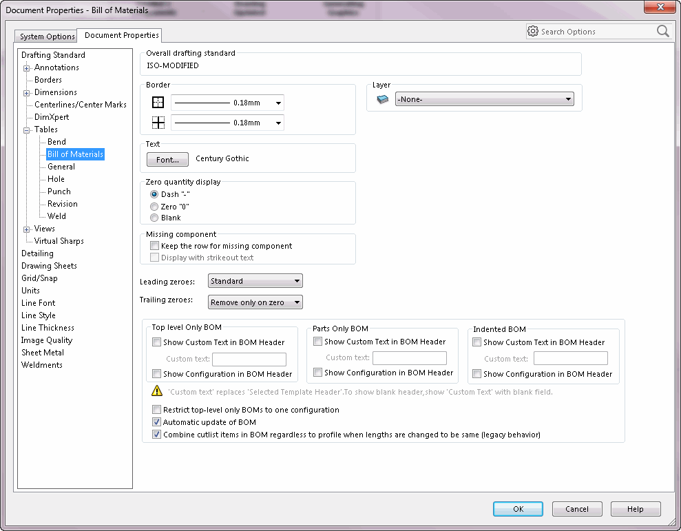

Combine cutlist items in BOM regardless to profile when lengths are changed to be same (legacy behavior)
IModelDocExtension::GetUserPreferenceToggle(swUserPreferenceToggle_e.swCombineCutlistItemsInBOM, swUserPreferenceOption_e.swDetailingNoOptionSpecified)
IModelDocExtension::SetUserPreferenceToggle(swUserPreferenceToggle_e.swCombineCutlistItemsInBOM, swUserPreferenceOption_e.swDetailingNoOptionSpecified, <OnFlag>)
Boolean value
Layer
IModelDocExtension::GetUserPreferenceString(swUserPreferenceStringValue_e.swDetailingLayer, swUserPreferenceOption_e.swDetailingBillOfMaterial)
IModelDocExtension::SetUserPreferenceString(swUserPreferenceStringValue_e.swDetailingLayer, swUserPreferenceOption_e.swDetailingBillOfMaterial, <Value>)
Valid options:
  • "Border"
  • "Dimensions"
  • "Notes"
  • "BOM"
  • "FORMAT"
  • "None"
This setting is available only on drawings; depending on drawing, some options may not apply
Enumerator
Comment
swBomTableDontAddQTYNextToConfigName
Obsolete
swDontCopyQTYColumnNameFromTemplate
Obsolete
