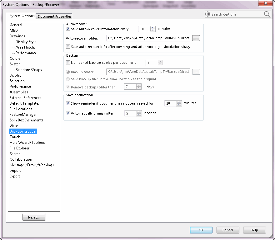

System Options > Backup/Recover
Setting
Get/Set Methods
Return value
or
<Value>
or
<OnFlag>
Comment
Auto-recover - Save auto-recover info every
ISldWorks::GetUserPreferenceToggle(swUserPreferenceToggle_e.swAutoSaveEnable) ISldWorks::SetUserPreferenceToggle(swUserPreferenceToggle_e.swAutoSaveEnable, <OnFlag>)
Boolean value
Specifies whether auto-recovery is enabled
Auto-recover - Save auto-recover info every - <n>
ISldWorks::GetUserPreferenceIntegerValue(swUserPreferenceIntegerValue_e.swAutoSaveInterval) ISldWorks::SetUserPreferenceIntegerValue(swUserPreferenceIntegerValue_e.swAutoSaveInterval, <Value>)
Integer value:
  • 0 = Turn off auto-recovery
  • non-0 = number of operations between auto-recoveries, up to 120
Auto-recover - Save auto-recover info every - <units>
ISldWorks::GetUserPreferenceIntegerValue(swUserPreferenceIntegerValue_e.swAutoSaveIntervalMode) ISldWorks::SetUserPreferenceIntegerValue(swUserPreferenceIntegerValue_e.swAutoSaveIntervalMode, swAutoSaveIntervalMode_e.<Value>)
See swAutoSaveIntervalMode_e for valid options
Specifies auto-recover mode
Auto-recover - Auto-recover folder
ISldWorks::GetUserPreferenceStringValue(swUserPreferenceStringValue_e.swAutoSaveDirectory)
ISldWorks::SetUserPreferenceStringValue(swUserPreferenceStringValue_e.swAutoSaveDirectory, <Value>)
String value
Auto-recover - Save auto-recover info after meshing and after running a simulation study
ISldWorks::GetUserPreferenceToggle(swUserPreferenceToggle_e.swBackupAfterMeshOrRunSimulationStudy) ISldWorks::SetUserPreferenceToggle(swUserPreferenceToggle_e.swBackupAfterMeshOrRunSimulationStudy, <OnFlag>)
Boolean value
Backup - Number of backup copies per document
ISldWorks::GetUserPreferenceToggle(swUserPreferenceToggle_e.swBackupEnable) ISldWorks::SetUserPreferenceToggle(swUserPreferenceToggle_e.swBackupEnable, <OnFlag>)
Boolean value
Specifies whether backup copies of the document are created before any changes to the document are made
Backup - Number of backup copies per document - <n>
ISldWorks::GetUserPreferenceIntegerValue(swUserPreferenceIntegerValue_e.swBackupCopiesPerDocument)
ISldWorks::SetUserPreferIntegerStringValue_e.swBackupCopiesPerDocument, <Value>)
Integer value: 1 - 10
Specifies number of backup copies per document
Backup - Backup folder
Backup - Save backup files in the same location as the original
ISldWorks::GetUserPreferenceToggle(swUserPreferenceToggle_e.swSaveBackupFilesInSameLocationAsOriginal) ISldWorks::SetUserPreferenceToggle(swUserPreferenceToggle_e.swSaveBackupFilesInSameLocationAsOriginal, <OnFlag>)
Boolean value:
  • True: Specifies to save backup files in same location as original file
  • False: Specifies to save backup files in the folder specified in Backup folder
Backup - Backup folder - <folder>
ISldWorks::GetUserPreferenceStringValue(swUserPreferenceStringValue_e.swBackupDirectory)
ISldWorks::SetUserPreferenceStringValue(swUserPreferenceStringValue_e.swBackupDirectory, <Value>)
String value
Specifies the  folder where to save backup files
Backup - Remove backups older
ISldWorks::GetUserPreferenceToggle(swUserPreferenceToggle_e.swBackupRemoveEnable) ISldWorks::SetUserPreferenceToggle(swUserPreferenceToggle_e.swBackupRemoveEnable, <OnFlag>)
Boolean value
Specifies whether  backup documents older than the specified days are removed when you start up SOLIDWORKS
Backup - Remove backups older than <n> days
ISldWorks::GetUserPreferenceIntegerValue(swUserPreferenceIntegerValue_e.swBackupRemoveInterval)
ISldWorks::SetUserPreferenceIntegerValue(swUserPreferenceIntegerValue_e.swBackupRemoveInterval, <Value>)
Integer value: 1 - 30
Specifies the number of days when to remove backup copies of a document
Save notification - Show reminder if document has not been saved for
ISldWorks::GetUserPreferenceToggle(swUserPreferenceToggle_e.swSaveReminderEnable) ISldWorks::SetUserPreferenceToggle(swUserPreferenceToggle_e.swSaveReminderEnable, <OnFlag>)
Boolean value
Specifies whether to display a reminder if document has not been saved
Save notification - Show reminder if document has not been saved for - <n>
ISldWorks::GetUserPreferenceIntegerValue(swUserPreferenceIntegerValue_e.swSaveReminderInterval) ISldWorks::SetUserPreferenceIntegerValue(swUserPreferenceIntegerValue_e.swSaveReminderInterval, <Value>)
Integer value: 1 - 60
Specifies how long to wait before sending a save notification reminder
Save notification - Show reminder if document has not been saved for - <units>
ISldWorks::GetUserPreferenceIntegerValue(swUserPreferenceIntegerValue_e.swSaveReminderIntervalMode) ISldWorks::SetUserPreferenceIntegerValue(swUserPreferenceIntegerValue_e.swSaveReminderIntervalMode, swSaveReminderIntervalMode_e.<Value>)
See swSaveReminderIntervalMode_e for valid options
Specifies the units of Save notification - Show reminder if document has not been saved for - <n>
Save notification - Automatically dismiss after
ISldWorks::GetUserPreferenceToggle(swUserPreferenceToggle_e.swSaveReminderAutoDismissEnable) ISldWorks::SetUserPreferenceToggle(swUserPreferenceToggle_e.swSaveReminderAutoDismissEnable, <OnFlag>)
Boolean value
Specifies whether to automatically dismiss the save notification reminder; valid only if Save notification - Show reminder if document has not been saved for is true
Save notification - Automatically dismiss after - <n> seconds
ISldWorks::GetUserPreferenceIntegerValue(swUserPreferenceIntegerValue_e.swSaveReminderAutoDismissInterval) ISldWorks::SetUserPreferenceIntegerValue(swUserPreferenceIntegerValue_e.swSaveReminderAutoDismissInterval, <Value>)
Integer value: 1 - 999
Specifies the number of seconds to wait before dismissing the save notification reminder
