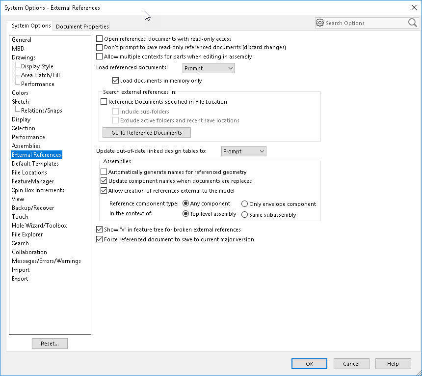

This topic contains two tables. The information in the table:
Setting |
Get/Set Methods |
Return Value
or
<Value>
or
<OnFlag> |
Comment |
Open referenced documents with read-only access |
ISldWorks::GetUserPreferenceToggle(swUserPreferenceToggle_e.swExtRefOpenReadOnly)
ISldWorks::SetUserPreferenceToggle(swUserPreferenceToggle_e.swExtRefOpenReadOnly,
<OnFlag>) |
Boolean value |
Specifies whether to open referenced documents as read-only |
Don't prompt to save read-only referenced documents (discard changes) |
ISldWorks::GetUserPreferenceToggle(swUserPreferenceToggle_e.swExtRefNoPromptOrSave)
ISldWorks::SetUserPreferenceToggle(swUserPreferenceToggle_e.swExtRefNoPromptOrSave, <OnFlag>) |
Boolean value |
Specifies whether to close read-only reference documents without prompting
or attempting to save changes made to them when saving or closing the
parent document |
Allow multiple contexts for parts when editing in assembly |
ISldWorks::GetUserPreferenceToggle(swUserPreferenceToggle_e.swExtRefMultipleContexts)
ISldWorks::SetUserPreferenceToggle(swUserPreferenceToggle_e.swExtRefMultipleContexts, <OnFlag>) |
Boolean value |
Specifies whether to create external references to a single part from
more than one assembly context |
Load referenced documents |
ISldWorks::GetUserPreferenceIntegerValue(swUserPreferenceIntegerValue_e.swLoadExternalReferences)
ISldWorks::SetUserPreferenceIntegerValue(swUserPreferenceIntegerValue_e.swLoadExternalReferences, swLoadExternalReferences_e.<Value>)
See swLoadExternalReferences_e
for valid options |
Note: If this setting is
swLoadExternalReferences_e.swLoadExternalReferences_None, then
IDocumentSpecification::LoadExternalReferencesInMemory is not observed |
Load documents in memory only |
ISldWorks::GetUserPreferenceToggle(swUserPreferenceToggle_e.swExtRefLoadRefDocsInMemory)
ISldWorks::SetUserPreferenceToggle(swUserPreferenceToggle_e.swExtRefLoadRefDocsInMemory, <OnFlag>) |
Boolean value |
Specifies whether to load reference documents in memory only This setting
(whether in the user interface or through the API) is ignored when opening
documents through the API because
IDocumentSpecification::LoadExternalReferencesInMemory and
ISldWorks::OpenDoc6
(swOpenDocOptions_e.swOpenDocOptions_LoadExternalReferencesInMemory)
have sole control over reference loading |
Search external references in - Reference Documents specified in File
Location |
ISldWorks::GetUserPreferenceToggle(swUserPreferenceToggle_e.swUseFolderSearchRules)
ISldWorks::SetUserPreferenceToggle(swUserPreferenceToggle_e.swUseFolderSearchRules, <OnFlag>) |
Boolean value
Specifies whether to search the Referenced
Documents list of folders in the File Locations Options dialog |
Location - Include sub-folders |
ISldWorks::GetUserPreferenceToggle(swUserPreferenceToggle_e.swExtRefIncludeSubFolders)
ISldWorks::SetUserPreferenceToggle(swUserPreferenceToggle_e.swExtRefIncludeSubFolders, <OnFlag>) |
Boolean value |
Specifies whether to search for reference documents in sub-folders in the
specified file location; valid only if Reference Documents specified in
File Location is true |
Location - Exclude active folders and recent save locations |
ISldWorks::GetUserPreferenceToggle(swUserPreferenceToggle_e.swExtRefExcludeActiveFoldersAndRecentSaveLocations)
ISldWorks::SetUserPreferenceToggle(swUserPreferenceToggle_e.swExtRefExcludeActiveFoldersAndRecentSaveLocations, <OnFlag>) |
Boolean value |
Specifies whether to block searching for reference documents in open folders
and folders containing recently saved items; valid only if Reference Documents specified in
Update out-of-date linked design tables to |
ISldWorks::GetUserPreferenceIntegerValue(swUserPreferenceIntegerValue_e.swExternalReferencesUpdateOutOfDateLinkedDesignTable)
ISldWorks::SetUserPreferenceIntegerValue(swUserPreferenceIntegerValue_e.swExternalReferencesUpdateOutOfDateLinkedDesignTable, swExternalReferencesUpdateOutOfDateLinkedDesignTable_e.<Value>) |
See swExternalReferencesUpdateOutOfDateLinkedDesignTable_e
for valid options |
Assemblies - Automatically generate names for referenced geometry |
ISldWorks::GetUserPreferenceToggle(swUserPreferenceToggle_e.swExtRefAutoGenNames)
ISldWorks::SetUserPreferenceToggle(swUserPreferenceToggle_e.swExtRefAutoGenNames, <OnFlag>) |
Boolean value
Specifies whether to automatically generate names for referenced geometry |
Assemblies - Update component names when documents are replaced |
ISldWorks::GetUserPreferenceToggle(swUserPreferenceToggle_e.swExtRefUpdateCompNames)
ISldWorks::SetUserPreferenceToggle(swUserPreferenceToggle_e.swExtRefUpdateCompNames, <OnFlag>) |
Boolean value
Specifies whether to mate to read-only parts using internal face IDs
of the parts or to replace components using surface identifiers to write-access
parts |
Assemblies - Allow creation of references external to the model |
ISldWorks::GetUserPreferenceToggle(swUserPreferenceToggle_e.swAllowCreationOfReferencesExternalToModel)
ISldWorks::SetUserPreferenceToggle(swUserPreferenceToggle_e.swAllowCreationOfReferencesExternalToModel, <OnFlag>) |
Boolean value
Specifies whether to permit creation of external references when designing in the
context of an assembly |
Assemblies - Allow creation of references external to the model -
Reference component type: |
ISldWorks::GetUserPreferenceToggle(swUserPreferenceToggle_e.swReferenceOnlyEnvelopeComponentType)
ISldWorks::SetUserPreferenceToggle(swUserPreferenceToggle_e.swReferenceOnlyEnvelopeComponentType, <OnFlag>) |
Boolean value
True if only envelope component, false if any component |
Assemblies - Allow creation of references external to the model - In
the context of: |
ISldWorks::GetUserPreferenceToggle(swUserPreferenceToggle_e.swReferenceInContextOfTopLevelAssembly)
ISldWorks::SetUserPreferenceToggle(swUserPreferenceToggle_e.swReferenceInContextOfTopLevelAssembly, <OnFlag>) |
Boolean value
True if in context of top level assembly, false if in context of same
subassembly |
Show "x" in feature tree for broken
external references |
ISldWorks::GetUserPreferenceToggle(swUserPreferenceToggle_e.swExtRefShowXInFeatureTree)
ISldWorks::SetUserPreferenceToggle(swUserPreferenceToggle_e.swExtRefShowXInFeatureTree, <OnFlag>) |
Boolean value |
Specifies whether to hide or show
the x that appears in the FeatureManager design tree to indicate broken
references |
Include subfolders for drawings search in Pack and Go |
ISldWorks::GetUserPreferenceToggle(swUserPreferenceToggle_e.swIncludeSubfoldersForDrawingsSearchInPackAndGo)
ISldWorks::SetUserPreferenceToggle(swUserPreferenceToggle_e.swIncludeSubfoldersForDrawingsSearchInPackAndGo, <OnFlag>) |
Boolean value |
