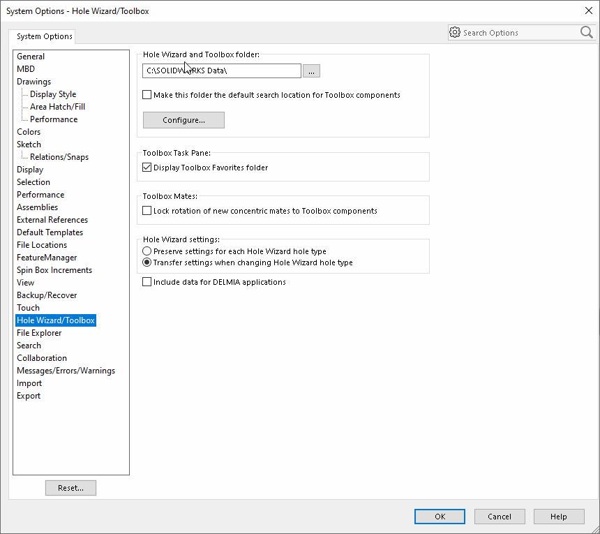

System Options > Hole Wizard/Toolbox
Setting
Get/Set Methods
Return Value
or
<Value>
Comment
Hole Wizard and Toolbox folder
ISldWorks::GetUserPreferenceStringValue(swUserPreferenceStringValue_e.swHoleWizardToolBoxFolder) ISldWorks::SetUserPreferenceStringValue(swUserPreferenceStringValue_e.swHoleWizardToolBoxFolder, <Value>)
String value
Specifies the location of the Hole Wizard/Toolbox folder
Make this folder the default search location for Toolbox components
ISldWorks::GetUserPreferenceToggle(swUserPreferenceToggle_e.swUseFolderAsDefaultSearchLocation)
ISldWorks::SetUserPreferenceToggle(swUserPreferenceToggle_e.swUseFolderAsDefaultSearchLocation, <Value>)
Boolean value
Specifies whether to make the specified Hole Wizard and Toolbox folder the default search location for Toolbox components
Toolbox Task Pane - Display Toolbox Favorites folder
ISldWorks::GetUserPreferenceToggle(swUserPreferenceToggle_e.swShowToolboxFavoritesFolder)
ISldWorks::SetUserPreferenceToggle(swUserPreferenceToggle_e.swShowToolboxFavoritesFolder, <Value>)
Boolean value
Specifies whether to display the Toolbox Favorites folder
Toolbox Mates - Lock rotation of new concentric mates to Toolbox components
ISldWorks::GetUserPreferenceToggle(swUserPreferenceToggle_e.swLockRotationConcentricMates)
ISldWorks::SetUserPreferenceToggle(swUserPreferenceToggle_e.swLockRotationConcentricMates, <Value>)
Boolean value
Hole Wizard settings
ISldWorks::GetUserPreferenceToggle(swUserPreferenceToggle_e.swTransferHoleWizardSizeComboBoxSettings)
ISldWorks::SetUserPreferenceToggle(swUserPreferenceToggle_e.swTransferHoleWizardSizeComboBoxSettings, <Value>)
Boolean value
True to preserve settings for each Hole Wizard hole type, false to transfer settings when changing Hole Wizard hole type
Include data for DELMIA applications
ISldWorks::GetUserPreferenceToggle(swUserPreferenceToggle_e.swIncludeDataForDelmia)
ISldWorks::SetUserPreferenceToggle(swUserPreferenceToggle_e.swIncludeDataForDelmia, <Value>)
Boolean value
True to write threaded hole pitch values to the DB stream for DELMIA during saves, false to not
