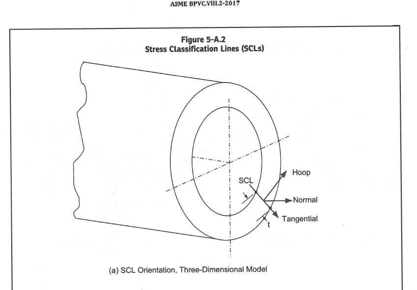

This method adheres to current ASME Pressure Vessel design codes (ASME BPVC Section VIII, Annex 5-A.4.1.2) for deriving the membrane, bending, and peak components of a stress distribution based on a local coordinate system that is defined by the orientation of Stress Classification Lines (SCL). In the SCL coordinate system, SCL axis (Tangential) is the x direction, the axis perpendicular to the section plane (Hoop) is the z direction, and the orthogonal axis (Normal) is the y direction.

  5. Select two points in the graphics area that fall on the sectioned plot, prefereably spanning the thickness. (The tangential line goes from the first location to the second. The hoop is the outward normal to the cutting plane. The normal completes the right--handed coordinate system.)
